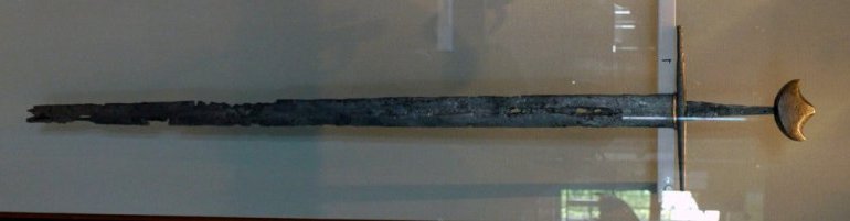

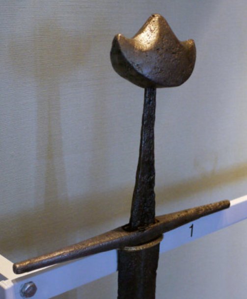

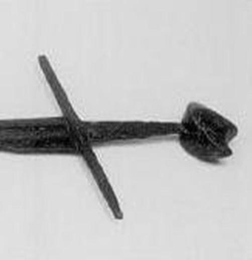

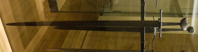

A while back I was looking at this thread devoted to Oakeshott type C/D pommel swords:
http://www.myArmoury.com/talk/viewtopic.php?t=20025
I've wanted a D pommel for my collection for quite some time (indeed I've owned a couple but they did not satisfy). There are a few very nice production pieces out there, but none of them seem to exactly match what one sees in the originals, for one reason or another.
Looking at the above thread one notices a group with very similar characteristics (see examples below): a very similar long thin blade (37-38") of Oakeshott type Xa/XI (Geibig 13), a straight cross (usually type 1, but at least one type 2), a single-hand grip, and a nearly identical type D pommel. These swords seem quite clearly to be built for use from the back of a horse - long reach, but likely awkward in close quarters. Moreover, they share so many common characteristics that one is tempted to say, to paraphrase Oakeshott, 'they were made in the same workshop, if not by the same hands'.
This notion gave rise to a concept for a custom piece.
I took this notion to Craig Johnson at A&A and asked him to make me one of these swords, as if it were the next one to roll out of this 13th century 'assembly line' , choosing some of the features from the known examples that I prefer. In particular, I chose the slighlty unusual rounded type 1 spikehilt cross from one of the examples shown below, wanted the pommel to have the slightly scaloped bottom missing from most modern replicas, and of course the full length blade.
This project has now come together and over the next days we'll see the results.
By the way, there is talk of turning this into an A&A production piece, so I'm sure Craig will be interested to see what people have to say about it.

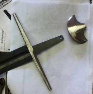

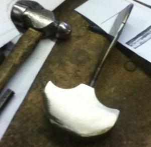

Hey Holmes! I hear that you have one in the same batch, what's going on with that? Craig says mine is done, so maybe yours is too. He is just waiting for an opportunity to take some good pictures so it should be soon.

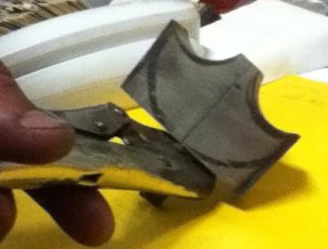

In the mean time, here are some early development shots of the pommel and cross. Craig did not have access to a good camera for these pictures, so he is not proud of them, but I think it's worth documenting here for posterity.

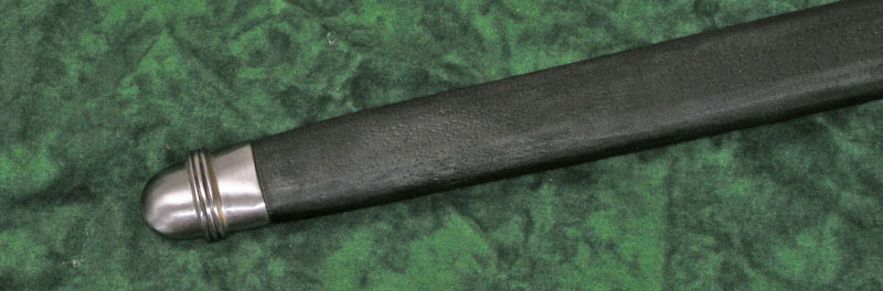

Speaking of A&A scabbards, here is a good one that they made to go along with a custom 17th century sword they created for me. It doesn't have a lot of extra stuff on it, but is very nice.
A&A is making a custom sword for me too. I hope to get it by the end of this summer.

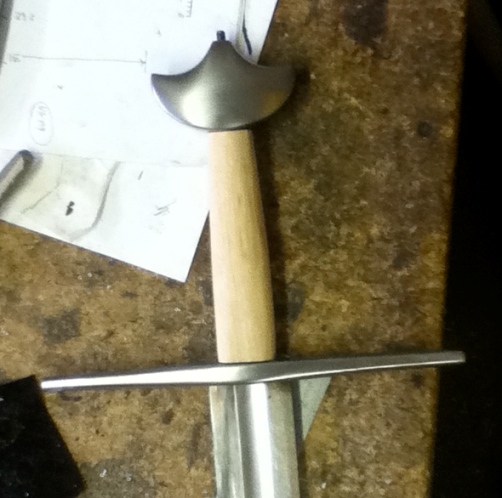

I'm glad to see that people find this project interesting. Here's a couple more later development shots, including the final one before the hilt furniture was peened onto the actual blade (the blade / tang parts shown above are just dummy pieces).
Hopefully shots of the final product will be available early this week.

Really liking the look of it. Did Craig send any full length shots?

Not yet Tim, that's everything I've got. By agreement its from the same stock as their St. Maurice (and your Anglosaxon long sword) but with some modifications. Looking forward to see how that came out.

This is a really exciting project. I love, well, each element of the hilt- pommel, grip length, and guard. I love the look of the fuller as well- a bit narrow which I like to see.
