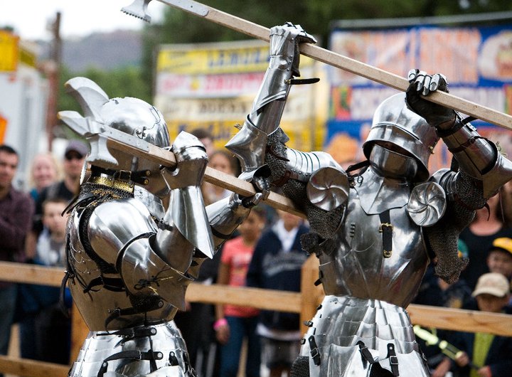

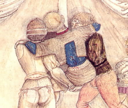

So I've been researching various forms of how mail was used with plate armour and I came across this image. I had originally thought of doing voiders, but it would be a big hassle to undo them and such every time I wanted to clean them :/ Plus I've seen many jousters use them and they keep "popping" out towards the bottom where the ribs are. So...I've documented this to be done in the mid 15th century and I saw that the mail looks to be loose at the bottom. Maybe it gets "tucked" into the body once you add the cuirass?
Do you think this will be a good alternative to voiders?

Here is what I was talking about the voiders "popping" out

Look at the pic of the reenactor who is having the "wardrobe malfunction". The armpits of his mail are about a hand's breadth from his body. The mail can't help but pop out as soon as he lifts his arms.
The important things are that the mail must have a reasonable armpit construction, and that some means must keep it close to the body.
The voiders on
the 15th C fellow in the first pic appear to go on like a short vest. Provided that it is tailored well, it looks like a very convenient solution.
Mac

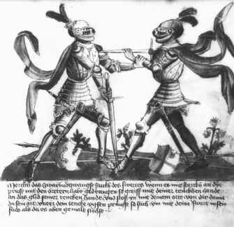

I imagine once the cuirass is attached the mail has little room to move around, but I'm curious once someone would thrust in the armpit and couch it like you see in the fight manuals, if it would then shift itself upward and "slip" out
Or, would the cuirass having shaped correctly with the torso prevent any sort of "slipping"? I imagine I won't know until I try it out.
Mac, do you know of anyone that has tried out this short vest style of mail?
-Reece
Attachment: 16.73 KB
Here is an Image from the Gladitoria fight manual.

Think the modern guys fighting is Tournament of the Phoenix by the looks of the Hedgecock pollaxes. Cant identify the fighters though. Poss Arne Koets, maybe Toby? No idea what they were wearing, thought Dr Capwell was in a great bascinet....
Anyway, voiders simply need to be long enough and sewn /pointed on to stop that happening.
IMHO that is...
But Robert's suggestion re the vest is a good one. You could adapt a shirt easily for this and use it a bit like a padded arming partlet as suggested by various late 16th cent sources. That's a v nice picture, is he just back from a heavy bit of armoured work, or back from a serious drinking session?

Reece, can you give the ms source for the picture with the guy being carried? Thanks.

The one on the left is Toby I think. Also for info, the first image is what Toby now has. Somewhere I have a photo as I supplied the maille to him
It's certainly a good idea, kind of like a waistcoat. So essentially sleeves with side for waist and then a strip over the shoulder blades.
If I can find the photo of Toby I will post it.

My source for that image from from this thread here. http://www.myArmoury.com/talk/viewtopic.php?t=21451m
And yes, the image is from the tournament of the phoenix. The guy on the right is Arne Koets and the guy on the left is Toby Capwell.

Ha! This is kinda funny, because in that picture, where I am fighting Arne, I am actually wearing a set of mail sleeves joined at the back like your first manuscript detail. Actually I made them after that very image. Works very well. Actually that one I'm wearing was made for Per Lillelund Jensen... I just sorta took it for a test-drive.... I'm in the process of making another one for myself.

2 other things from the top pic. 1. He's bleeding where the mail isn't. A salutory lesson to us all.... :-) and 2. Whats going on with the waistline of the guy on the left? Some kind of split belt? Can't be a gore in the garment just there...

| Mark Griffin wrote: | | Whats going on with the waistline of the guy on the left? Some kind of split belt? Can't be a gore in the garment just there... |
Mark,
It has been a number of years since I saw a couple of other illustrations from that manuscript, but if my memory serves me, that's a crossbow spanning belt.
Mac

Mart Shearer
Posted: Fri 03 May, 2013 12:29 pm Post subject: |
Here's the Vatican Bibliographic Reference:
| Quote: | Tamino ID: 95317
Shelfmark Ott.lat.1417,f.20r
Author Baldini, Nicoletta
Title Giovanni di ser Niccolò de' Castaldi da Fano, attribuito, Agesilao ferito trasportato in una tenda, in Giustino,
Epitoma historicarum Philippicarum Pompei Trogi.
In Piero della Francesca e le corti italiane [catalogo di mostra, Arezzo, Museo Statale d'Arte Medievale e
Moderna, 31 marzo-22 luglio 2007, a cura di Carlo Bertelli, Antonio Paolucci]
Place of publication Mialno :
Publisher Skira,
Date of publication c2007.
Note/Volume p. 219-220 e con ill. (p. 168). |

Posted: Wed 08 May, 2013 4:14 am Post subject: |
Here's another shot from the same tournament as the one we started out with in this discussion... you can see the sleeves I was wearing a bit better. You can also see how they didn't work so well with my armour- the bottom edge can be seen sneaking out of the cuirass. The Mk. 3s will have more coverage down there...
