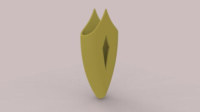

things like this would be good candidates for 3d printing, due to size and the ability to print in wax. Just press print, then break out the crucible and blowtorch. a few hours later, your brand new brass chape is ready or mounting on a scabbard.
 Attachment: 21.23 KB
Christopher B Lellis
Location: Houston, Texas
Joined: 01 Dec 2012
Posts: 268
PostPosted: Mon 03 Jun, 2013 12:54 am    Post subject:         Reply with quote
Yeah, exactly.
That's the kind of stuff I'm talking about.

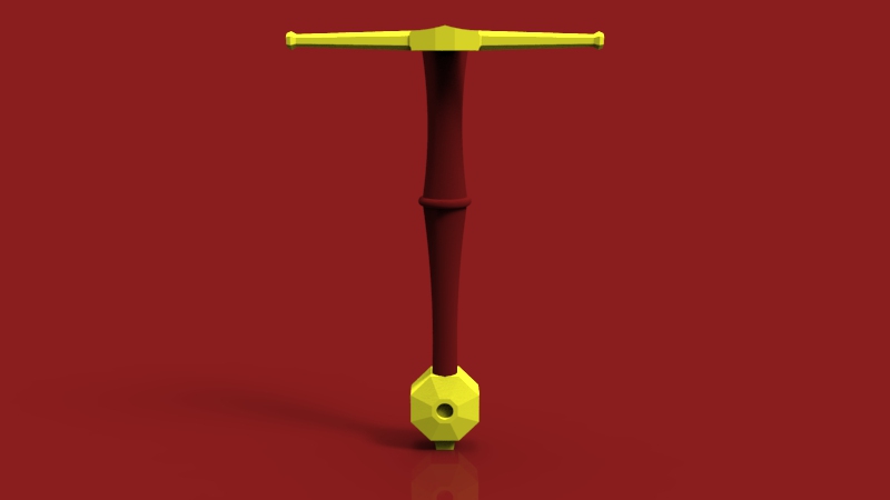

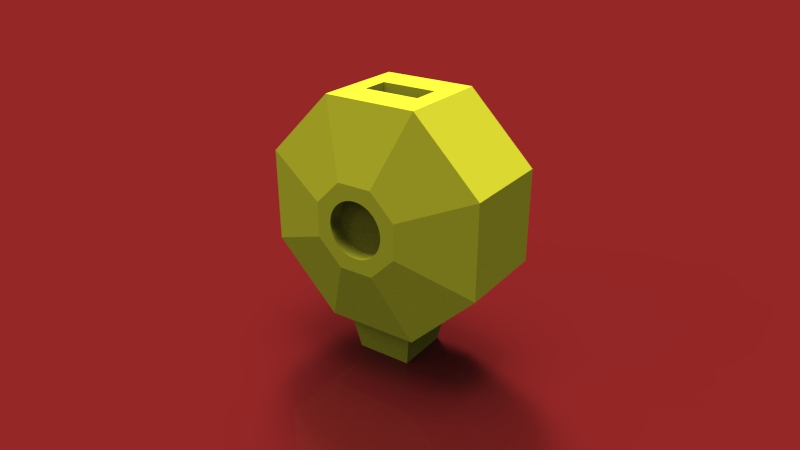

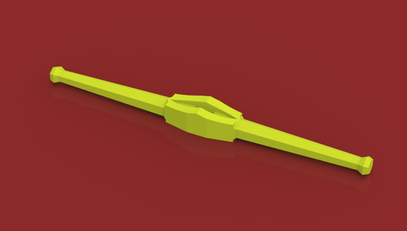

Crossguards and pommels are also a possibility when using 3D printing to produce latten castings
just a little something I worked on this afternoon; a basic early "gothic" crossguard and pommel set
 Attachment: 38.06 KB
 Attachment: 36.08 KB

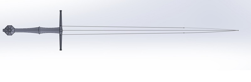

damn guys... you got my design bug reignited. So.... who has a 3D printer?
This sword looks like the bastard child of an Albion Regent (the sword I've lusted after forever- inspiration for the blade i'm envisioning and some of the lines of the guard) an Albion Munich (which i got the pleasure of test cutting with a few months back- responsible for the svelte look of the hilt), and a discontinued Darksword Von Eglofstein War Sword (A sword I briefly owned with a design that really appeals to me, but was paired with the build "quality" we know and "love" from our friends at darksword- responsible for the pommel and the crossguard).
 Attachment: 24.61 KB
furniture on quickly drawn up hilt
 Attachment: 18.69 KB
CAD sketch of the blade overlayed on the hilt
XVIIIb blade
