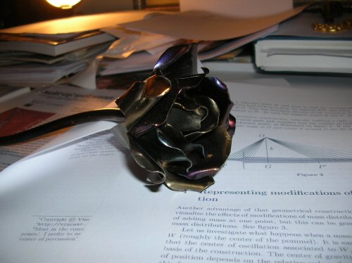

PostPosted: Sat 15 Jun, 2013 7:05 am    Post subject:         Reply with quote
- to temper to a straw yellow, this would be a very low temper. normally you think of tempering iron/steel to blue to achieve the correct reduction in hardness. in Jim Hirsoulas's first book, he describes to bring steel to a straw yellow temper 3 times to give a sword a 'spring' like temper. but he also points out that this is depending on the alloy used as others Heat Treat at different temperatures for the best results.
I believe his description is made this way so that you reduce the hardness of the metal in a contorted limitation and gradually as it is very easy to over temper especially if your working on a sword that's taken you months to build and you possibly ruin it during the final process. to temper to blue is the norm (again depending on the alloy used) but the blue is at the high end of the color scale, and lasts over a wider range of degrees than the cooler colors.
between the straw colors and purples there's only about 20-50 degrees difference in heat so getting them to be a uniform color is really hard to do, below here i have an example of some of my heat blueing work. a little craft thing i picked up a while back making flowers from sheet metal. you'll see that i have a 'rain bowed' coloring happening to the rose, i got this by heating the steel to straw yellow, pulled the heat away, and the residual heat from the steel actually turned it to all the natural colors you see here. it may be easier to pull off a uniform straw yellow on just a single sheet of steel, but still really tricky.
and just as Dave points out, this finish is very light, you can scratch it off very easily.
