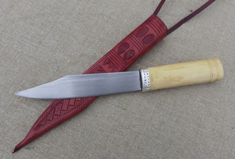

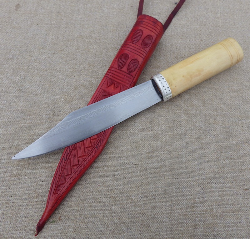

Here is a 12thC eating/utility knife based on pieces from MOL book Knives and Scabbards. By the 12thC pattern welding for swords had stopped, but it was still current for small knives. There is very little evidence for handles and so we went for a plain boxwood handle and as this required a little status, I included a silver ferrule.

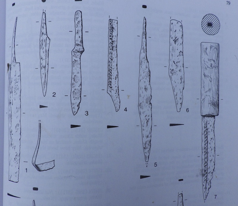

The blade is very much like a broken back seax, but three of the 7 blades shown in the book are of this form this seemed like a good solution.

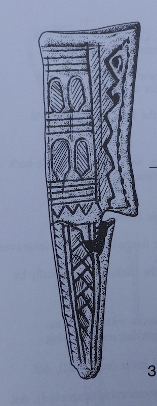

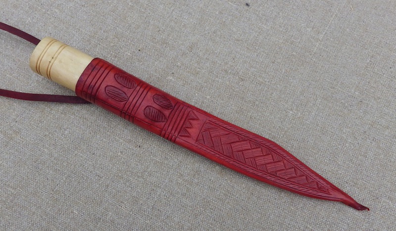

The only scabbard in the book shown as 12thC is in fact corrected in the addenda to 13thC. The decoration is very plausible for 12thC so we decided to make a scabbard without the tab and use this.

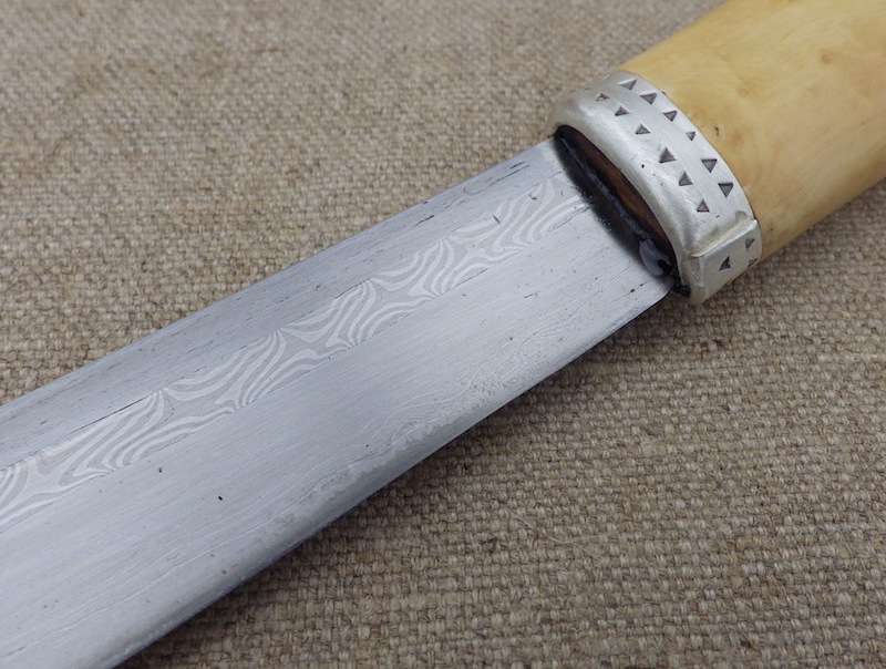

Blade is by Owen Bush and has a twisted core with a wrought iron back and piled shear steel edge.
Throughout the overall aim was historical authenticity and although this knife had to be full of conjecture I think we got there.
I hope you like the result.
Tod

I used the same sheath design for one I made earlier this year to go with blade #7.
Curious why you didn't go with the tabbed sheath form though?

Matthew, I didn't go with the tabbed form because it screams 13th and 14thC and the only reference I have found to it being 12th is in the MOL book, but the addenda at the back then list it with a corrected date of 13th, which I would agree with. So in a nutshell it is not a 12thC scabbard.

Rats - Thanks to Matthew for correcting my mistakes, but it appears that there are a number of Dublin finds from the 12thC and before, that are tabbed. I will of course now go book shopping.
The scabbard needed to be unarguably 12thC and so we went with an untabbed scabbard as that is what seemed safest.

In the book Tod mentioned there are less than a dozen 12th C knives, and no 12th C scabbards. Not a lot of information with which to work - like everything else 12th C.
