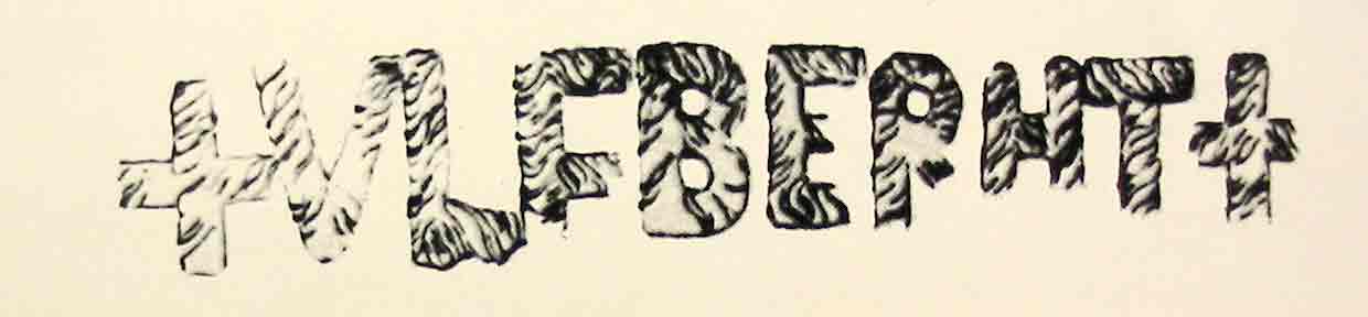

As mr. Johnson mentioned the letters in the Ulfberths (and other swords with blade inscriptions) are formed from thin bars of patternwelded steel, very often of a tight twist pattern. Here are some pics. A drawing from an ulfberth sword and a detail photo of the letters DU from another sword.
Mikko Moilanen has been doing experiments on the letterwelding and his swords look reasonably good, the techniques do work. He does it with bundles of twisted steel and iron wires (maybe not the best option IMO) and welds the letters on one at a time after the fullering. Put the letter on the fuller, sprinkle borax on top, bring up to low weld temp and hit the letter in. Easy as one-two-three Happy
Not much sense on doing forge welding to an already finished sword. Inlaying soft iron wire could be an option for a DIY-project if you're handy with the chisels. Or you could go the easy way and etch the letters: DALO-etch resist marker pens and some ferric-chloride and voila! an Ulfberth-sword! Big Grin
