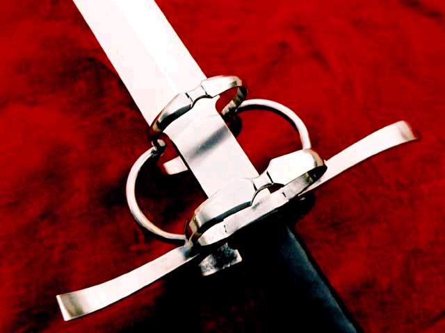

The full-on Cut-and-Thrust hilt treatment that Christian Fletcher offer(ed?) for the longsword are both finger loops arcing over the ricasso and the side rings that protect the hand (and thumb).
I have one picture available at the moment.
 Attachment: 29.32 KB
AT1548 with reitschwert hilt treatment by Christian Fletcher.
PostPosted: Tue 20 Sep, 2005 1:41 pm    Post subject:         Reply with quote
Well, then we're on the same page. As I mention, it's the thumb-ring (not the finger rings nor side rings) that often add leverage to the cut and security to the grip. The Phoenix Metal Creations sword, and all the others I've shown above, has a thumb-ring in addition to the other rings on the compound hilt. As you mention, the other rings are intended to serve as protection, and while I believe the thumb-ring can certainly do this, I don't see it as its purpose, as I wrote above.

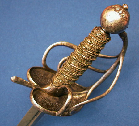

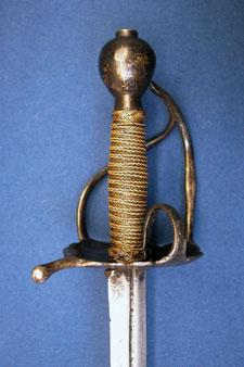

More thumb rings
 Attachment: 43.71 KB
 Attachment: 18.75 KB
