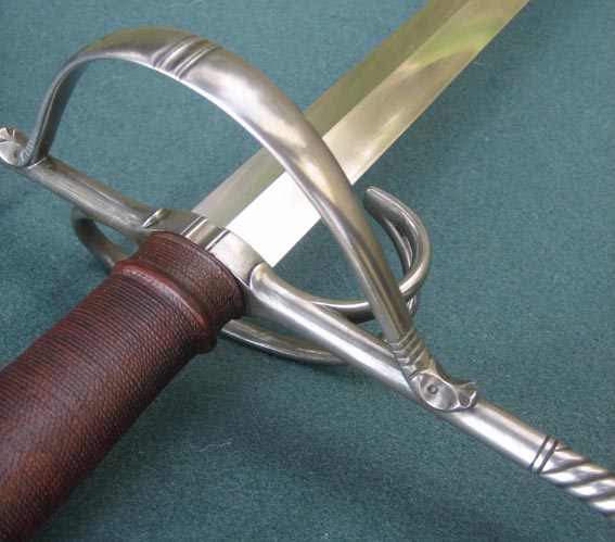

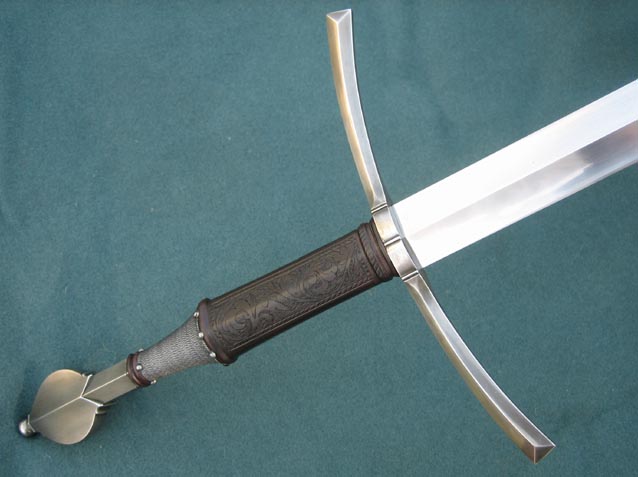

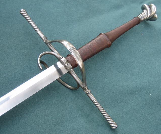

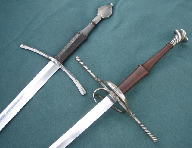

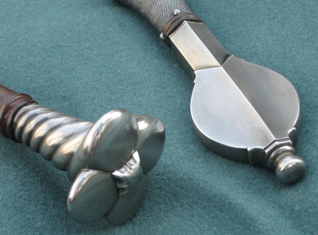

This year I finished three swords for the Knife Maker Show at the Deutsches Klingenmuseum in Solingen:
-a XVIIIC of fairly robust domensions (weight about 1.6 kilos). This type can be agile and very agressive cutters. After having done this, I feel eager to make more wide bladed swords of this size or larger.
-a long slender XVIIIb inspired by a sword in the Landesmuseum in Zürich, but with influences of decorative elements from a longs sword in the Bayerisches Nationalmuseum in Munich. A quick and gracefull type of sword: a type it is always pleasant to return to.
-an Estock of early 16th C type. These blades are very nasty looking and feel quite murderous when in your hand. I really like this style of hilt and enjoy the filework involved. I will explore this further in future projects.
To get an idea of their size, the estock and the XVIIIb have blades of some 95-98 cm in length, while the XVIIIb has a blade width of about 7,5 cm at the guard with a length around 88 cm.
I try to explore somewhat new things in what I bring for the show in Solingen each year. Sometimes it is new types, sometimes variations in styles.
This year I played with filework (the hilt of the estoc) and partially wire wrapped and tooled leather grip (on the XVIIIb).
The XVIIIC sword is a type I long have wanted to do. I feel attracted to types that have strong and sometimes unusua features, such as unusual blade thickness, width or length or hilts with elements and styles that provide some new areas to explore.
It can be small or sublte things, just to keep work interesting. To be able to do work without previous expectations from customers is very liberating and allow me to explore unforseen opportunities as the sword grows closer to completion. This is why I now prefer to work on awailable-now basis, rather than defined custom orders. I see how this tend to result in both better swords *and* happier customers.
I include a series of photos of the three swords.
Hope you enjoy.

I guess the XVIIIb must be very light and fast. The branch pommel and the complex guard are fantastic.
Since you said the sword with the wire-grip is an estoc I'd like to know if it has a sharp edge or is it sharp only at the point?

To avoid any misunderstanding: the estoc is the one with fileworked hilt. The blade is sharpened so that it allowes for blade to blade contact with minimal wear or damage. With a thrusting sword of this type you will expect opposing blades to glance, glide and deflect quite a bit during swordplay. As cutting is not the real forte of this type, you shape the sharpness so that it can do some limited cutting of exposed areas, but it is used really mostly for thrusting. The forte of the blade is completely unsharpened (that is why there is no need for a ricasso to allow fingering the guard). The foible is capable of some cutting of exposed unarmored areas. To be effective as a thruster you still need a good sharpness of the point and point area. Here the edge is shaped as the direct continuation of the hollow grinding. further back towards the forte, the edge is shaped with a rather stout and short apple seed section.
The one with a grip sporting tooled leather and partial wire wrap is an XVIIIa. It is bordering towards favouring thrusting rather than cutting, but is capable of both. It is a fast and pretty light fencing sword.

The estock looks to me like it good be a direct predecessor to a rapier form.
Is that an accurate interpretation?

It's good to see that XVIIIc as there are so few examples around. But my favorite is the XVIIIa with the "U" type pommel. If that sword was belted at my side, I would not be walking, I'd be strutting.
