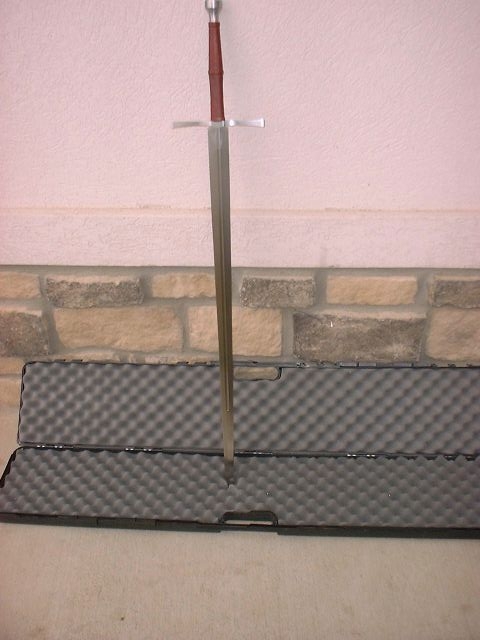

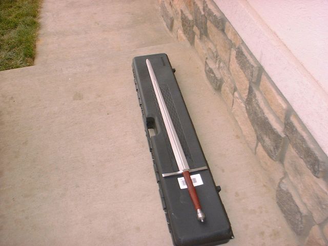

The sword arrived, neatly packed in one of Josh’s trademark rifle cases, with one of the new ecussoned 8” bow ties and a heavy scent stopper ala the 1548. The haft was wrapped in very supple black leather over 3 bands. The grip was very nice and straight, however, within a week the seam had begun to come apart. Gus and crew were very responsive, offering to fix it immediately (a really nice touch considering I hadn’t spent a dime on this baby!). However, since I have a little bit of experience at re-hilting swords, gained courtesy of Erik Stevenson, I unwrapped the grip the rest of the way, and decided to reshape the core and re-wrap it in deep blood-red leather. The picture below shows the finished product.
The new grip really sets off the hefty breadth of the blade at the cross, and adds a distinctive flair to an already superb blade.

 Attachment: 124.68 KB
 Attachment: 46.95 KB
