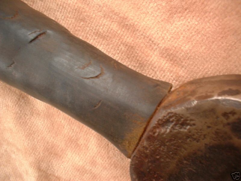

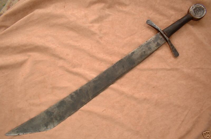

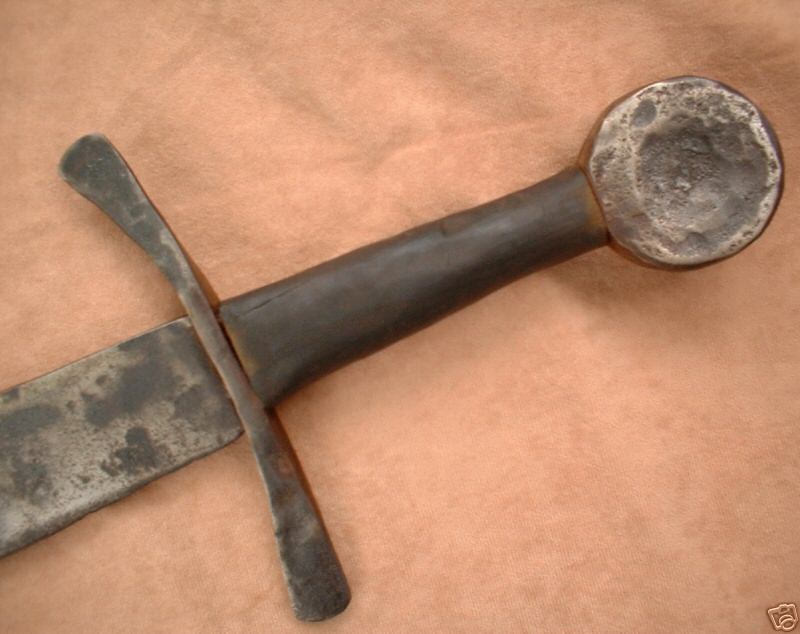

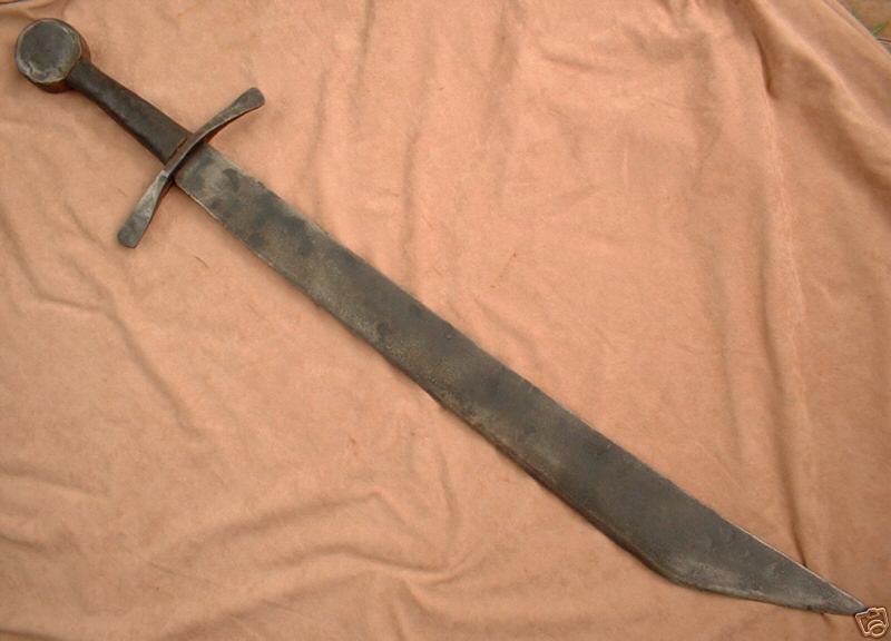

I may have acquired what could be an authentic medievel Falchion. It looks blacksmith made, and very old. Is there someone there who would be willing to comment on the attached photos and give me their opinion? I realize there are many repros and modern made knives, swords and weapons that look very close to original... but I need to ask.
This came from a private collection that also had an authentic Viking sword and 17th century armored helmet and other items from a since deceased serious European collector.
The entire length is about 34" and the blade is about 26"
I am not a professional sword collector, and my background primarily involves antique firearms.
This is an amazing site, and I am looking forward to enriching my knowledge of antique edged arms here.
Thank you Forum members!
-Greg
 Attachment: 47.52 KB
 Attachment: 44.68 KB
 Attachment: 59.96 KB
 Attachment: 59.1 KB

The active rust and grip condition are inconsistent with other apparent corrosion and loss. Unless the piece was quite costly (and even then) you likely have a piece that was misrepresented. Nothing can be said for sure from pictures but I'd want a whole lot more than those and a seller's word for it.
Local museums and universities can sometimes be helpful.
My vote is a fake but that means little. It is just not something I would have bought without a whole lot of study and assurance. If the seller has an ample inspection period and return policy, you may wish to take advantage of those.

To me, it looks like a modern antiquated Czech replica. Sorry, but I have never seen a medieval tool or weapon so crudely made. Even simple every day objects were finely crafted, and so such a large steel weapon would certainly be worth a few hours of grinding - price of workmanship was low, price of material was much higher. In short, most metal objects from medieval ages don't look "blacksmith made" - even simlpe objects like keys or hinges.
2 kg seems also too much for falchion of such length.

Yes, looks like the "rustic style" of "weapons" i know from middle age events (we call it "Oktoberfests in tights" Wink ) in germany, here in an antiquated variant.
I can see the czech "craftmansship"!
I concur.
In czech republic there is a whole ring of fakers who build perfect copies of ww2 german pratroopers helmets and SS helmets (who sell for some thousand dollars), I didn't know of medieval swords being copied but likely it is your case, since it was bought off ebay.
there are ebay sellers who make a living promising innocent customers marvellous businness occasions on antiques that constantly reveal themselves as more or less goodly made fakes.
Ebay is the premiere source for fake antiques, it was years ago, at its beginning, that it was possible to strike good deals from honest sellers who were really giving away what they had found in their house.
Your sword could even be true, but somebody seems to know a lot bad about the seller, which means that your options of having a real antique areprobably close to zero.

Greg Brown wrote:
More info:
It is very sharp, but does not look recently done... I can't see any grinding lines near the edge, but it is as sharp as I would want any blade to be. And the edge just tapers like a wedge, with a slight rounding into the edge. It weighs about 4+ pounds (approx 2kg). There are no markings that I can see other than a lot of dings and very old nicks. Very aged pitting in various parts of the blade. The grip is wood, very dark, almost polished smooth from handling it would seem.
I read somewhere that they have only found a handful of these surviving. If this proves to be authentic, then perhaps I have something rather valuable. How can I get this appraised?
The conyers falchion is described here.
http://bjorn.foxtail.nu/h_conyers_eng.htm
Your is more slender, however it weights 2 kilos, look at an original weight: 1400 grams.
Length is about the same (one inch less for yours, but your blade is narrower)
How thick is your blade on the spine, center and near the edge?
This falchion seems to be also too weighty, another sign of being a odern replica.
PostPosted: Sun 01 Oct, 2006 2:49 am    Post subject:         Reply with quote
Given the seller, I'd say it's more likely this is a product of a Hollywood (or other) prop house. Keep in mind, the seller did not misrepresent this item and, given his track record for sales, did not charge outrageously for it.
All points made here are valid, but for me, the best indication of its non-ancient nature is that it's much too heavy for an authentic version of this weapon type.

Thank you all for all the response. The blade is 3/16" thick all along the length until it tapers to the point. The point made about medieval labor being cheaper than iron was especially interesting to me. Things certainly have changed today. I have contacted the seller about a return. He did NOT misrepresent it, explained it very well and the price was not outrageous. In fact, these are HIS photos from the eBay listing. But $300. is too much for a fake, when I can get perfectly authentic replicas in Damascus steel for 1/2 that.... if I were interested in a fake.
