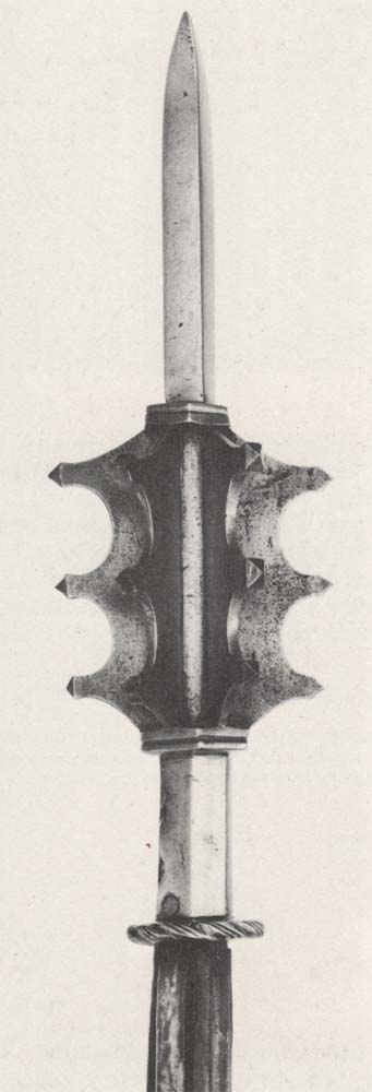

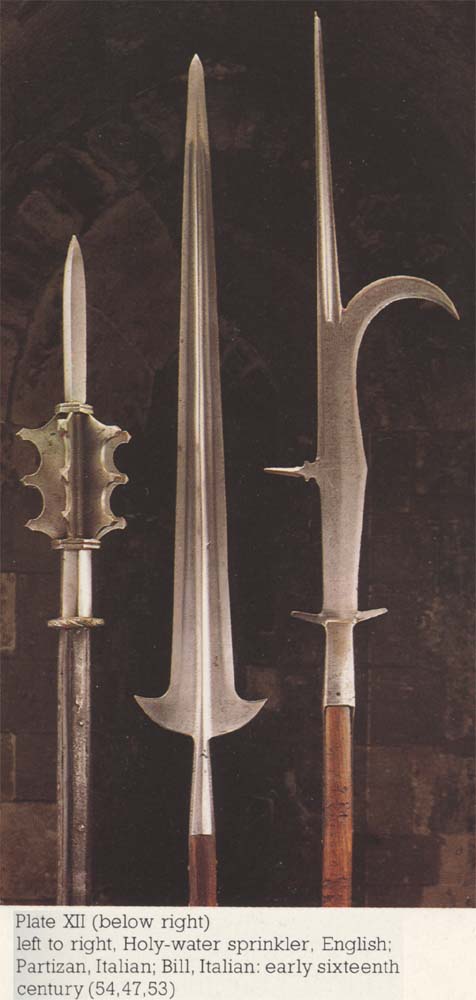

Here's an interesting bit of information regarding the holy-water sprinkler from Treasures from the Tower of London: an Exhibition of Arms and Armour, compiled by A. V. B. Norman and G. M. Wilson.
Norman & Wilson wrote:
The term "holy-water sprinkler" appears frequently in sixteenth- and seventeenth- century English inventories, and seems to refer to a long, spiked club...It was apparently a pecularly English weapon, for one Venetian ambassador, Nicolo di Savri, writing in 1513, notes that 12,000 of the English army were armed with "a weapon never seen until now, six feet in length, surmounted by a ball with six steel spikes". 493 plain "holy water sprinklers" are listed in the 1547 Inventory of the possessions of King Henry VIII...
I find it odd that this was claimed to be a uniquely English weapon, since similar weapons were certainly used in Central Europe, but this does support the claim that the name "holy water sprinkler" was used in the period of use of the weapon. I imagine that the name "holy water sprinkler" is probably a uniquely English term for this weapon. Maybe the Venetian ambassador hadn't seen Central European examples of this weapon.
Another interesting point is the fact that the one shown in the book, the one that was part of the exhibition, has a very mace-like look to it's head. It certainly could be called a "pole-mace". The spikes are along flanges, and the whole head is of iron. Here's the description from Tresures from the Tower of London:
Large, heavy iron head, consisting of six flanges, each cusped twice to form three spikes, the spikes of alternate flanges having pyramidal tips. Above is a thick top-spike of diamond section and, below, a hexagonal neck ending in a large roped roundel. Wooden haft of squre section with chamfered corners reinforced for its entire length by four steel straps.
Dimensions: Length overall, 74.5 in (189.2 cm) Length of head, 15.5 in (47 cm)
Weight, 11 lb 9 oz (5.24 kg).
Perhaps someone with this book could scan in an image of this weapon to post it on this thread. It's number 54 on pg. 69 in Treasures from the Tower of London. There is black & white photo on that page, and also a colour picture on plate XII, page 13.
I hope this was of interest!
Richard here are the pics of the Holy Water Sprinkler from the book "Treasures From The Tower Of London"
Enjoy
Danny

PostPosted: Sun 31 Dec, 2006 10:00 am    Post subject:         Reply with quote
Hello all!
Danny,
That was the one I was referring to out of Treasures from the Tower of London. I was hoping others could see it; a description can only take you so far. Note that the head is flanged, like a more typical flanged mace. This could certainly be called a "two-handed" mace; it's just over 6 feet long. I don't think this was necessarily a "peasant's" weapon; perhaps it was a guard's weapon or something like that. This is one "holy-water sprinkler" where crude is not an adjective I would use.
