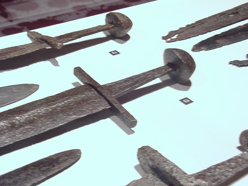

Very nice drawing! I think the pommel would be a bit more rounded towards the bottom and likely wouldn't come to a point at the top. I'm attaching a photo that shows some B.1 pommels from below. Notice there is a very slight curvature in both examples. It seems that the picture you have based your drawing on has a rounded bottom as well.
 Attachment: 77.19 KB

PostPosted: Tue 01 Feb, 2011 11:24 pm    Post subject:         Reply with quote
Tim,
Is your photo from La Musee de Moyen-Ages in Paris?

PostPosted: Thu 03 Feb, 2011 10:05 am    Post subject:         Reply with quote
Craig, I'm not sure, I have so many pictures of swords and I am crap at cataloging them.
Jeremy, many type B pommels do have a fairly flat bottom edge but it seems a lot more common on the earlier examples of the type. Not saying it would be wrong, just uncommon.

well ... then a bit more rounded would be best for this. Regarding the question of Scott's sword is Switzerland 1100.
I would ask a favor manufacturers, for now my time has been reduced a lot because my work schedule changed a lot, wanted to know if any of you that is a manufacturer could sell a pommel like Tim photo, just ask the pommel because right now I have no materialsdo so , I have just the materials for the blade and guard , and as I dropped my free time and do not think I can find the material to make the knob , ratherthan the pommel out of iron.
