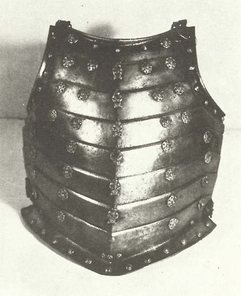

Banded; the photo of the Hussar breast-plate i added, but i believe this style has existed way before the 16th cy.. ?? or possibly the Wisby Plate Armour of the 14th cy..

 Attachment: 33.11 KB
Fig. 11—Hussar breastplate in Hungarian style, late 16th century (Museum of Kómik).jpg

i've incorrectly put Anime Breastplate (16th cy.) as a possible explaination for Banded Armour, so my statement "i believe this style has existed way before the 16th cy.. ??," made about the above Hussar Breastplate photo most likely false.
Banded Armour; possibly the Wisby Plate Armour of the 14th cy.. (??).

Hussar and other segmented breastplates from the 16th and early 17th century are currently known as anime breastplates. The reason for the style is up in the air, but one possible explanation was that they could heat treat the smaller plates more successfully, making the assembled breastplate more resistant to firearms.
As far as Meyrick's descriptions, unless he is stating that his various classifications of armor are describing later centuries than the 12th, consider the whole mess to be be in the strain of the Bayeux tapestry misinterpretations.

i believe that the Wisby find explains Banded Armour (if so called that at the time?) to mine, as well as others, satisfaction.
"Banded armour" or "banded mail"? They are completely different things. Meyrick uses "Banded Mail".

PostPosted: Fri 26 Oct, 2012 5:33 pm    Post subject: banded armour         Reply with quote
i understand meyrick's mistake with the label "Banded," and i also understand his mistake in using "maille" in the same label. i'm leaving the meyrick mis-identification terminology behind this discussion for now. i don't believe Meyrick's "Banded Maille" even existed, if there's anything close to an "Armour" that could be construed as "Banded," it would most likely be the armour found at the Wisby site, aside from anything involving Meyrick lingo. lets move on please, since we are both in agreement on this matter and the misuse of the word Maille. . .

PostPosted: Fri 26 Oct, 2012 5:47 pm    Post subject: Banded vs. Coat-of-plates . .         Reply with quote
yes i know, Banded Armour, in my opinion is . . . Coat-of-plates. i have Banded Armour as being the same as Coat-of-plates in my write-up.
