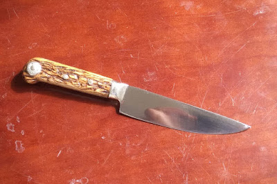

Thought I'd share this little project. It's made from a "Spanish mini-belduque" that can be acquired from several sellers.
The wood faux-antler scales aren't entirely convincing in person, but, eh.
So, I was wondering if anyone could recommend what I might use for the fork, bodkin and cleaver. For the latter I had the idea of perhaps using a machete in the 12-inch range. It's my understanding that a meat cleaver should have a very heavy blade for its length.

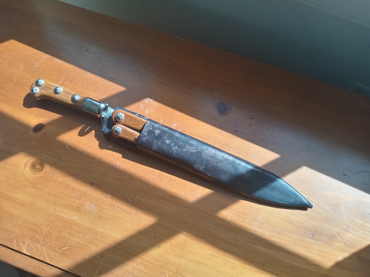

Hi again. Well, this is going in a somewhat different direction. I've decided to furnish the set with oak grips and steel hardware, which looks to be working out much easier; I took Radovan's recommendation of using furniture tack heads for the washers, and yesterday I stumbled across Lukas' rugger WIP thread which gives a clear idea of how to assemble the bolsters and side ring rivet without the ring being able to rotate in its pin hole after it's peened. I'm giving up on finding an awl -- though if I ever do stumble across one, incorporating it would only require a rebuild of the cleaver scabbard. And I'll be reusing the original knife for some other project. I did find a much nicer one, though.
(The lighter-colored areas of the grips are where I sanded them to fit perfectly flush with the tang edges and then had to re-round them. They'll look better once varnished.)
Recently I started to think I'd like a matching sword, like in this set: https://collections.royalarmouries.org/object/rac-object-151
There don't seem to be any off-the-shelf blades available with a slab tang like the trousse components have, but I did find a historical example that appears to have had a hidden tang (see attached). I'd been thinking of rehilting a Deepeeka English half-basket hanger as the originals all seem to have had straight blades and the narrow fuller and needle point are within the range of historical examples, but then the question is whether the hilt will be a convincing match with the rest of the set without attempting complicated frame-handle construction.
With a hidden tang the washers would be purely decorative, except in the unlikely case that the tang is wide enough to drill pin holes through. In the absence of pin holes, I would have to leave the shanks on the tacks, shorten them and reshape the points, which would be tedious, and they won't have the mechanical security of a rivet peened over them at both ends.
 Attachment: 19.34 KB

PostPosted: Wed 12 Oct, 2022 1:00 pm    Post subject:         Reply with quote
Dear Dan D'Silva,
Have you thought about trying to find tacks with longer shanks that you could drive against the tang and force them to turn back into the wood of the grip, clenching them in place? It's a fairly common historical solution--admittedly, not often for knife or sword grips--but may not work with short-shanked tacks or ones that have comparatively hard shanks. Of course, if the tang is wide enough that you can easily hit it with the tacks' shanks, it's probably wide enough to drill holes through.

PostPosted: Thu 13 Oct, 2022 5:00 am    Post subject:         Reply with quote
That sounds like a great idea. I think the shanks on the furniture tacks are long enough unless the grip is thicker than I expect it to be. It may take some experimenting to find out if grinding them to a taper and/or annealing them is necessary.
I don't trust my competency to align pin holes in the grip for a hidden tang, even if it is wide enough. Maybe if I went through with a frame handle... but I'm getting ahead of myself. Deepeeka tang widths vary a lot, no way of knowing unless and until I actually get one.

The hardware for the cleaver is all done and I cut the scales to rough shape this morning. But I'm starting to come around to the view that this blade is a bit too light to qualify as a cleaver, especially now I've had to leave out the protruding finger guard -- aside from the ring rivet and washers it's now looking mostly like a generic Hauswehr.
Maybe at some future date I'll commission a proper cleaver blade and an awl.
Dan D'Silva
Joined: 28 Apr 2007
Posts: 321
PostPosted: Mon 19 Jun, 2023 5:36 pm    Post subject:         Reply with quote
Scales shaped, varnished and pinned. Now there's only the scabbard to do (although that's a whole other project by itself).
