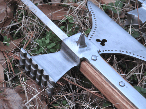

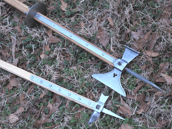

That might explain the extreme over-welding of my example. I had to do lots of grinding inside the langets at the socket just to be able to mount the piece. Everything else was aesthetic refinement. If anything, I'd say mine was overbuilt, but it turned out great! I got what I expected for $45 (although, technically, it was somebody else's $45). I'd have been pleased even if that came out of my own pocket.
One way to think of this is to compare the price to a finished pollaxe, decide on a reasonable hourly wage and estimate how many hours you'll need to finish the project. I think most folks will find that even at a theoretical $10 per hour their investment will exceed the price the A&A pollaxe. That's only theoretical, though. It's all sweat equity.
Here's the one I made:
 Attachment: 218.11 KB
 Attachment: 181.07 KB

I got a couple early on and had no problems with them. Did have the same issue Sean Flynt did. Had to do a lot of metal removal in the socket.
Sean I must say yours came out really nice. Where did you get the square haft for the project. I had a devil of a time and ended up using and hexagonal one.
Thanks! I used ash wheelbarrow replacement handles for these hafts. They're cheap ($13) and readily available at DIY stores like Lowe's (check the tool handle aisle). They're 2x2 and 60" long, so you can make of them pretty much any historical haft type you want. It's hard to see in these photos, but mine are ocatgonalized with ~.25 bevels. I ripped these hafts on a table saw to almost the right dimensions and then finished with a hand plane. I was actually much too conservative with the saw and spent a HUGE amount of time with the plane. These handles are ideal for pollaxe projects.

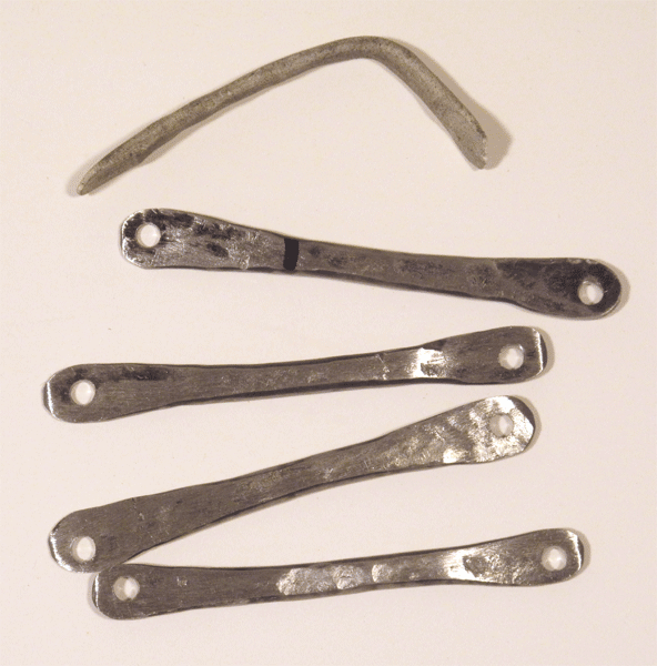

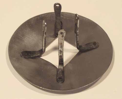

While not strictly on-topic, maybe y'all would be interested in some comments about the rondel. I had to figure this out on my own and I might be able to save you some trouble.
I cut the rondel out of 16 ga. mild steel, marked the center with a punch and marked off a square the same shape as the haft. Then I just held it at a slight angle on my little anvil and went around it in courses with the hammer, working in toward the center as a spiral but stopping at the marked square. In other words, it's a shallow dome with a flat top. No heat. I was striking just above the point of the steel's contact with the anvil. I was using the rounded-over "flat" face of an ancient small ball peen hammer. That left very few marks and required no planishing. I just lightly sanded the top side and underneath. I screwed up the opening. Measure twice, cut once, right? I didn't want to start over so I gambled and heated the sides of the opening I cut too deep and spread those inward with my hammer and anvil. Worked perfectly. I didn't inlet the langets, so my original plan was to to cut a channel for the langets in the rondel. But this is what I ended with due to the measuring error and it's perfectly sound.
I used some cheap steel rod for the rondel supports. I modeled them in Sculpey first. Yes, that pitiful gray object at the top of the image below used to be beautiful white Sculpey. That worked perfectly. I cut the rod, heated the sections to orange and shaped them hot. Then I just drilled and riveted them to the rondel. I attached them to the haft using modified nails but didn't think that was secure enough so I added JB Weld to the nail holes. I left the supports rough but I sanded them lightly just so they weren't black from the hot work.
 Attachment: 103.2 KB

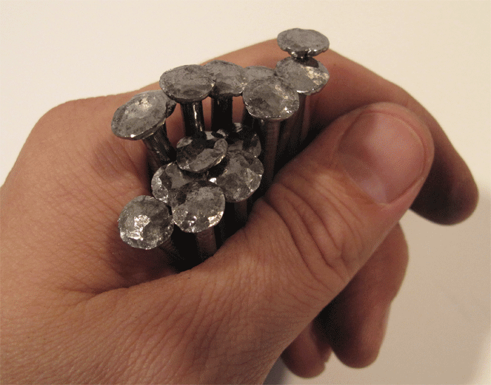

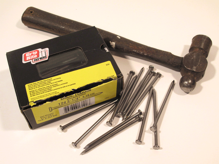

As you see below, the langet nails are just regular, off-the-shelf bright nails (not galvanized) from Lowe's. I used to cut these off, put them in a bench vise and hammer the heads with the ball of my little hammer (second image below, before sanding the heads to knock off the edges and shine). That's still a good way to give them an authentic forged look but I thought this pollaxe needed something more refined. I cut them off and just quickly beveled the edges on the grinder. That is MUCH faster than hammering the heads, and results in a clean look that isn't too modern-looking. I use JB Weld under the langets and in the nail holes. It is historically correct, by the way, to use one nail in each langet hole (as opposed to putting a nail all the way through and riveting it on the other side). The trick to this is that if you're just cutting off modern nails they can't pass each other in the haft or clinch against the opposite langet as originals-narrow, tapered and sharp--would have done. You have to make sure you cut off the nails just short of halfway through the haft so they don't interfere with each other.

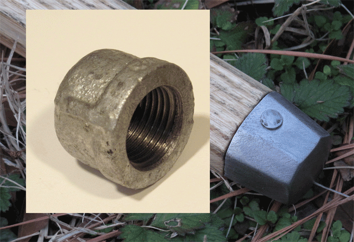

It took me a long time to figure out a good solution to the need for a que/cap/pommel. For the poleaxe, I robbed the square-section cap off of the Windlass hammer shown above. I beveled the edges of that to octagonalize it. There is a more widely available solution, though. I still wanted a cap for the hammer so I bought a threaded pipe cap and ground and filed that to an octagonal section, fitted it, drilled it, riveted it and did the final sanding in-place so I could match the bevels of the haft. I'm proud of that solution. Took me a long time to think of it. It's a secret, though. Don't tell anybody! Big Grin
