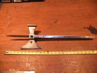

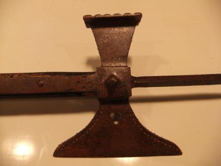

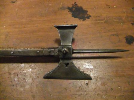

Recently I was inspired by this thread to get off my duff and do something with my poleaxe head lying about the shop collecting dust.
The GDFB Poleaxe, Head Only (XB0099) is a nice piece for the money, although some minor file work was required.

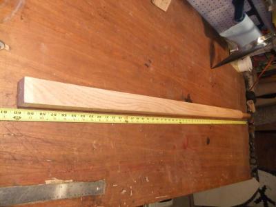

An ash wheelbarrow handle from the local hardware store was used for the haft. I ripped it down to 1.25 inches square on my table saw, then used a spoke shave and hand plane to give it a moderately octagonal shape below the langets.
I decided to not inset the langets into the haft as I had been told “this is a special kind of hell”. Maybe next time. I did sand it lightly while leaving some "flaws" as I will be distressing the piece. The haft was liberally rubbed with boiled linseed oil several times.

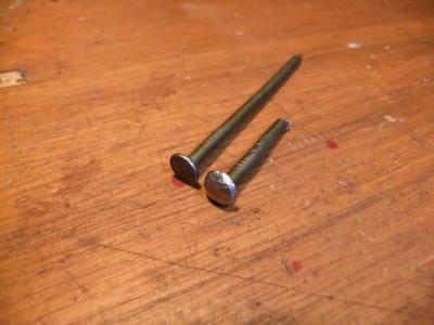

As Sean Flynt mentioned, “There's a shocking lack of proper langet nails these days.” I resorted to peening standard 8 penny nail heads, which gave a less manufactured look, then cut the nails to length. I cut them so that they would just barely poke through the other side of the haft. As this piece will be for decoration only, I did not cut them long enough to protrude from the haft in order to peen them over. I did cheat a little and added epoxy into the head mount just to be safe.

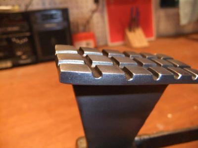

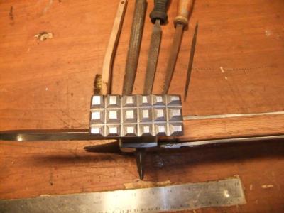

The hammer head has a simple waffle pattern. Wanting little pyramid shaped nubs instead of little square ones, I spent a quality evening with my trusty files.
Attached below is a progress shot taken a few days ago. It should be obvious that I am no photographer. Blush I decided to have a little fun and took a moderate strength stab at an old shield leaning against my work bench. This half-hearted stab with an unsharpened point protruded 2 inches through 0.5 inches of laminated plywood! Eek!
Currently the poleaxe is undergoing “forced aging” using techniques in the The Instant Antique feature article. I will post photos of the distressed poleaxe when the process is complete. Happy

That looks outstanding, Scott! So you have, what, $50 invested? Big Grin I'm especially impressed by your work on the hammer face. I wish I had your langets! Mine are rather thin.

I have a total investment of $63 USD and several hours in this project. Happy
Thank you for the filing compliment. I wish the hammer face had more "meat" to it as there wasn't enough to get the pyramid heads to a sharp point. I had to settle for a Mayan-like flat topped pyramid as a Snefru shape would have looked rather silly.
You are correct, the langets are very hefty. Because I didn't inset the langets into the haft, some minor filing was required at the ends to prevent injury to my hands when changing guards. It is worth noting the langet-to-head welds are very suspect. I was liberal with epoxy in this area because it scared me a little.
I dished a stop-guard last night and rolled the edge. Mounting will have to wait until next week.
Your aging tip regarding salt and vinegar in a spray bottle was spot on. There’s been some serious corrosion after just one night!

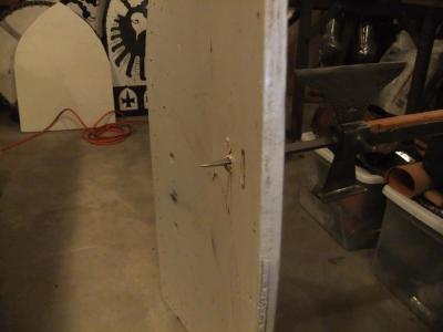

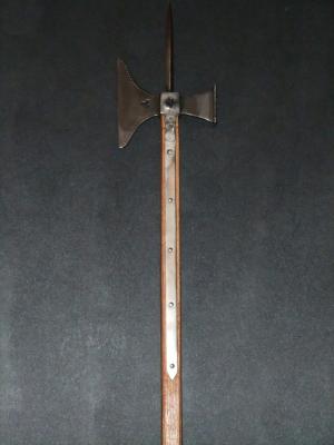

Progress has been made. 5 days after applying the "aging spray" the poleaxe was well oxidized. An initial cleaning with 0000 steel wool revealed some nice results. There's still work to be done...
Nice!
I have the same GDFB polaxe head, but mine is a bit uglier - hammer head is not quite aligned with the central axis. But I can live with it, all the welds seem OK. I'll reshape the hammer face as you did, and I've already made the haft - 1,5 meter ash, rectangular at top and octagonal at bottom. I made it from 33 x 33 mm piece, which tapers slightly to the bottom. I also chiselled grooves for the top part of the langets, and since the haft tapers, it does't bend them too badly - I don't want to chisel the whole langets into the haft.
I'm not really impressed with the surface finish of the polaxe head - some parts are almost mirror finish, and other (welds) are pretty rough. This "instant ageing" process looks like it could give it a more uniform appearance, I might just try it. Before I nail the head to the haft.

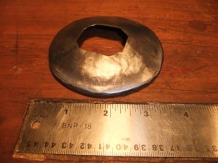

I'm having rondel/stop-guard issues. Sad
Currently, it's 4.5 inches in diameter which just feels too large. Does anyone have a good idea what diameter they are supposed to be?
I would have no problem trimming it as I'm totally dissatisfied with my edge rolling. I hurried the job and did not roll the edge over wire.
PostPosted: Mon 30 Aug, 2010 6:32 am    Post subject:         Reply with quote
I think you could reduce it to 4" if it bothers you. It seems to me that it's meant only to prevent a blade from sliding down the haft and cutting the forefinger and thumb. I don't think it's meant to offer much protection to the rest of the hand. These seem too small for that.

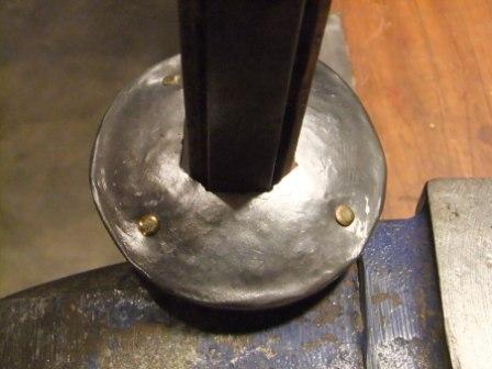

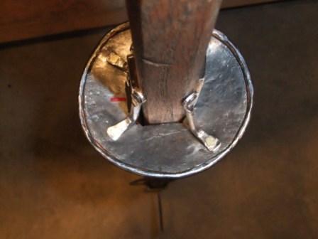

I carefully cut off the poorly executed rolled edge and took my time re-rolling the edge over wire. I'm very pleased with the results. The diameter is now 3.75 inches which both looks and feels ALOT better. Happy
Some issues have arisen while mounting the rondel with custom made brackets. I chewed that fat a little bit last night with my buddy and sparing partner Hanns Wiechman and I think a solution is at hand. Pictures will follow after the holiday weekend.

Here are some more progress pictures. I managed to make four mounting brackets out of 1/8" round stock. The rondel is 3.75 inches in diameter and the center has been filed out to match the profile of the haft, including langets. I mounted the brackets to the rondel using little brass rivets for some contrast in color. The brackets were then nailed to the haft with some more homemade arming nails.
The last part was the trickiest. A lot of time was spent bending the brackets "this way and that" to get everything to line up just right.
The last photo clearly shows one of the dents I made by whacking the haft with all manner of tools in the shop. That was a FUN evening of "antiquing"! Big Grin

Mounting brackets
 Attachment: 28.45 KB
Rondel
 Attachment: 30.68 KB
Brackets attached
 Attachment: 22.85 KB
Rondel finished
