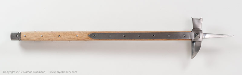

Last year, forum member Sean Flynt and I made a trade. I gave him some stuff, provided a Windlass warhammer and a GDFB poleaxe head and he made me two completed polearms:
You can read about some of the details direct from Sean in this topic: GDFB Poleaxe head.
This topic is merely a means to show you the final result. I'm extremely happy with these two pieces. Who knew that with just a bit of skill (as Sean would describe it) and a couple inexpensive parts, one can have a top-notch set of polearms? Somehow I think Sean might be underestimating his skill-set!
The pole hammer is about 64" long and the poleaxe is about 66.5" long.
Have a look:
Click photos for full-sized versions

The pole hammer started out as the Windlass spiked warhammer. See below.
 Attachment: 18.04 KB
Warhammer as made by Windlass Steelcrafts

Thanks for posting those, Nathan! Of the two, I prefer the fussstreithammer. It feels more responsive to me and it's a much easier build. Yes, the GDFB blade is pretty thin. There are finish problems that have to be resolved before mounting (or there were in this and at least one other case). The WS hammer head, by contrast, comes off its original haft neatly and drops right onto the new haft without any additional metalwork. Woodwork is another story. If you want the proper ash, you'll have to cut down a wheelbarrow replacement handle ($15,) octagonalize and taper it, and cut it to match the head socket and pommel/que. Still pretty easy.

It looks as though you replaced the screws on the warhammer with rivets. I've been having a hard time finding the right kind of rivet for a Lutel halberd that my wife got me for Christmas. Perhaps you can point me in the right direction?
Eric Gregersen
www.EricGregersen.com
Knowledge applied is power.
PostPosted: Mon 23 Jan, 2012 11:15 am    Post subject:         Reply with quote
Eric Gregersen wrote:
Great work, as always, Sean.
Re-read the topic linked above. Sean talks about it and shows photos of what he used.
