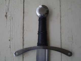

When I was home for Christmas, I took the time to redo the grip on my MRL/Windlass Falchion. I wanted to post it partly just so people could see the difference between Sean Flynt's and mine. I think it is always interesting to see how two projects using the same things end up different.
My grip was partially inspired by the grip on the effigy of Gunther von Schwarzburg, which can be seen in figure 77 in Oakeshott's Sword in the Age of Chivalry. That effigy shows a central riser (on a bastard sword, mind you) composed of two risers that cross, forming an "X." The double risers at top and bottom were my own fancy. I can't really call this an historically accurate grip (I haven't seen any done quite this way), but I think it still qualifies as historically plausible.

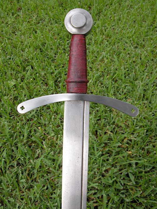

For those who haven't seen it, Sean's MRL Falcion grip:
My MRL Falchion grip:
 Attachment: 15.76 KB

Looks nice, Grey. It is pretty interesting how much of a difference a "simple" change like that makes in the same piece. I've been party to a number of discussions over the years in the reenactment community around having some variety in the pieces used - to avoid that cookie-cutter look. This is an excellent way to personalize and individualize pieces so that even with a limited number of options available, there is enough variation.
I know you've done a few of these grip projects, and your experience and familiarity shows. Would you want to share how you made the crossed over risers? Looks cleanly executed!
I'm not a big fan of the word proprietary, so of course I'll share, but it isn't too big a mystery. Before I glued the cord in place, I drew a couple of lines on the grip, so that I would know where to place my risers. I then glued one riser all the way around on the diagonal. The other riser is actually done in two pieces so that they don't have a bulky over lap. The tricky part was doing the cord overwrap once the leather was on.
I used croquet thread so that I would get good definition. I had to do a figure-eight pattern in which I ran the cord from the bottom of one riser and then bring it over the top where they cross. I was still wrapping cord on the diagonal at this point. By doing that, the cord was basically pulling towards itself, and it kept things tight. After a couple of wraps, I would run the cord around once without switching it to the other side of the riser (i.e. coming back down with the cord on above the riser, I would leave it above), so that I was then repeating the process on the opposite side of the riser.
In order to wrap the cord around the other half of the riser, I just did one quick, horizontal, wrap around the grip. Once I had outlined all four facets of the crossed risers, I just wrapped the cord around the grip normally. Because of all the overlapping where the two risers meet, it really isn't as pretty as the picture makes it look. There is hodge-podge of lines running through there. Still, I am happy with it; in fact, I think it is the best grip I have done so far.
One other thing that I did to make this one a little nicer was to avoid having the edges of the leather so at top and bottom. That was one of things I noticed about my Albions. They fold the top and bottom of the leather over so that there is a nice smooth roll, rather than an edge. In the end, though, the thing that makes this grip look so nice is that I used such a thin cord on the outside. You just get a lot cleaner lines that way.

PostPosted: Tue 19 Sep, 2006 5:25 am    Post subject:         Reply with quote
I've been meaning to add a larger picture of this grip for some time. Since I recently upgraded my membership and now have more forum posting space, I really have no excuses (not that I had any before...). Hopefully, you can see things a little more clearly with this picture. Enjoy!
-Grey
 Attachment: 35.04 KB
