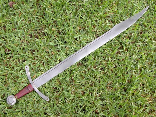

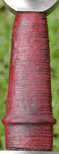

Seeing the drawing of Albion's upcoming "Vassal" ( see it here: http://www.albionarmorers.com/swords/albion/nextgen/vassal.htm ), which is similar to the Thorpe Falchion (see stats here: http://www.myArmoury.com/review_mrl_falc.html ), inspired me to learn how to give my MRL/Windlass falchion a better and more attractive grip.
Wood: The original grip was well made, as described in my review, but needed to be narrowed at both ends so the cord and leather wouldn't protrude beyond the hilt furniture. I chiseled away a bit.
Cord: Two sizes of hemp cord from Hobby Lobby. This stuff is rough and irregular in diameter along its length, which gives it a more homespun quality that I like.
Wrap: This is what hung me up for so long. Very thin, high quality leather is expensive and hard to find in small quantities. There was nothing in the scrap box at the local leather repair shop. I had a really good idea when I bought a pair of dark red high-top women's boots at the local Goodwill for $6. Unfortunately, although the thin red leather uppers provide enough material for 1-3 plain leather grip wraps, they aren't thin enough to let a cord wrap be clearly defined. I'll save that material for another project. Finally, I just dyed a $10 chamois from the auto dept. of the local K-Mart. This was almost perfect, the only drawback being the matte surface. With some experimentation I realized that the surface can be smoothed with ordinary beeswax weatherproofing and buffed to a good polish with a shoeshine brush (I also darkened the color with a touch of cordovan shoe polish). I'm sold on the chamois, now, and can get an estimated 3-5 grips out of one piece.
Method: I clamped down the sword on a work table with the hilt hanging out over the edge. I started the cord with epoxy so I could wind it tightly around the grip. After the expoxy set I covered the grip with wood glue and wound the cord onto the grip. At the end of the grip I secured the spool of cord and suspended a weight in the middle of the line running from spool to grip to keep tension on the drying grip. The little riser is just a thicker piece of cord glued in place on top of the thin cord to fit between my index and middle finger. When the cord was dry, I trimmed the chamois to rough size, wet it and glued one edge to the grip with epoxy. When the epoxy dried I covered the grip with wood glue and pulled the wrap tightly around the grip, overlapping my starting point. Next, I secured to one of the arms of the hilt one end of a new strand of the fine cord, then wrapped that tightly around the entire grip, top to bottom and let the whole assembly dry. Finally, I removed the cord overwrap, trimmed the leather at the overlap, top and bottom, and waxed, polished and buffed the finished grip.
There are a few unattractive spots I attribute to being a first-timer, especially at the base where I trimmed the wrap too close. The seam isn't invisible, but it's flush and neat. Overall, I think this very fast and easy project dramatically improved both the look and handling of the piece. Unfortunately, it's as close as I'm going to get to a Vassal. Sad
