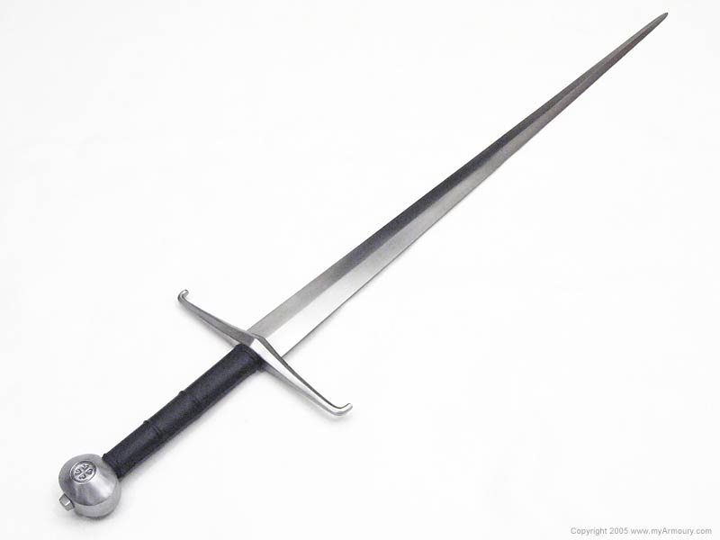

Weight:3 pounds, 11.5 ounces
Overall length:43 1/2 inches
Blade length:34 inches
Blade width:2 inches at base, tapering to 5/8 inches
Grip length:7 inches
Guard width:9 3/8 inches
Point of Balance:2 inches from guard
Center of Percussion:~18 inches from guard
Oakeshott typology:Type XVa blade, Type J1 or I with a recess pommel, Style 8 guard
Replica created by Arms & Armor of Minnesota.

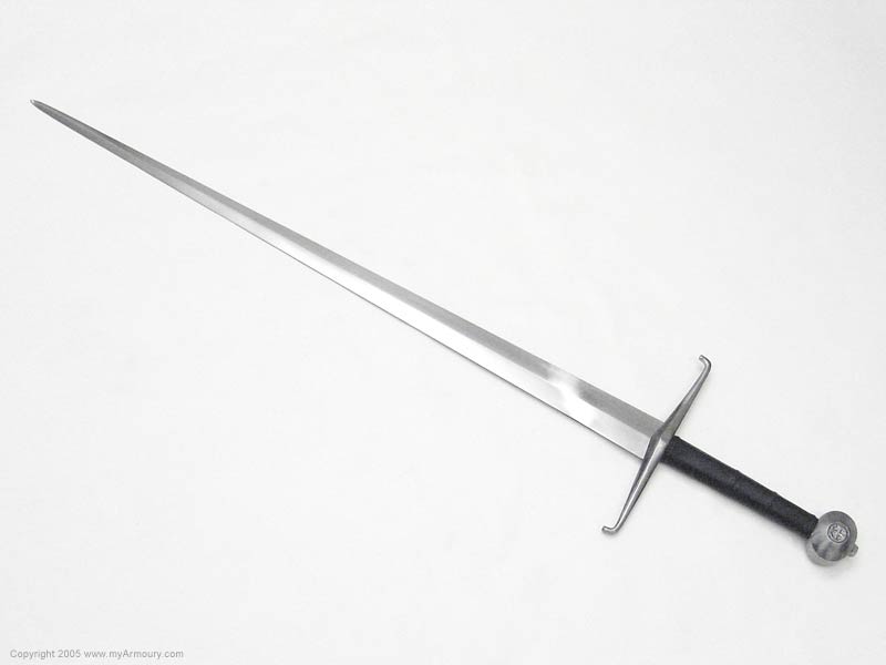

Handling Characteristics
When holding the Black Prince sword for the first time, it almost feels alive in the hands; it seems to practically know what you want it to do and where you want the blade to go. This sword is essentially a dedicated thrusting sword whose point would have deadly efficiency if used by someone who knows how to exploit weaknesses in armour. Its cutting ability, while secondary, is admirable. Like all Arms & Armor pieces, the Black Prince sword comes with a serviceable edge. A thick cardboard box was cut in half in three or four cuts; not bad for a blade that's only 1.25 inches wide at the center of percussion.
"No part of the sword was invented in vain," said Johannes Liechtenauer in 1389 in one of his famous fechtbucher while describing how hilt components can be used in battle. The Black Prince Sword is solid proof of this statement. Its massive pommel could be used as a mace to bludgeon an opponent's head or face. In armoured combat, the sword could be gripped by the blade and used as a hammer; the resulting trauma from strikes caused by the Style 8 guard would be ruinous.
The Black Prince sword has such an incredible balance that it could be used quite easily with one hand despite weighing roughly 60 ounces. I am able to hold the Prince's leather grip with both hands, but since my hands are rather large, it is a tight squeeze. This is easily solved by taking my guide hand (my left since I'm right-handed) and grasping the pommel. Though the Black Prince's pommel can be called a "weapon within a weapon" as I discussed above, it is very comfortable when grasped and adds to the ease of the sword's use, especially in point control.

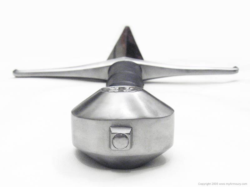

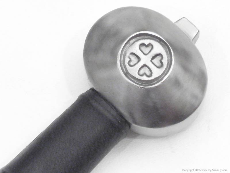

Pommel Detail

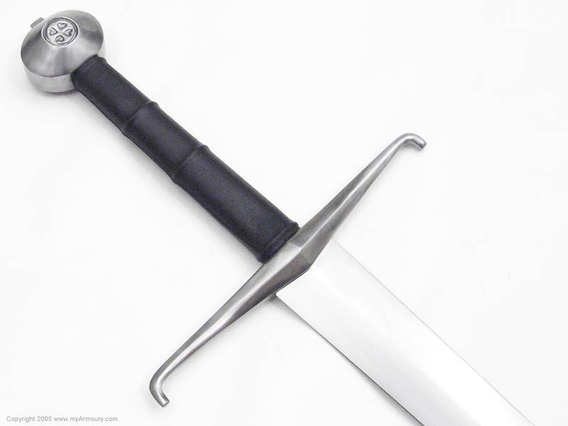

Click to enlarge

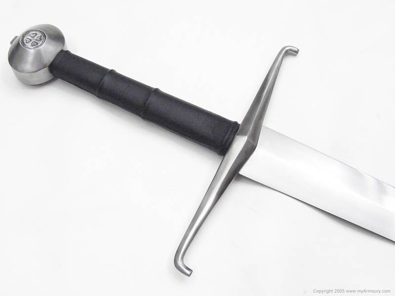

Cross Detail

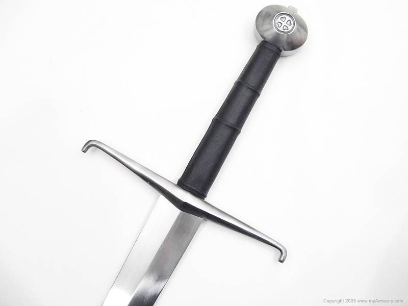

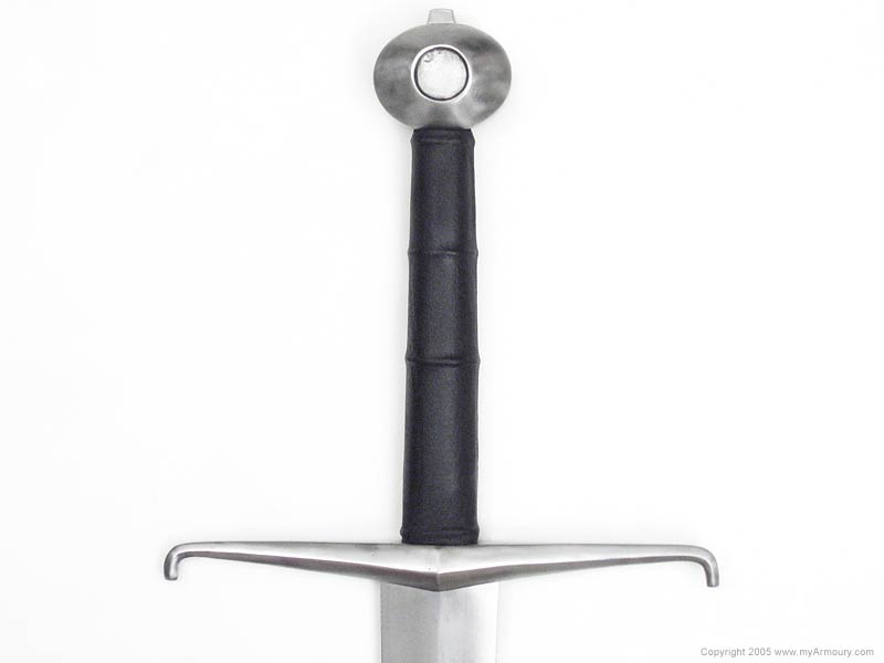

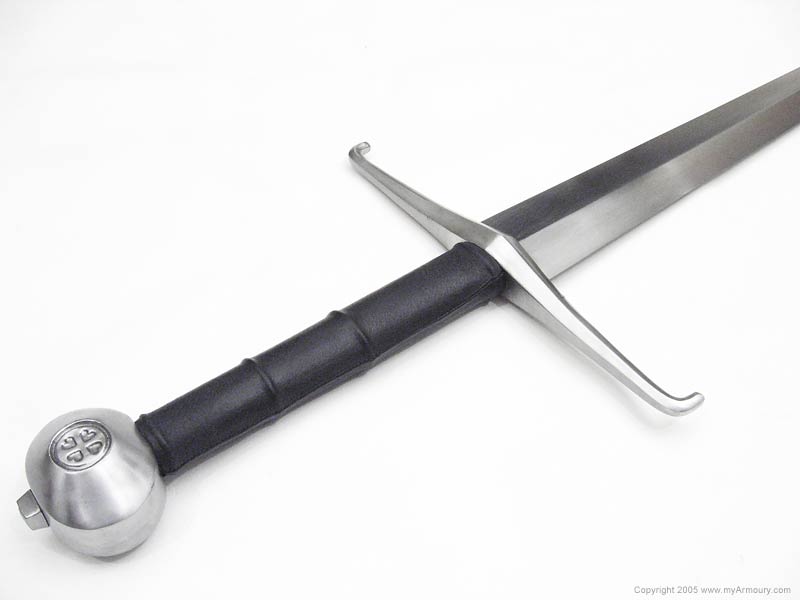

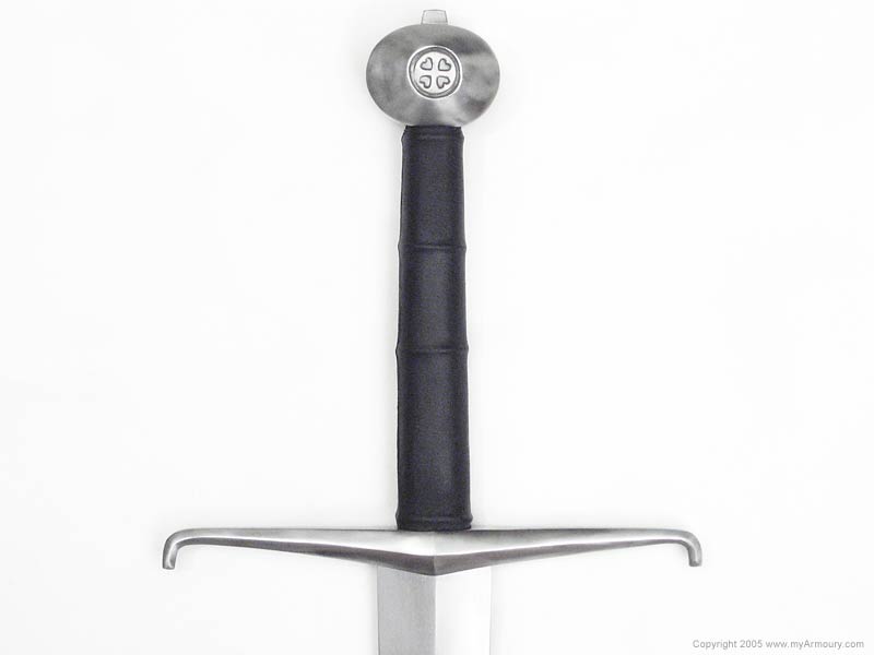

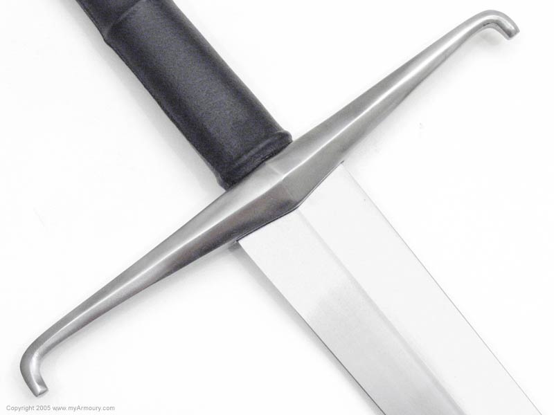

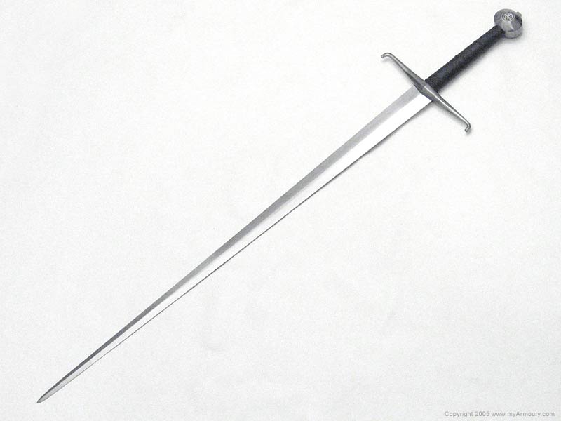

The Black Prince sword is categorized as a Type XVa on Ewart Oakeshott's typology, and I have always described this sword as the quintessential Type XVa. Upon first glance, the overall design of the Black Prince doesn't give the first impression of the war sword that it really is. But the date of the original sword (circa 1370) is a time when plate armour was becoming more commonplace on battlefields, rendering the earlier Type XIIa and Type XIIIa blades potentially less useful.
The blade and hilt are finished with Arms & Armor's signature satin finish which gives an austere beauty to this and all of their other pieces. When viewed from the side, one can see that the Black Prince's distal taper is by no means machine perfect, but is executed extremely well. The profile taper of its Type XVa blade is outstanding and complements the near-perfect spine that runs the length of blade, showing a profound diamond cross-section when viewed downward from the tip. The guard and pommel show very slight imperfections that can only be spotted with close examination. Such observations should not be seen as flaws, but rather as traits of a hand-made object which is exactly what this one is and the original was.
I am very thankful to Arms & Armor for recreating this sword with its original grip featuring the two risers that encircle it. The leather stitching on the one side is quite visible, but very secure and is not a hindrance when wielding this sword. The small cross design on the pommel is a nice touch that adds to it a subtle air of sophistication; after all, this sword symbolizes the son of a king—the Prince of Wales no less.
