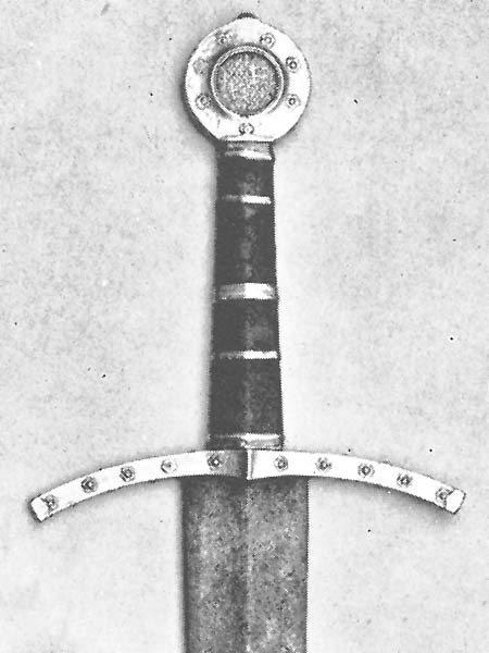

The original
Edward III sword
The original sword has been dated between 1348 and 1350. This sword has been a focus of controversy for years. In fact, for many years it was believed to be a fake. It was only through an exhaustive scientific examination conducted in 1983, that the sword's provenance as an original piece belonging to Edward III was established. It is unknown if the original sword was ever used in battle; however, according to Oakeshott, it was admirably capable of serving as a battle weapon. It is light and well balanced. X-ray photographs also show that the sword has a substantial tang. There are also wear patterns on the grip that suggest that the sword just might have served in hand at some time during its life. The original bears a maker's mark; a portcullis (a Plantaganet badge) and the badge of the Order of the Garter stamped on each side with the motto of the Order: "Shame on him who thinks this evil." The original also has the original adder skin grip. The grip is gold plated iron. The pommel bears the coats of arms of England and France quartered in enamel on one side and on the other are some small strips of fabric said to come from the shroud of Edward the Confessor placed under a rock crystal inset.
