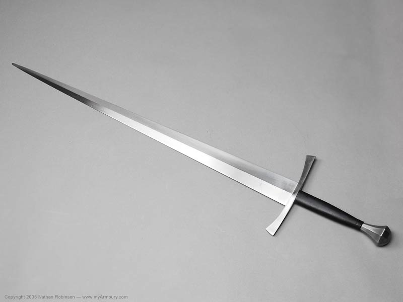

Weight:2 pounds, 15 ounces
Overall length:42 inches
Blade length:33 1/2 inches
Blade width:2 1/2 inches, tapering to 1/2 inches
Grip length:5 3/4 inches
Guard width:8 inches
Point of Balance:4 1/2 inches from guard
Center of Percussion:~21 1/2 inches from guard
Oakeshott typology:Type XVa blade, Type T pommel, Style 6 guard

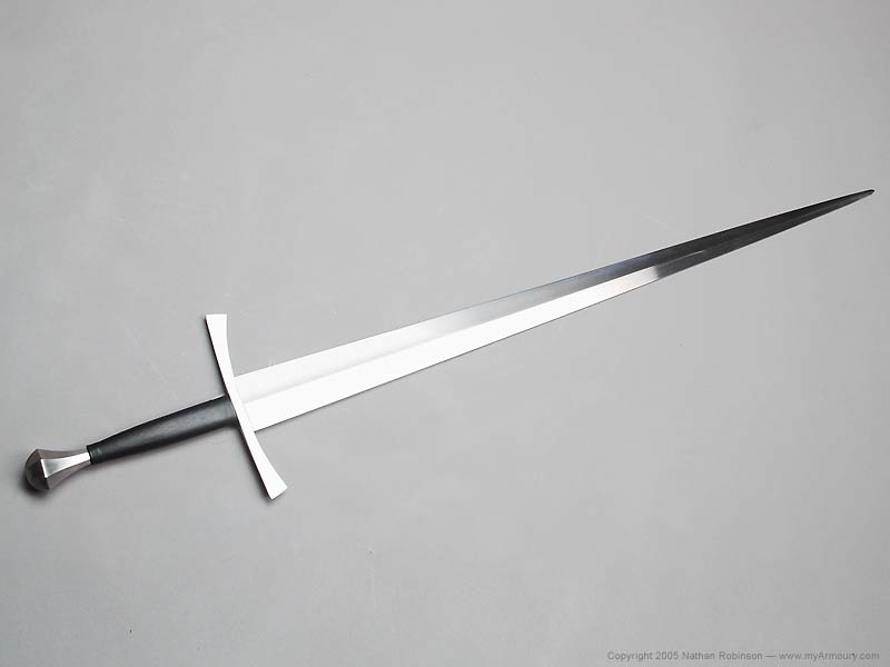

The term "bastard sword" is generally used to describe a sword that can be used with either one or two hands, and therefore it is a fitting term for this weapon. This sword feels quite at home with either single-handed or two-handed techniques. Using two hands on the grip, the balance is at a point where the sword is fast and easily maneuverable for strong cuts, yet at the same time does not feel out of control. This sword is short enough to ensure quick cuts and attacks, and when used single handed is still easy to handle. The blade has just enough presence to really guide the sword in the cut, particularly in one hand. Using George Silver's method of measurement, as described in his treatise Paradoxes of Defense, the sword fits my perfect length for a two handed sword; i.e., by holding the sword at one shoulder and reaching out with the other hand in a closed fist, as if holding a dagger, the sword fits just right. Another way of looking at this measurement would be to say that if I grasped an opponent at the shoulder with an outstretched arm, I could still comfortably pull the sword back to thrust.

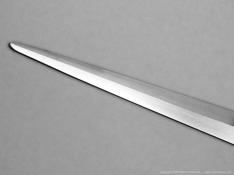

The Rounded Blade Tip
This sword was bought with the intent of being used as a blunt for western martial arts training. The edge of this sword is approximately a half a millimeter, so for some groups this would be considered very thin. However, as mentioned previously, this sword is intended to bridge a gap between a sword intended to be a sharp and a sword intended to be a blunt, and some compromises were made. I found the edge acceptable provided the user always remembers to maintain control, which should always be the case, but one should always check with their training partners before-hand to make sure the edge is acceptable.
During drills and bouting the edge and finish held up quite well, as has the guard, which is slightly nicked from some hard hits to it, but still holding up quite nicely. The rounded tip is wide enough to be safe, although I took the extra precaution of placing a rubber blunt over it.

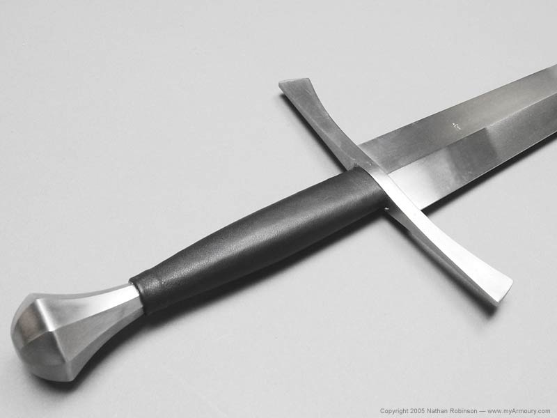

Pommel Detail
Fit and Finish

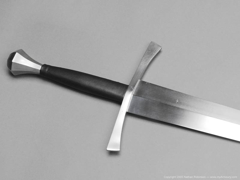

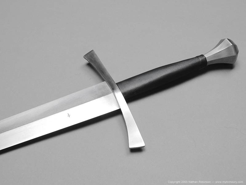

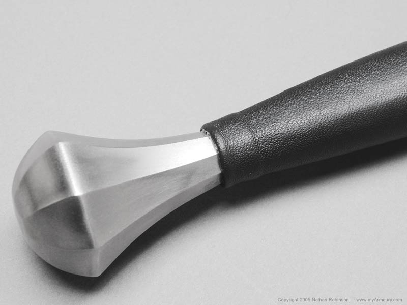

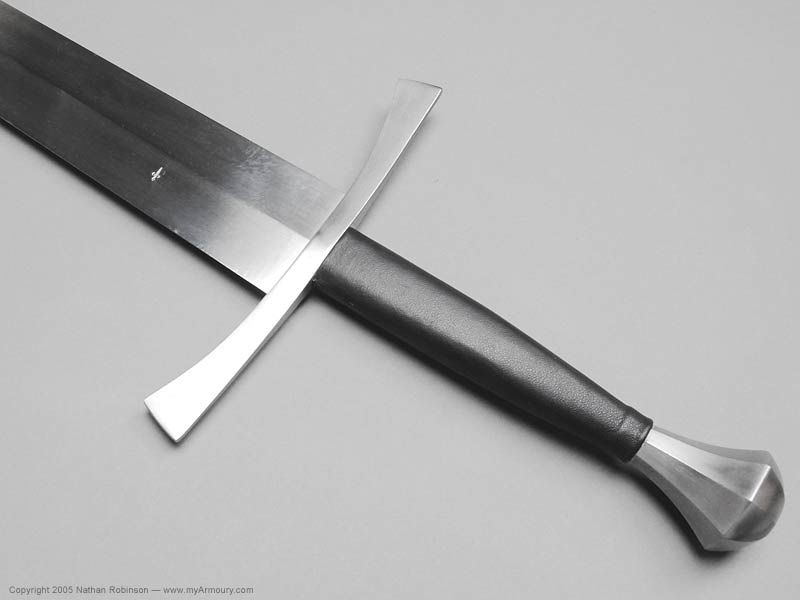

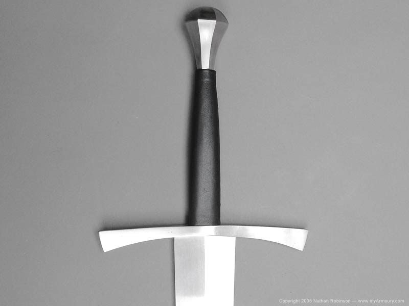

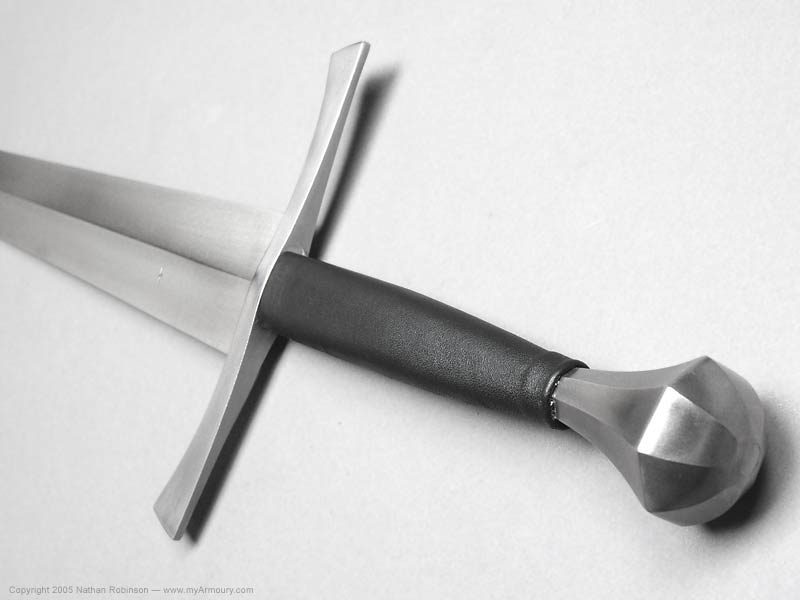

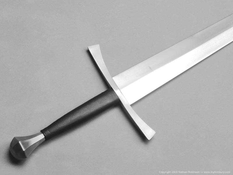

Considering that this sword is intended to fill the role of an economical sword, it is surprisingly attractive. The finish of the blade is slightly better polished than the usual satin finish often seen in blades of this price range. The guard and pommel show very little signs of being cast. The octagonal pommel is very attractive and also feels very comfortable in the hand. The wooden grip is wrapped in black leather with a smooth and even seam. The assembly is rock solid.
Pamela Muir adds these notes:
"As far as fit and finish, my first reaction was, 'Wow, this is supposed to be a "lower end" sword! Nonsense!' I still think she's absolutely gorgeous. The sword is very plain-Jane, but in that school teacher with her hair up in the bun kind of way. You know that the lack of decoration does not disguise the beauty at all. I don't wear much make-up myself and I don't see a need for it on my practice sword either. The look is clean and utilitarian but beautifully made."
