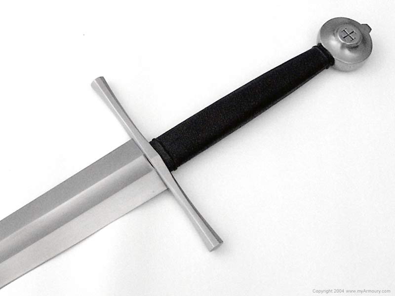

Click to enlarge

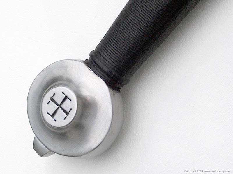

Pommel Detail

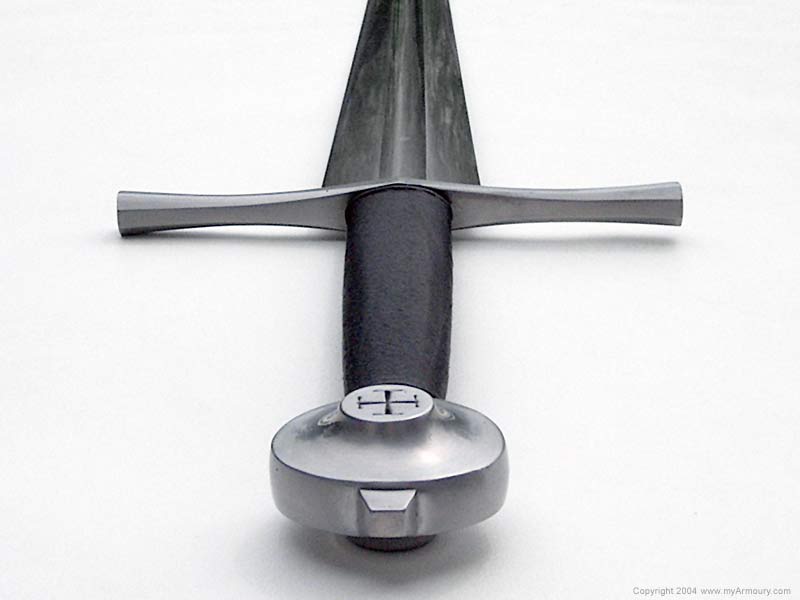

The Baron is a rather austere sword, as are many originals of the period. As with those originals, however, the Baron possesses an austere beauty which is very attractive. The sword's pommel and guard are investment cast from mild steel. The pommel is a variant of a type which Oakeshott labeled a Type K. This style of pommel features a wheel shape with strongly beveled faces that have been hollowed out. This results in a highly raised middle section which lends itself well to decoration. In the Baron's case, the face has been incised with a cross—a nice touch of detail. The pommel is a variant of the standard Type K in that it is not a true wheel. Instead, the pommel possesses a slightly oval shape. This style of pommel was common on this type of sword from the mid-13th to the mid-14th centuries. I personally consider the wheel pommel to be the pommel design for swords of this type and era. The Baron's guard, also of investment cast mild steel, is fashioned in Oakeshott's Type 2. This type is commonly found with square, circular, and octagonal cross sections. Albion has chosen the octagonal style. This is another welcome touch of detail to this Spartan design. Both components are cleanly cast, very nicely finished, and securely mounted.

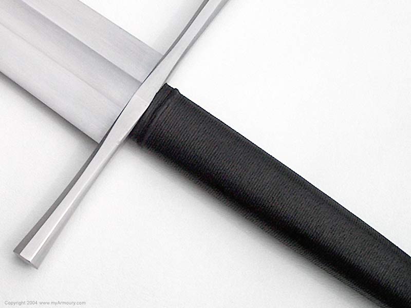

Click to enlarge

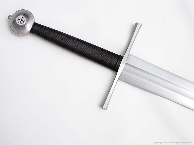

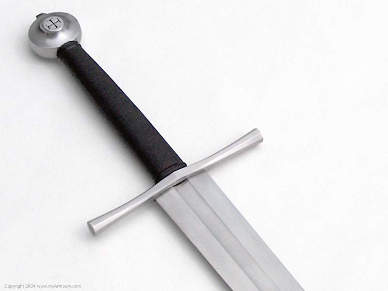

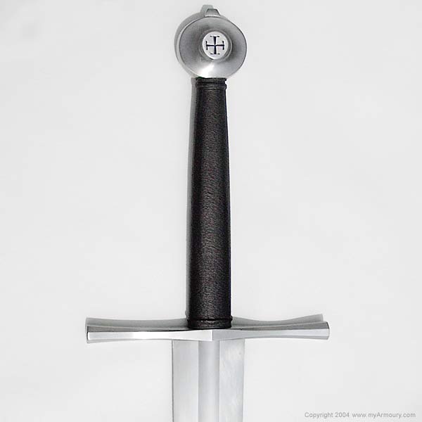

Grip and Cross Detail

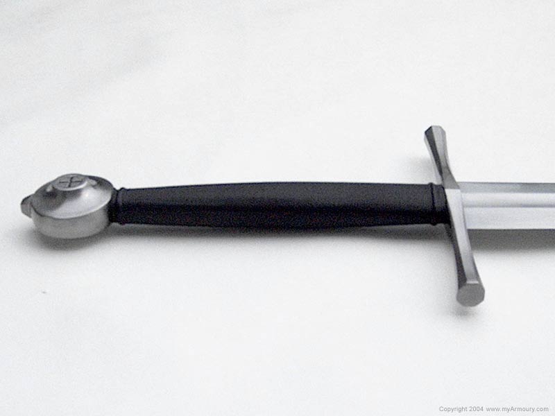

The sword's grip is fashioned from two sections of stabilized birch which have been hollowed out to accept the blade's tang. The grip has been covered with cord and leather, black in color for the latter. The leather covering's seam is almost invisible. Overall the grip is very cleanly done. This is a welcome change from many of the grip coverings commonly in use on the production market. The level of blade finish, which is lenticular in cross-section, is nothing short of excellent. As with the furniture, the blade is finished in a satin finish. This is a very attractive and easy to maintain finish, which is also historically accurate. The finish is evenly applied across the blade's surface as well as the three quarter length fuller, which is precisely machined and very nicely done. There is no discernable secondary bevel upon the edges, which are formed from an acute apple seed shape. The blade is finished off with Albion's Next Generation maker's mark, which has been acid-etched into the blade's fuller.
Chad Arnow, an owner of the Albion Baron sword, makes these observations:
The small fit and finish and small detail work on this sword were unlike any other production-level sword I've ever owned. The blade is shaped very smoothly, showing no ripples or waves in its surface. The fuller is very well-executed, and its end transitions smoothly into the rest of the blade. The blade's edges have no discernable extra bevel. The octagonal cross-section of the guard is very crisply done, and shows the kind of three dimensional properties that are commonly seen on period originals. The grip is quite comfortable and secure, with the cord and leather wrapping. The pommel and cross are very cleanly cast, showing far fewer casting flaws than many other production swords. The pommel tapers in thickness, being thicker toward the hand. This is a nice aesthetic touch, and also should help in terms of mass distribution. The pommel on mine is not quite symmetrical, giving a cast hilt piece a very hand-made look. This adds to the overall feel of a sword much older than it is.
