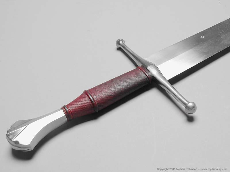

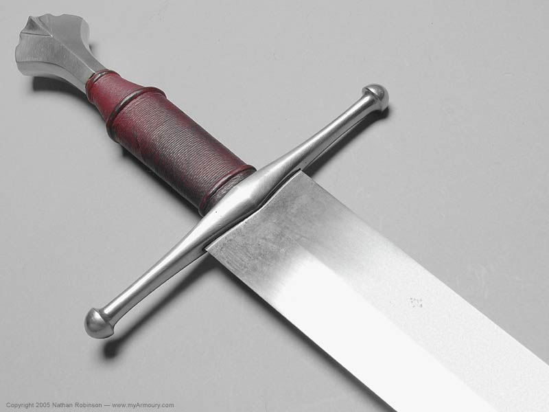

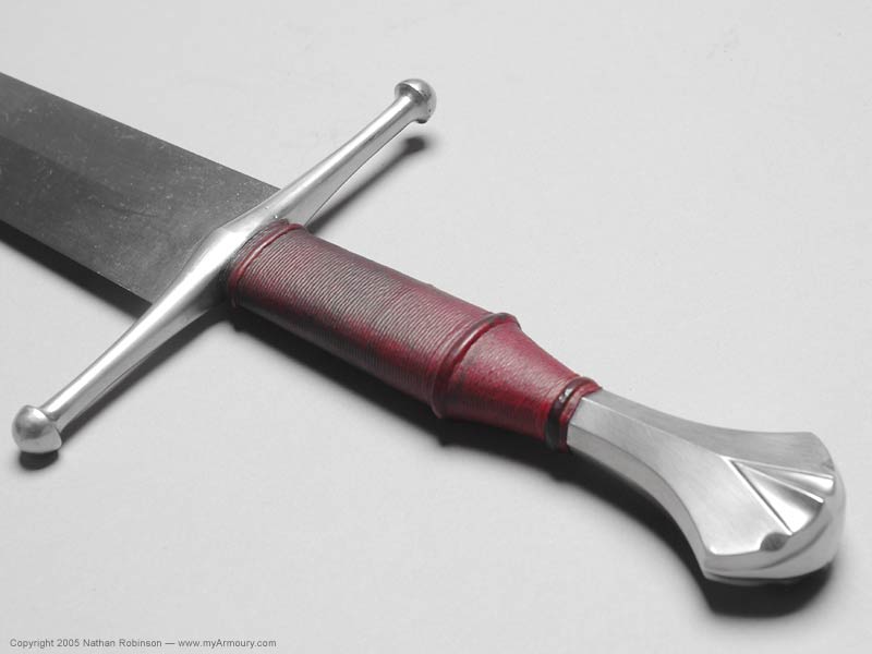

Fit and Finish

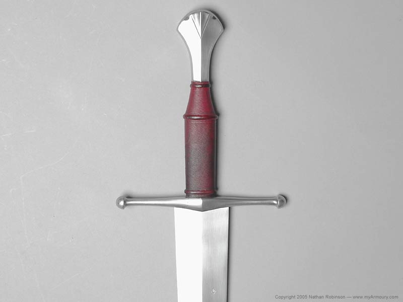

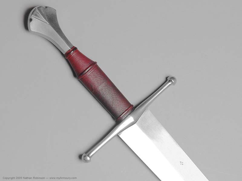

Click to enlarge
Grip and Cross-guard

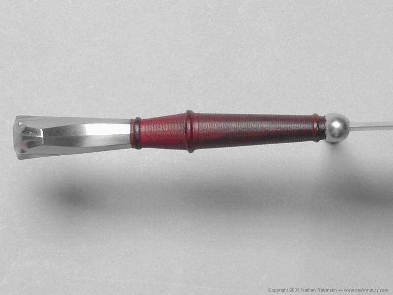

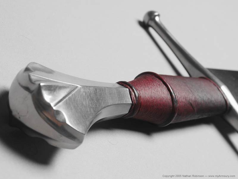

Aesthetically, this sword is wonderful. From the pictures on Albion's Web site, I expected this to be slightly boring in appearance, but up close the fine details really shine through. I have always been a fan of long pommels, and this one is well formed and decorated with flowing yet angular lines. It gives a grace that has a delicate, yet powerful feel to it. The guard has a rounded cross-section that gently varies in thickness to accentuate the blade and the mushroom-shaped finials on the tips.
The blade is well defined, with both a massive and a gentle look to it, combining the broad and strong looking base with the precise and very fine tip.

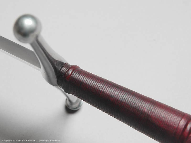

The grip is covered with cord-wrapped leather that Albion calls magenta. Once again, they have created a near seamless wrap. Their leather wraps are among my favorites in terms of being both aesthetically and functionally excellent. That said, I do wish they would say something about the dye colors they use for the leather: I have owned swords from Albion that had oxblood, red, and magenta colored grips. The magenta is what most makers would call oxblood, and seems to be what Albion once called oxblood some time back. The red is also very oxblood-like. The color Albion calls oxblood, however, seems to be more brown. This is something the potential buyer needs to keep in mind before picking one of these three colors.
