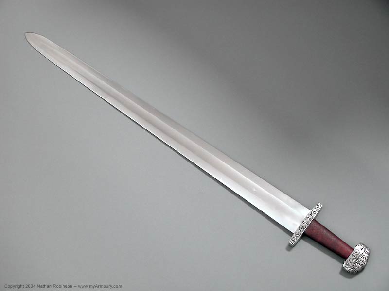

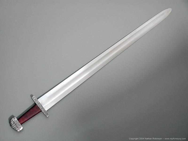

Albion Armourers has created this sword largely inspired by the Ballinderry sword in the National Museum of Ireland. While intended to be a general representation of a good Viking styled weapon, and not an exact replica of the original, the hilt and its engravings are remarkably close. The blade is an Oakeshott Type X, or could also be classified as a Geibig Type 2. The five lobed pommel and straight guard puts the hilt into the Peterson Type K category.
Click to enlarge
Weight:2 pounds, 5 ounces
Overall length:36 inches
Blade length:30 1/2 inches
Blade width:2 1/8 inches at base, tapering to 1 1/2 inch
Grip length:3 5/8 inches
Guard width:4 inches
Point of Balance:6 1/2 inches from guard
Center of Percussion:~20 inches from guard

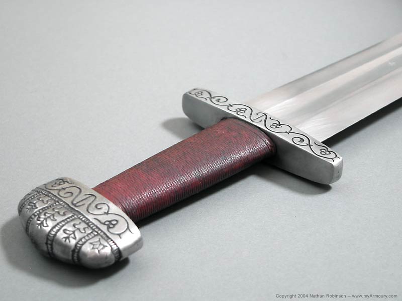

Fit and Finish
Click to enlarge

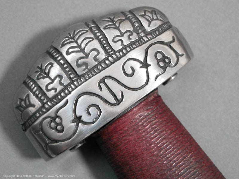

Engraving Detail
Click to enlarge
Pommel Rivets

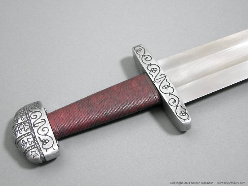

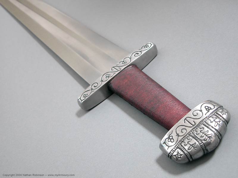

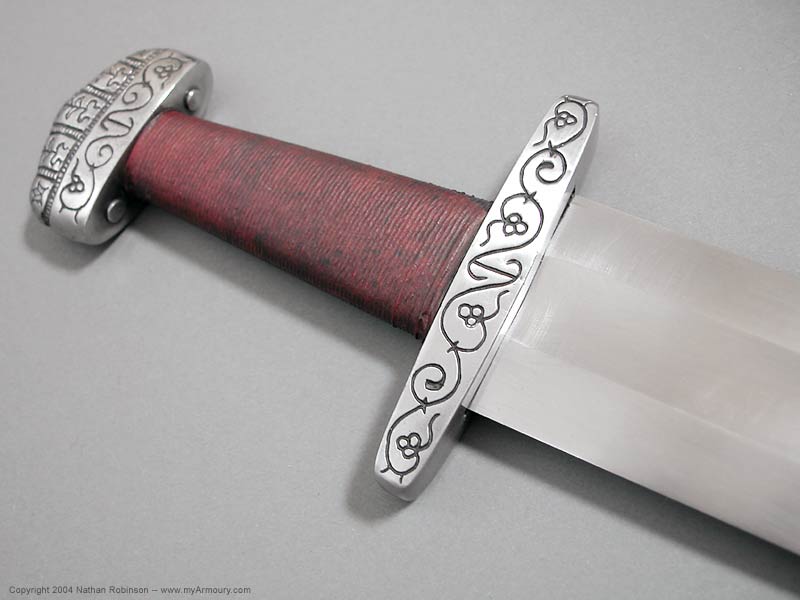

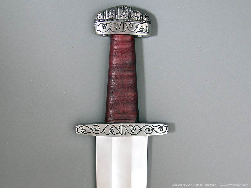

In a word, this sword looks superb. The entire piece feels rock solid, and the aesthetics of the sword are excellent. The blade exhibits no wavering and has smooth, clean lines. The fuller gently flows up the blade, and the polish is very even, almost up to a mirror finish, though not quite, which makes the sword appear majestic without looking like cheap stainless steel knock offs. The engravings in the hilt appear to be vine-like, or of some sort of botanical theme, and are crisp and well-defined. The pommel lobes are separated with a roped engraving intended to look like twisted wire. Some original pommels had twisted wire in between the lobes, and it would have made the sword cost more should this have been done. The current "faux" wire still looks attractive nonetheless.

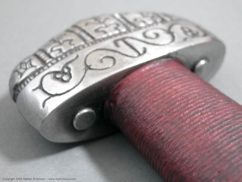

One very interesting detail is the added rivets on the underside of the pommel. Many authentic Viking swords have a two-piece pommel design held together by such rivets. While the rivets on this replica only simulate this construction method, each one is individually added to the hilt by hammering them in. This is a particularly good example of the attention to detail present in the Next Gen line.
This particular sword has a grip of oxblood-colored leather over finely twisted cording. The grip is very tight, and it feels good in the hand with enough texture so that it is not slippery. Even more amazing is that the wrap is almost seamless: It is only if you look very close that you can barely see where the line of the seam blends in.
