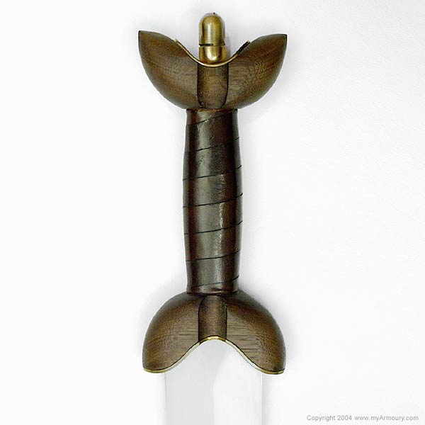

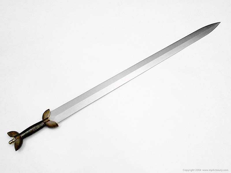

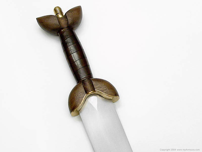

Albion Armorers has recreated a sword named after the famous find site of La Tene in Switzerland where dozens of Celtic swords were found preserved at the bottom of Lake Neuchatel. This particular sword is designated a La Tene II or Middle La Tene—that is, it is typical of Celtic swords throughout Europe in the La Tene II period. This period roughly dates from 250 BC to about 100 BC. The blade style recreated here would be particularly fitting for the Second Punic War era.
Click to enlarge
Weight:1 pound, 14 ounces
Overall length:34 1/2 inches
Blade length:28 1/2 inches
Blade width:1.9 inches at base
Grip length:3 1/2 inches
Guard width:2 3/4 inches
Point of Balance:7 3/4 inches from guard
Center of Percussion:~20 1/4 inches from guard

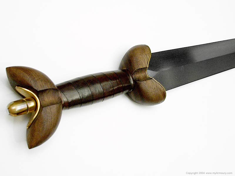

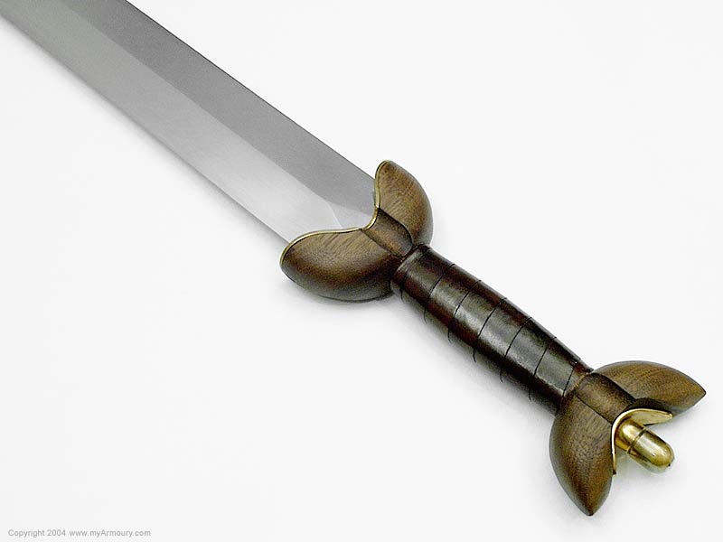

Click to enlarge

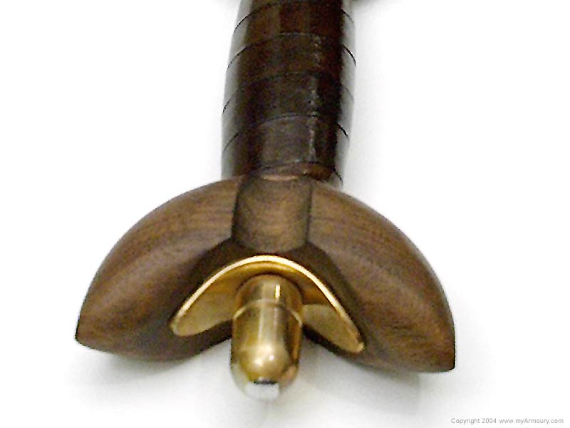

Detail of Pommel
According to the author's references on Celtic arms and armour, there are some differences between Albion's sword and more "typical" examples that may be worth noting. The bullet-shaped bronze finial atop the pommel would more likely be a small, round, domed washer of iron, which would also replace the current shaped pommel plate. Some pommel caps exist on extant La Tene II swords, but from the pictures the author has seen, these take the form of a small iron (or bronze) sphere. The shape of the guard and pommel were more likely to be more lobed and rounded instead of being pointy at their edges. The current shape is quite possible, given that most La Tene sword finds simply have a bare tang, hilt plate, and pommel button; however, the author simply knows of no period depiction illustrating an appearance that is quite so pointy in the pommel. In fact, Albion's first incarnation of the sword seems more on-target with historical evidence. From what we know, the grips of period swords were typically bored-through cylinders of wood or bone, made of a single piece.
Obviously, these differences are all mainly aesthetic, and don't affect the overall fit, finish and handling of the sword. Even given the minor quibbles the author has noted, the overall appearance is visually striking, and the sword is easily identifiable as a version of the La Tene II sword.

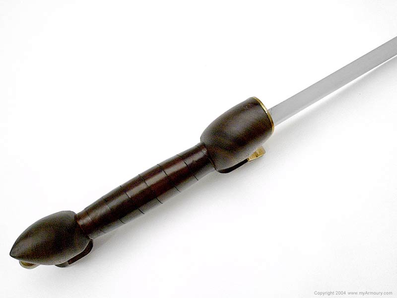

Click to enlarge

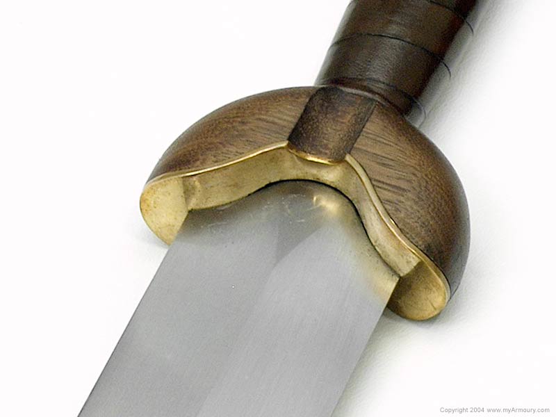

Underside of Guard

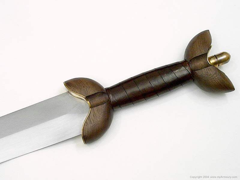

Fit and Finish
The carving of the wood on the hilt components is very nicely done, and the fit between the wood parts and bronze plates is generally very good. The spiral-wrapped leather-covered wooden grip is executed well. The peening at the end of the bronze dome is also cleanly done. The blade's finish has been taken to an attractive satin polish by the craftspeople at Albion. Minor finishing issues are a slight gap between the bronze plate and blade shoulder, a very slight wandering of the center line near the blade's tip, and slight asymmetry of the edges of the blade where it curves to the point.

With its mostly wooden hilt components, it is no surprise that this sword is weighted like a cutter, having a great deal of blade presence. The 50% distal taper of the blade does help keep the blade presence from being overwhelming. This sword should have decent thrusting ability due to its diamond cross-section, though that ability will always be secondary to its ability in the cut. The blade actually flexes very little, which made it difficult to calculate the COP using the tried-and-true pommel slap test. The smoothness of the spiral wrap does not add to the tactility of the grip, but doesn't detract from it either. Even after working up a minor sweat while cutting, the grip did not become slippery. Cutting was easy with this sword. Its short length and distribution of weight make it well-suited to short chops.
Conclusion
The sword is solidly constructed and handles well. The Roman and Celtic swords in Albion's First Generation Albion Mark swords have filled a void in the production sword market. To the author's knowledge, the Albion Celtic La Tene II is the only production La Tene II sword that offers a good level of historical accuracy, appropriate weight, balance and handling, and high functionality. The price point of the Albion Armorers First Generation swords makes this a very attractive option for people interested in Celtic history.
