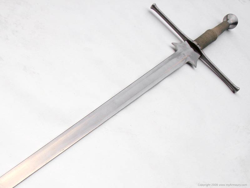

By the 16th century, the longsword was not a common weapon for either military or civilian usage. Despite this it remained in the fencing schools of the day as both a weapon of tradition as well as a weapon of sport. Within Meyer's treatise, much like many other German fencing manuals, the fencers practice with longsword "foils". These practice swords have the general form of a sharpened longsword, but are blunt with a rounded point. Further, these swords have characteristic "winged" ricasso areas, known as the schilt (shield). This type of sword is often erroneously referred to as a federschwert (feather sword), though this is an inaccurate term, and there is no evidence that such swords were ever called this in period. Nonetheless, the style of sword itself seems to have been quite popular for training from as far back as at least the 15th century, where the type can be seen in period iconography.

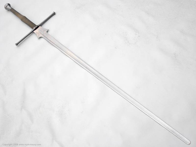

Because these practice swords seem to have been commonly used in period, it seems only fitting that modern practitioners would want to use similar designs as well. The particular model being reviewed here was created by Albion Armorers and is named the Meyer. It is part of their Maestro Line, a line of purpose-built practice swords for western martial arts partner training.

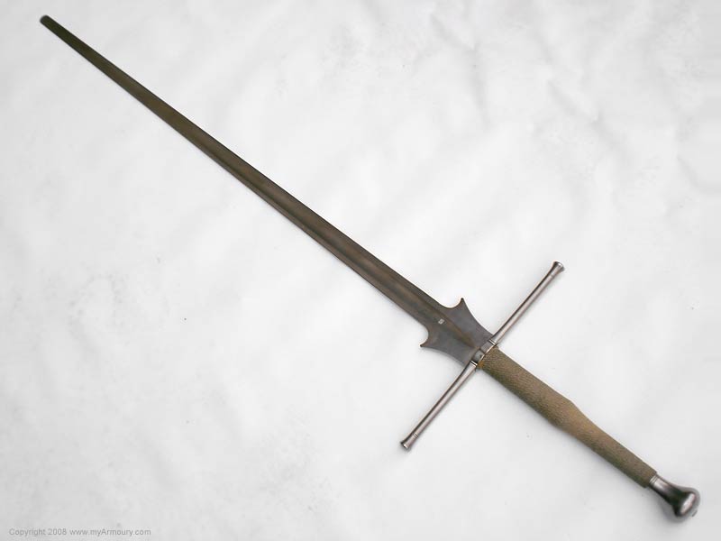

Click to enlarge
Weight:3 pounds, 3 ounces
Overall length:48 inches
Blade length:36 3/4 inches
Blade width:2 inches at base, tapering to 11/16 inch
Grip length:8 5/8 inches
Guard width:11 inches
Point of Balance:3 1/2 inches from guard
Center of Percussion:~23 3/4 inches from guard
Oakeshott typology:Type T3 pommel, Style 11 guard

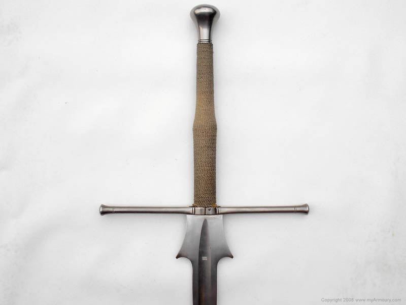

Click to enlarge

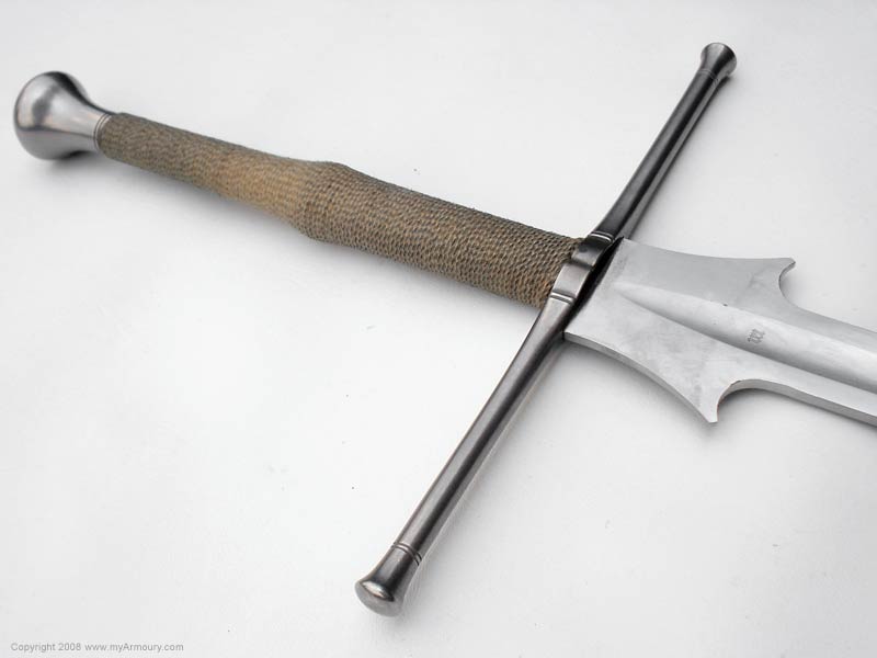

The flared ricasso

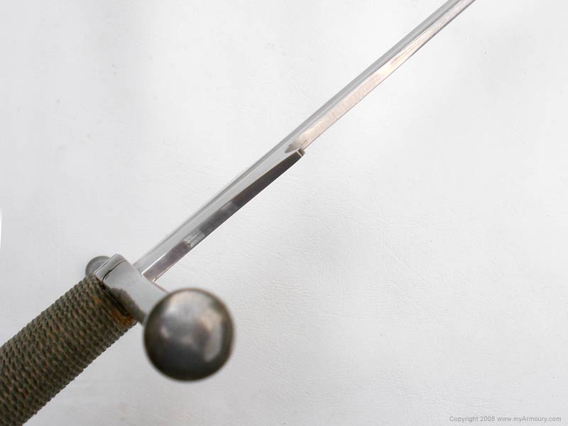

Click to enlarge
Blade thickness
at ricasso

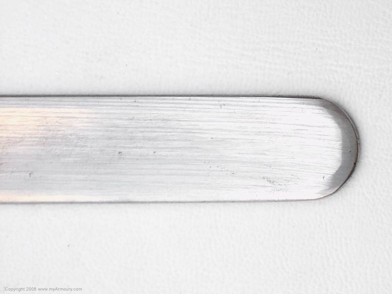

Click to enlarge
Rounded blade tip

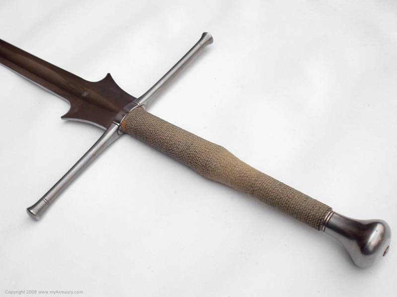

The Meyer has a long grip that really facilitates quick controlled cuts that can easily be reversed. Whether a practitioner is a student of Liechtenauer, Fiore, or any other historical sword master, the actions can be made with clean, sharp movements. At the same time, the long grip allows actions to be halted very easily, which is never a bad thing when it comes to safely practicing with a partner.

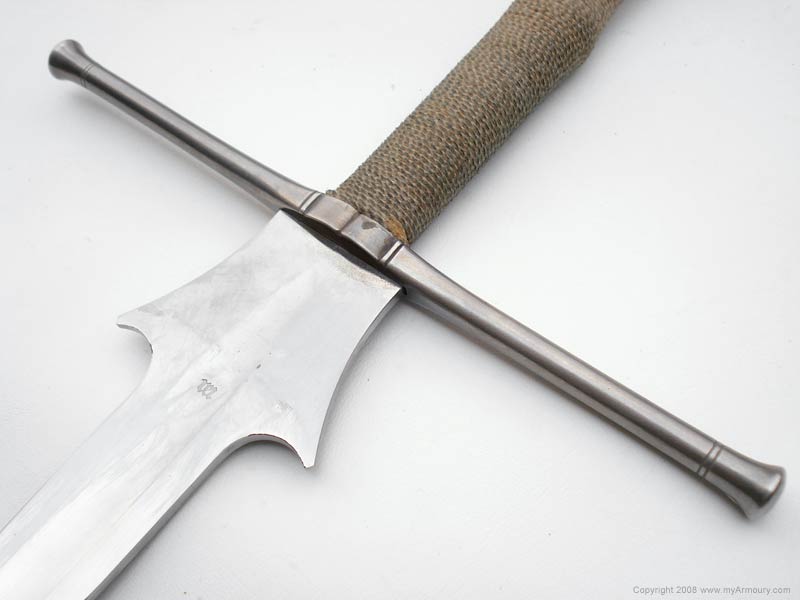

The cross is long, and this can be considered positive or negative, depending on your viewpoint. It is about the length of my forearm, a length that the 15th century master Filipo Vadi recommended for a sword intended to fight in armour. I am a tall person at 6' 2", and I have not found this guard to get in the way at all. In fact, I have found it to be very protective. On the other hand, a shorter fencer may find it more problematic. I can imagine it bumping the forearms of someone with shorter arms than myself, so this should be taken into consideration before purchasing. The finials are rounded, so even if it did bump you on occasion there is little worry of injury.
The strong of the blade (the half nearest the hilt) is quite rigid, but the weak of the blade (the half nearest the point) tapers drastically to give a very flexible thrusting tip. Thrusts are safe without making the blade "whippy" or unrealistic, yet the heat-treat allows it to keep returning straight. It also has nice, wide edges that are rounded at the corners. When drilling and fencing against other blunted longswords, the Meyer suffered little more than minor surface scuffing. The Meyer even started to damage some cheaper sword blades.

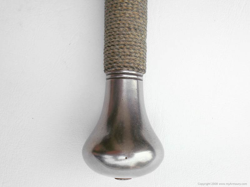

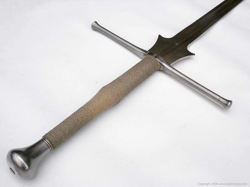

One minor issue that appeared immediately was that I could just barely feel a slight "click" in the pommel during strikes. It was barely noticeable, but if I forcibly attempted to move the pommel around I could feel it. After over a year of using this sword several hours a week, this never became an issue. I suspect that my sword has a very slight space between the pommel and tang, which so far has not affected performance at all, nor has it gotten any worse. Five of my students use this same model regularly, and none of them has experienced this problem. I have also handled a few other samples that did not have this issue, so I suspect it was only my sword, and as I said, it is barely noteworthy. I didn't even bother contacting Albion about it since it was so insignificant.

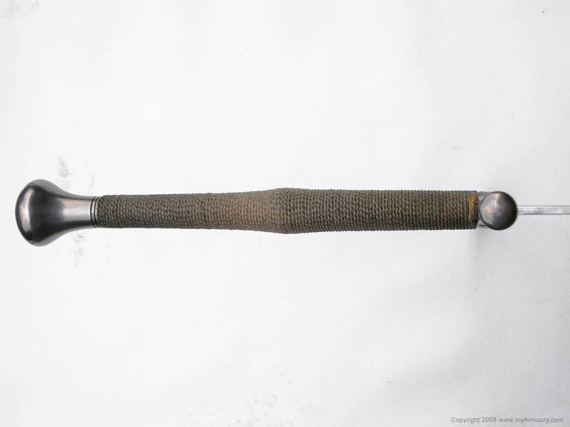

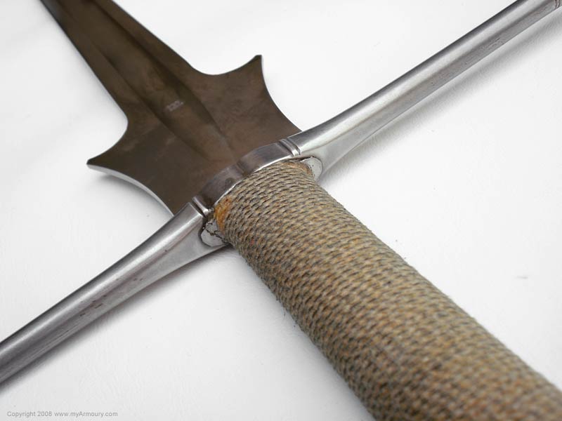

Click to enlarge
Grip detail
Click to enlarge
Pommel detail

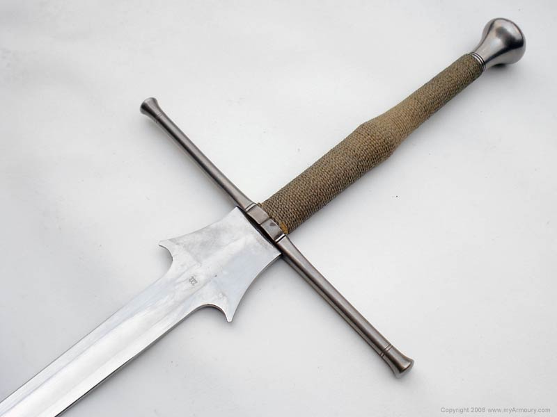

The very first thing that came out of my mouth when seeing one of these swords up close was, "That is far prettier than a practice sword has the right to be." The sword really embodies the look of a fencing master's prize training tool. The general look matches the beautiful illustrations of Renaissance fencing treatises, including that of its namesake. At the same time, it also captures elements of high quality swords that were meant for actual combat. The subtle shaping and details of the guard could just as easily pass for any of Albion's more expensive sharpened swords.
While the blade is high carbon steel, the guard and pommel are stainless steel with a brushed finish. This may or may not be a good thing, depending on your intent with a training weapon. For me this is a huge plus, as my practice sword fittings usually end up a brown-black color from corrosion as I am constantly holding them with my sweaty hands. Even with a quick clean up after use, they often end up dirty very soon afterwards. Having stainless steel fittings is a very nice way to prevent this, and the brushed finish keeps the material from being too obvious.
The grip is wrapped with heavy hemp cord. The cord is a little rough on the bare hands if you are not used to it, but otherwise provides excellent traction. It is also very sturdy. Occasionally a partner's sword may accidentally hit the grip, and so far this has not seen more than minor markings. Leather wraps are generally more prone to tearing. I do wonder, though, if the entire wrap would need to be replaced if the cord does eventually tear, but so far I doubt this will be a concern for quite a long time.
