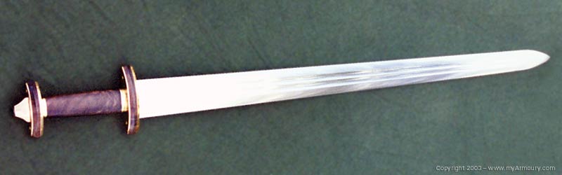

Weight:1 pound, 12 ounces
Overall length:34.5 inches
Blade length:29 inches
Profile taper:2 inches at base tapering to 1.3 inches
Distal taper:.212 inch at base tapering to .96 inch
Point of Balance:7.25 inches from guard
Center of Percussion:~20.5 inches from guard

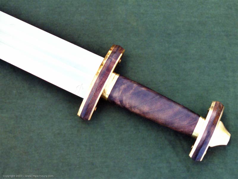

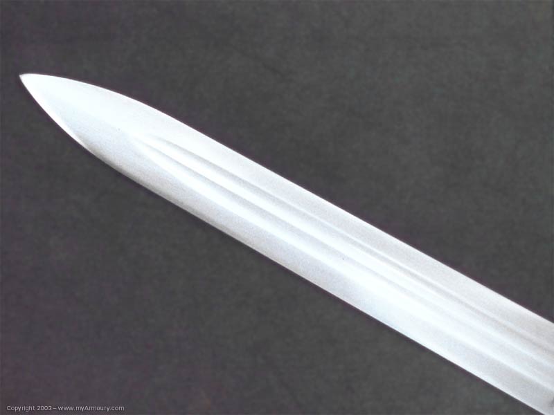

Albion's Type D exhibits a high level of fit and finish throughout its construction, and has been designed using historic information supplied by swordsmith Peter Johnsson. The blade is finished with a very pleasing satin sheen, which is attractive as well as being very practical. The blade also features a twin fullered design, which was quite common from the Bronze Age. This design fell out of general use after the Migration Era, and did not reappear until the high Middle Ages. The blade's edge exhibits a strong geometry, which would have given good service against the armor of the period.

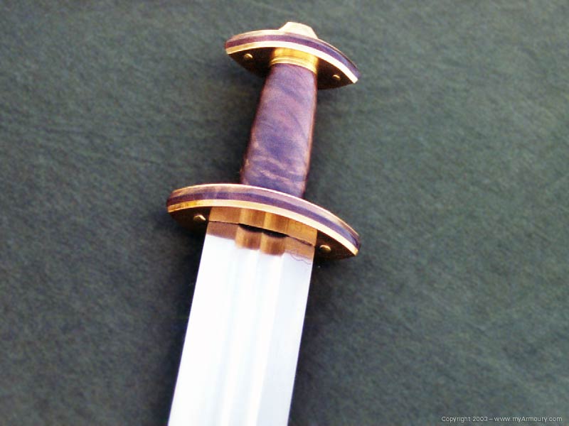

Side View of the Grip
The sword's hilt is really the most striking feature aesthetically, and was my only cause for concern. My initial concern when ordering this sword was the hilt's lack of ornamentation. As has been previously stated, swords were not considered a commoner's weapon during the Migration Era. As such, surviving examples tend to be rather elaborate in their ornamentation. In order to keep the sword affordable, Albion elected to manufacture a hilt without this elaboration. I had originally thought of using a bone grip as a way to add detail and contrast to the sword's hilt. While discussing the project with Albion's head cutler Eric McHugh, it was decided that a grip made from bone presented too many design limitations. Apparently there are only so many ways that bone can be worked so as to yield a functional sword grip. Eric suggested that walnut burl be substituted for the standard walnut normally used in this sword. Eric felt that the burl would add the level of detail and contrast that I was looking for. Judging from the end result I would say that he was right.
Note: The use of materials such as walnut burl are strictly subject to issues of supply and the time involved in the manufacturing process. Any questions involving pricing and availability should be directed to Albion's customer service department.

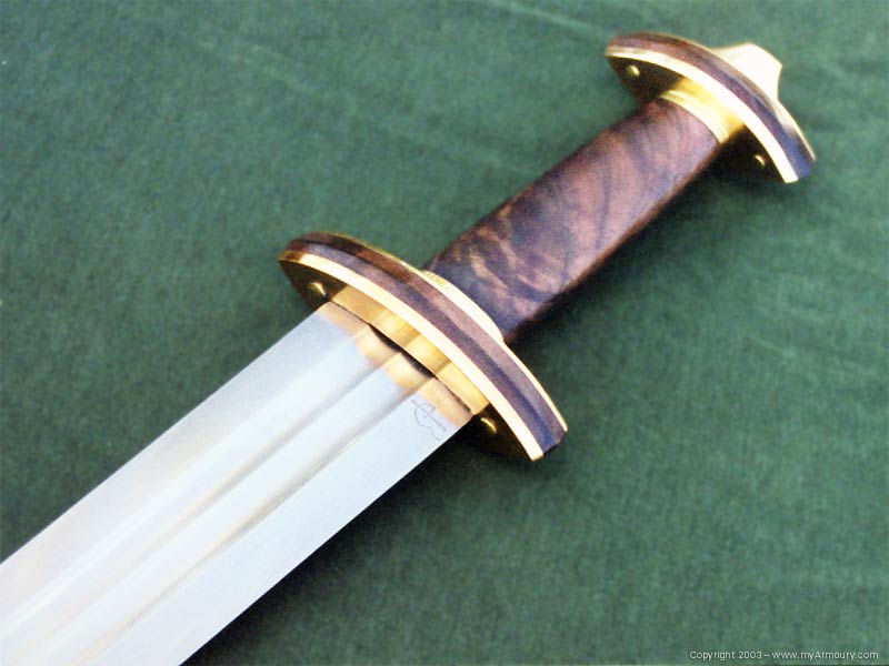

The Hilt

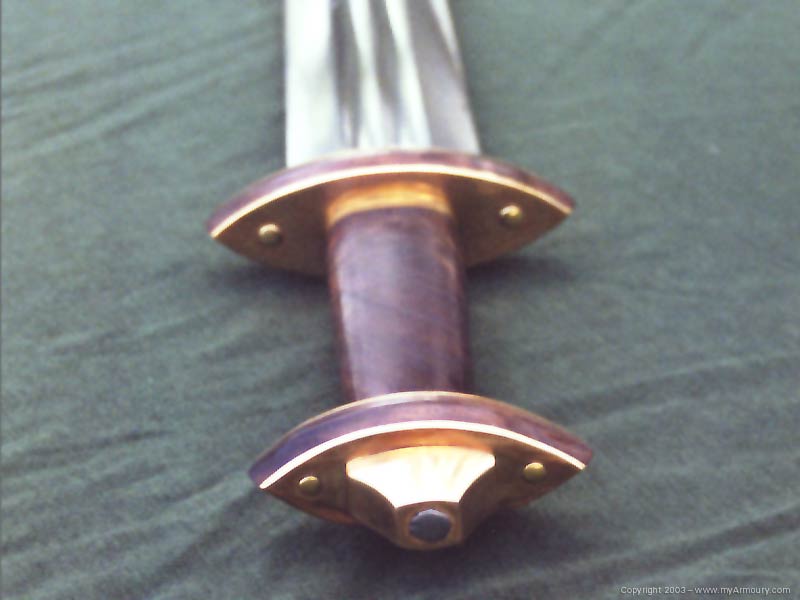

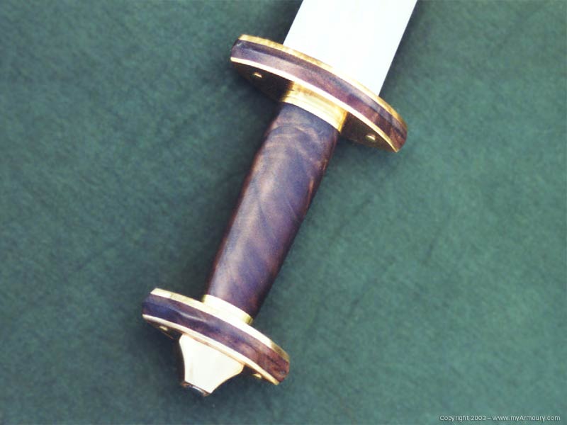

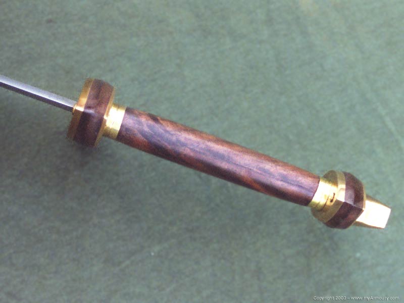

The sword's hilt is constructed in the traditional fashion of the Migration Era. The upper and lower guards are assembled from a composite of wood and bronze. A wooden plate is sandwiched between two bronze plates, and two pins that are riveted into place secure the assembly. The grip's construction departs from the method found in most modern replicas. Instead of using a solid piece of wood, bored through to accept the blade's tang, a two-piece construction is used. Two panels of wood are hollowed out to accept the tang. The two pieces are then glued together and held into place by two bronze ferrules. This is a much more common method of construction throughout the Migration Era, and up through the Middle Ages. A small pommel cap of "cocked hat" design then secures the assembly. The one ahistoric detail of the hilt's construction lies with this pommel cap. The cap is threaded and peened into place. The more correct method would be to peen the tang's end over the upper guard, and then secure the pommel cap over it with two pins. This would have complicated the assembly, and as such would have increased the sword's price. This was a conscious choice made by the Albion staff so as to keep the sword within an affordable price point. Given the sword's other historic details, I personally find this design change to be perfectly acceptable.
One of the difficulties found in assembling Migration Era designs lies in their composite hilt construction. When assembling and finishing the various components, it is found that the different materials respond to grinding and sanding at different rates. Wood or bone will be removed quicker than bronze or steel. As such, a lot of attention must be given during the assembly process. Close examination of the sword's hilt will show that Albion paid the bill in full in this department. The fit of all of the various components is perfect. I could find no gaps or overlapping in the sword's assembly. Everything is put together in a firm and secure fashion.
