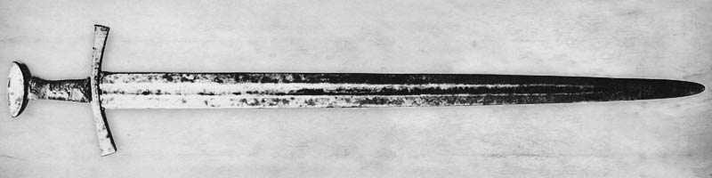

The antique Saint Maurice of Turin sword, circa 1200-1250
A sword housed in Turin is one of them. It is purported to be the sword used to behead St. Maurice, though this is obviously a sword of the early 13th century, and not the 3-4th century. This misnomer is reminiscent of the anachronistic depiction of Biblical stories in the Maciejowski Bible (also 13th century), as it was the custom in the high medieval times to relay stories of ancient times from a contemporary point of view, using current dress, arms, and armour. As a result, a "modern" sword was attributed to an event that occurred nearly 1,000 years earlier. Whether this sword had been dedicated to the cult of St. Maurice (and then assumed to be the sword of St. Maurice) or a deliberate fabrication is unknown, but it was kept with the other relics of the saint. Since 1858 this sword has been displayed in the Real Armerķa in Turin. Along with St. Dunstan and Michael the Archangel, St. Maurice is the patron saint of swordsmiths.
Ewart Oakeshott classified the Sword of St. Maurice of Turin (SOSMT) as a Type XII. It is large for a dedicated single-handed sword, though it is well within the known variations for this type. It is of similar size to the sword found in the tomb of King Sancho IV of Castile1 (d. 1298). The sword of King Sancho IV, along with the sword of his brother2 who died in 1270, sets a firm known date of the Type XII as the last half of the 13th century. However, there are some examples that fit this type found in the Winchester Bible (circa 1170), though the swords are vaguely depicted. The Type XII is also found in monumental sculpture from 1200-1280, being the most depicted sword during this era. In The Sword in the Age of Chivalry, Ewart Oakeshott notes that the SOSMT is difficult to classify. The wide fuller is nearly three-quarters the length of the lenticular blade, and while it is within the variation for this type, it could be argued that this blade is nearly a Type X as it exceeds the usual two-third fuller length typical for this type. The Brazil nut pommel is common to the 11-12th centuries and was popular on Type Xs of the period. The cross cannot be definitively dated, as this style was in use through the latter half of the 15th century, and early examples are noted on Scandinavian examples from the early 11th century. However, as has been the case more than once, swords have been classified and then reclassified as the typology has evolved. As the typology provides general guidelines, Oakeshott decided that the SOSMT has more characteristics in common with a sword of Type XII than of Type X.

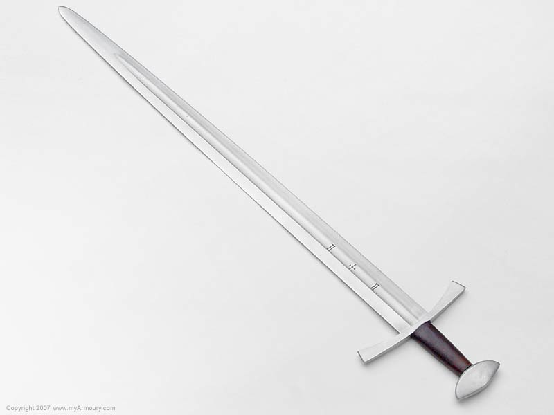

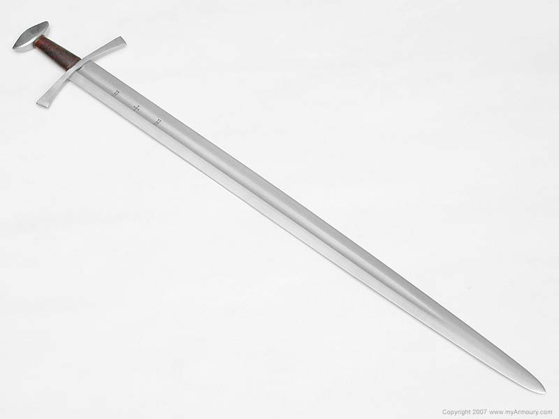

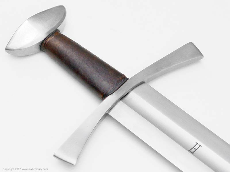

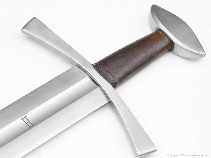

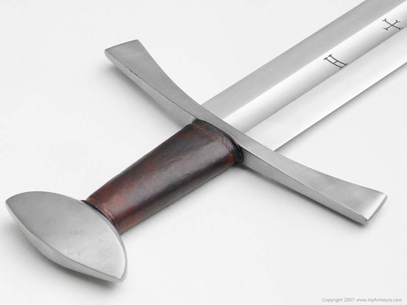

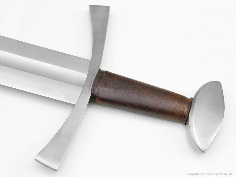

Upon examining this sword it is evident that it is meant to be a working sword without the frills or "bells and whistles" of a ceremonial or dress sword. That said, it still has appeal due to the clean lines and simplicity of its construction. The Sword of St. Maurice of Turin is a visually imposing sword. The wide, long blade and simple cross and pommel suggest authority.

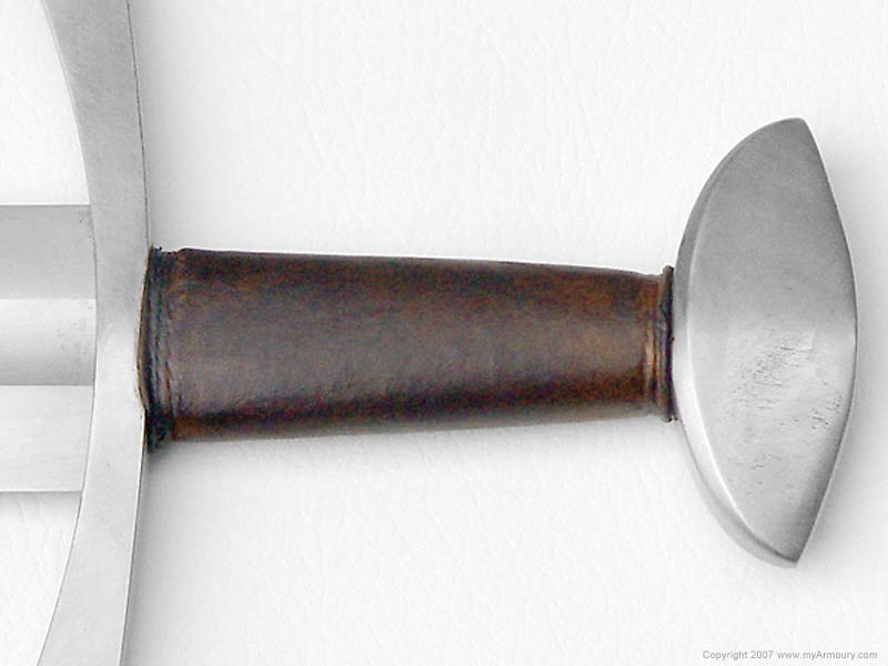

Grip detail

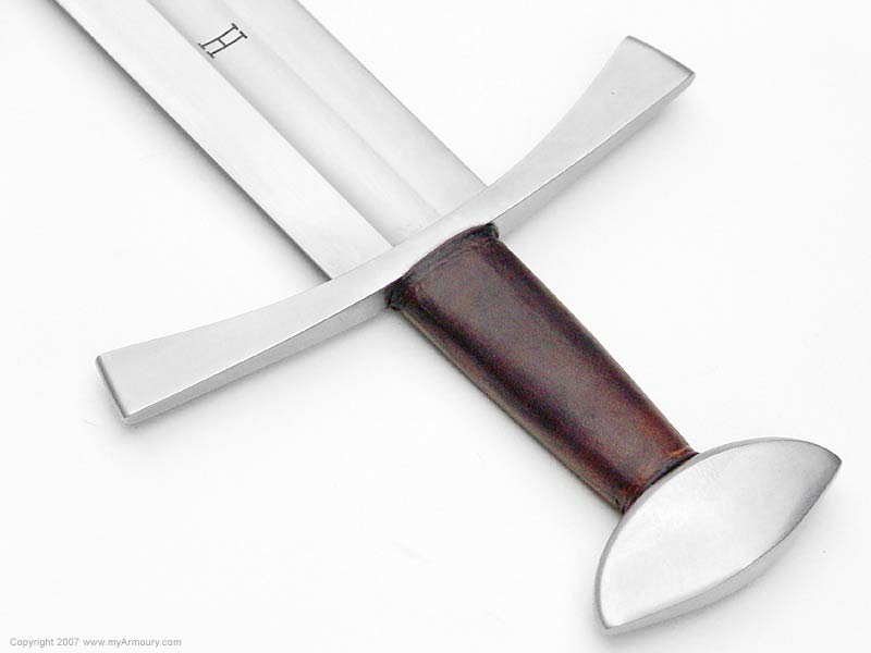

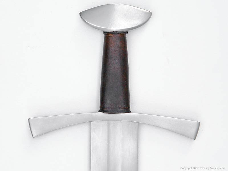

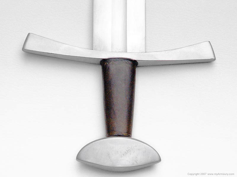

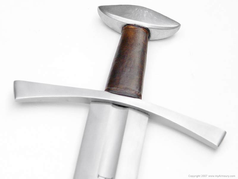

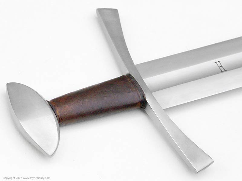

The pommel and cross are investment cast of mild steel with a satin finish and are tightly fitted to the tang. While the pommel and cross have a nice crisp look to them, all of the edges have been slightly rounded to take away all sharp edges. The pommel is an Oakeshott Type A "Brazil-nut", though I note that it has a "flatter" face than the Type A found on Albion's Gaddhjalt sword. The tang is peened over the pommel and then ground smooth and flat, with the peen being visible only upon close inspection. The Oakeshott Type 6 curved cross differs from the original in that in this representation it is symmetrical and cleanly executed. As noted above, the original's cross has one arm slightly bent out of true. While this could be argued to be damage from the working life of the sword (or a very careless caretaker), it was decided to reproduce the SOSMT as it would have appeared when new and not include this feature.
The grip differs from the typical reproduction sword on the market today in that it does not have a simple leather-covered wooden core. The typical production blade will have either a wooden core hammered onto the tang as one piece or sandwiched around the tang after the pommel and cross are in place, then wrapped with leather. Instead, the SOSMT has a triple layer wrapping of linen around the stabilized birch core that is then covered in leather. This feature is based upon research with the original sword. Peter Johnsson noted that the original grip has a textile that had been glued or shellacked to the wooden core. Upon close examination, he determined that the grip in its current form would not have held up to the wear and tear of a working sword, and the textile covering may have been the base for a more durable outer covering now lost. Albion decided to recreate the SOSMT with this in mind. The grip is covered with fine leather that is then treated with beeswax. It was decided not to dye the leather but to leave it with its natural color, which will darken and develop a pleasing patina with time and the effects of sunlight.

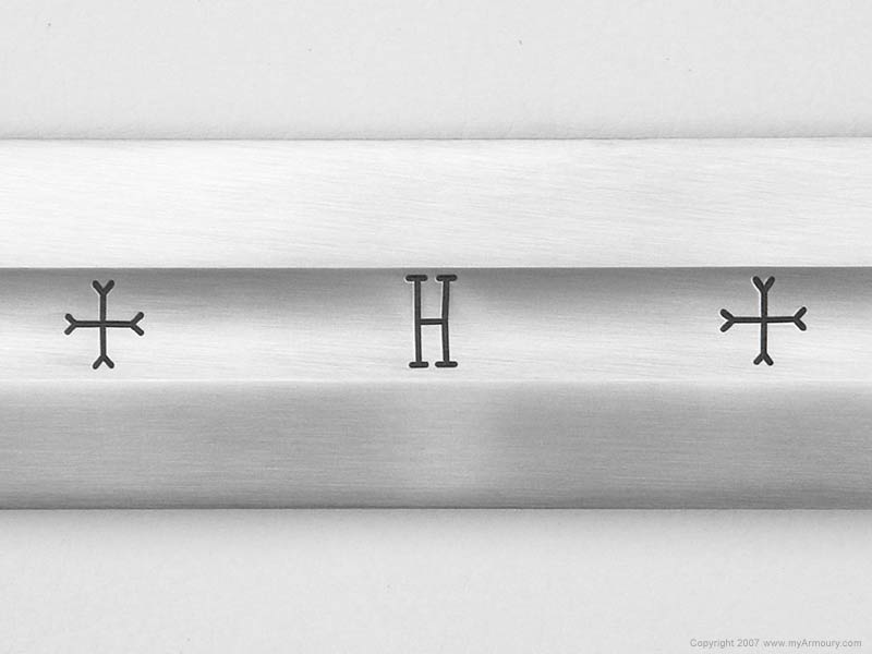

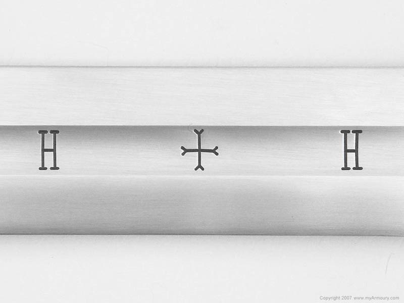

The finish of the blade is of particular note as well. The sword has a well-defined fuller that shows evenness and symmetry along its length. However well the blade and fuller are executed by Steve Fisher, Albion's CAD designer and CNC programmer, what draws the eye to the blade are the engravings. In matching the original, there are engravings on both sides of the blade in the fuller: H+H on one side and +H+ on the other, a religious invocation of some kind, perhaps a reference to the Holy Trinity. Steve and Peter worked closely to make sure that the engravings do not have the crispness and sterility of computer-driven technology, but the slight unevenness of the lettering in the original, which Peter describes as "well-developed handwriting that has been done with some haste." Even though the lettering is ultimately engraved by the CNC machine, I believe they reached their intended goal of making the letters look as if they had been engraved by a human hand.
