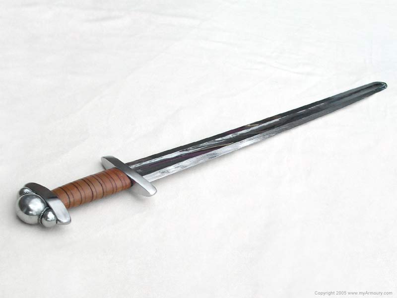

Weight:2 pounds, 8 ounces
Overall length:37 1/2 inches
Blade length:31 inches
Blade width:1 15/16 inches at base, tapering to 1 1/2 inches
Grip length:4 inches
Guard width:3 3/4 inches
Point of Balance:4 inches from guard
Center of Percussion:~20 1/2 inches from guard
Oakeshott typology:Type X blade
Replica created by Vladimir Cervenka of the Czech Republic.

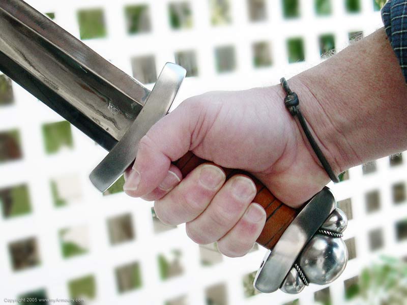

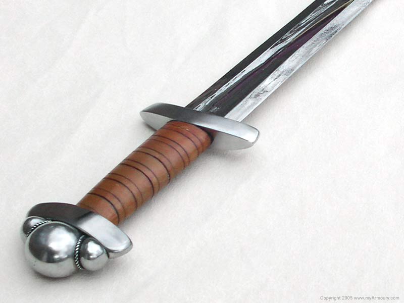

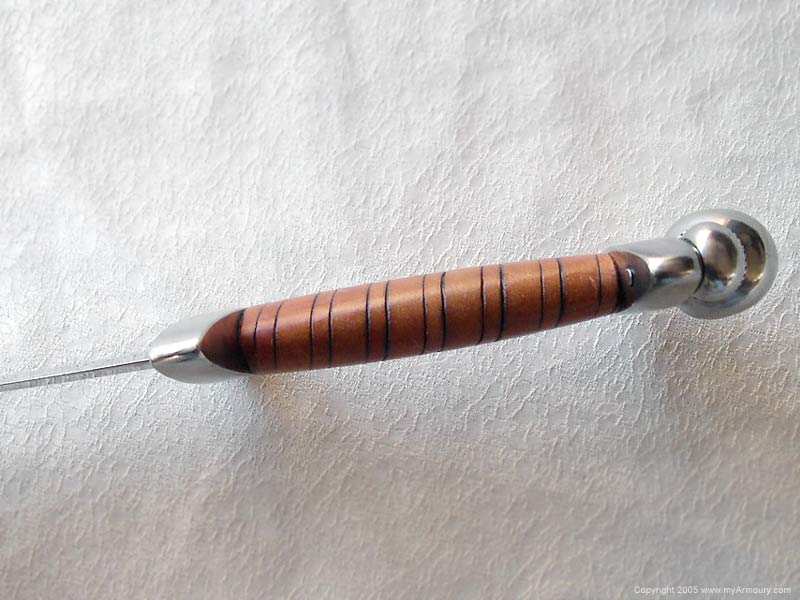

This Cervenka Viking sword feels very nice in hand. It balances more toward the hilt than most Viking swords, however it is well within historical limits. As with other Viking swords, the Oakeshott Type X blade is designed for cutting, not thrusting. The curvature of the wide tip allows for slicing tip cuts. The slight curvature of the guards gives just enough room for the hand to transition easily from the "hammer" grip to the "handshake" grip. The pronounced distal taper makes the blade lively enough for good control and placement, and the thin edge geometry produces very clean cuts through soft targets. I suspect that this sword would have been less effective against mail armour that would have been seen on the battlefield. The pronounced distal taper would take critical inertia out of the blade producing shallower cuts and the thin edge would be more likely to roll or chip. Tom Carr, a fellow collector, appreciated its handling qualities, saying "It just coasts across your palm in a hand shake grip but is rounded enough in the hammer grip to not be uncomfortable when a full swing is taken. The weight and balance is very nice—just blade-heavy enough to cut deeply but light enough to be very agile! The heavy stocky pommel is very well executed and the twisted wire in the creases just adds to the authentic look of the sword as a whole. Now if it was only pattern-welded!"
The grip has a slight bulge in the center that naturally fills the hollow of the palm. However, for my hand, it seems just a bit oversized.

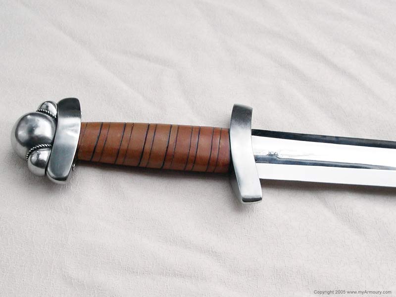

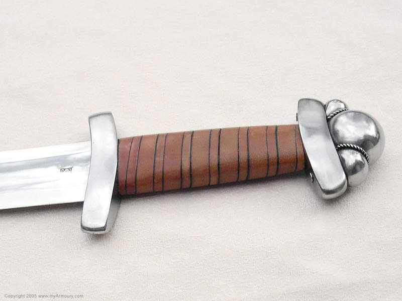

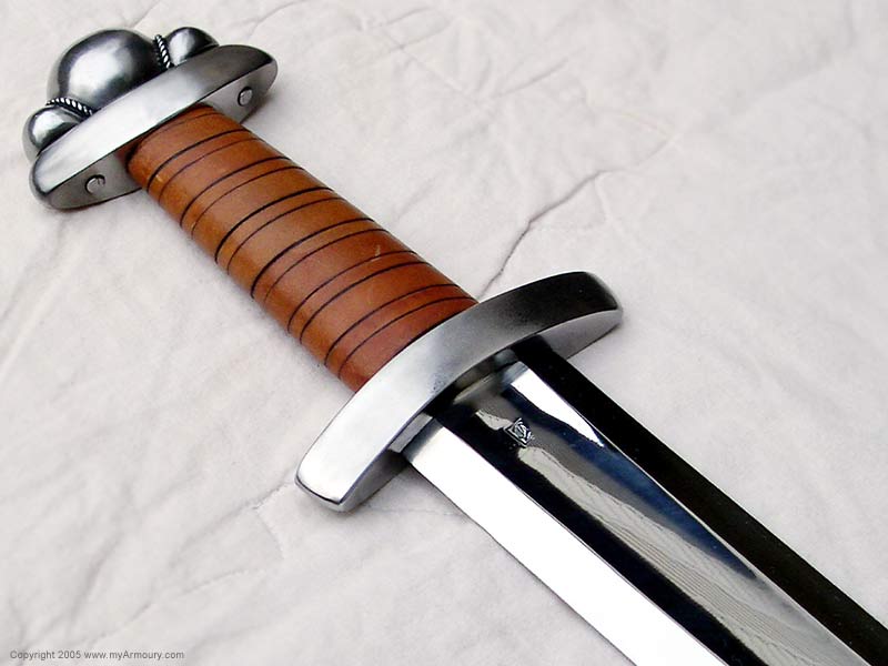

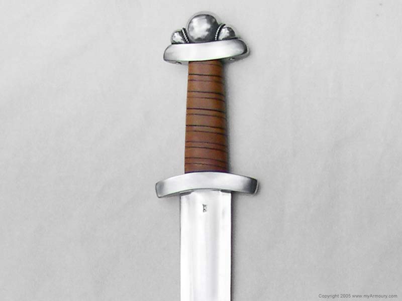

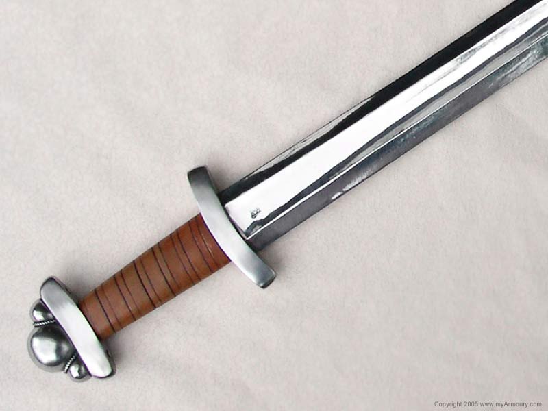

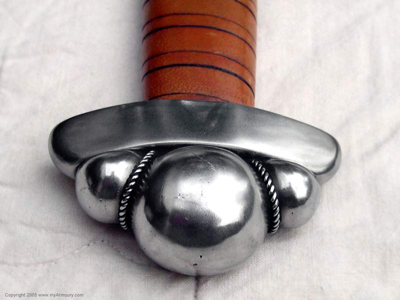

Cervenka has bound the grip of this Viking sword with alternating narrow and wide leather strips. This makes for an attractive grip that goes well with the simple design of the hilt. The hilt components are all tight with little to no gaps. This Viking sword has a true two-piece pommel riveted tightly to the upper guard. The hilt furniture has a brushed satin look and the contrast with the polished blade is quite pleasing. However, I personally prefer the more weathered look that Cervenka offers.

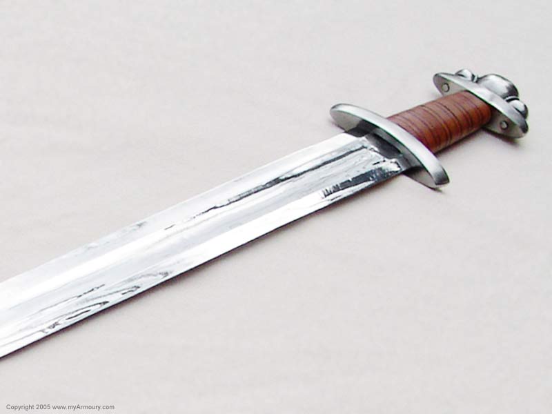

The blade and fullers are well-shaped and show a bright mirror polish. They do have slight undulations on the surface from the forging process, but these are only slightly visible when looking down the blade against a light source. Also, very slight grinding marks can still be seen when viewed at certain angles. The edges have absolutely no secondary bevel. They display a very smooth transition from the fuller ridge to a razor sharp edge.
One of the first things I noticed when removing this sword from the shipping box was that it does not look like your typical Viking sword replica. It looks like Viking swords I have admired in museum pictures. The blade is thin with shallow fullers rather than the thicker blades and deeper fullers seen on many replicas. Also the pommel is large and bulbous, a feature typical of Type S hilts. The large hilt and extra mass in the pommel helps to give the sword a very nice balance. I was curious to see how Cervenka's Viking sword would compare to originals of similar type. Ian Peirce, in his Swords of the Viking Age, does include statistics of a few Type S Viking swords:
Data on Type S Swords from Peirce  Cervenka Type S
Overall length:  87.7cm, 88.5cm, 90.1cm, 98.4cm (Avg. 91.2cm)93.5cm
Point of Balance (PoB):  (PoB): 15.3 cm, 8cm, 6.5cm, 12.7cm (Avg. 10.6cm)10cm
Grip length:  9.1 cm, 8.6 cm, 9 cm, 8.8 cm 9.5 cm (Avg. 9cm)10cm
Guard width:  10.2 cm, 11.4 cm, 12.8 cm, 12.5 cm (Avg. 11.7cm)10.4cm
While the above sample is very small, it would suggest that this Cervenka Viking sword is similar to original finds in its proportions. Maybe it is a bit long in the grip for the type, but easily within the range for Viking swords overall.
