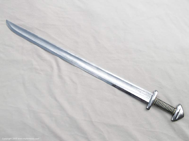

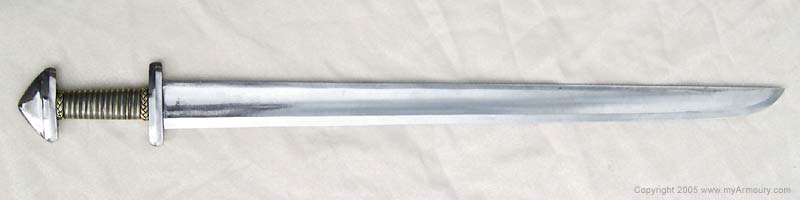

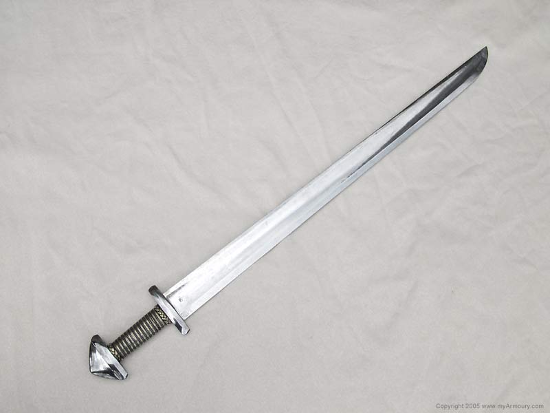

Weight:2 pounds, 8 ounces
Overall length:35 1/2 inches
Blade length:28 7/8 inches
Blade width:2 1/4 inches at base, tapering to 1 1/2 inches
Grip length:4 inches
Guard width:3 3/4 inches
Point of Balance:4 3/4 inches from guard
Center of Percussion:~17 inches from guard
Replica created by Vladimir Cervenka of the Czech Republic.

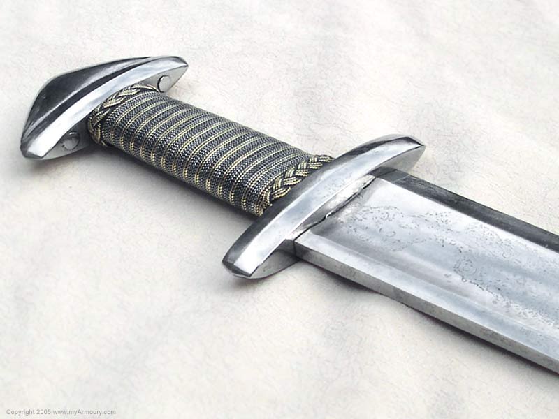

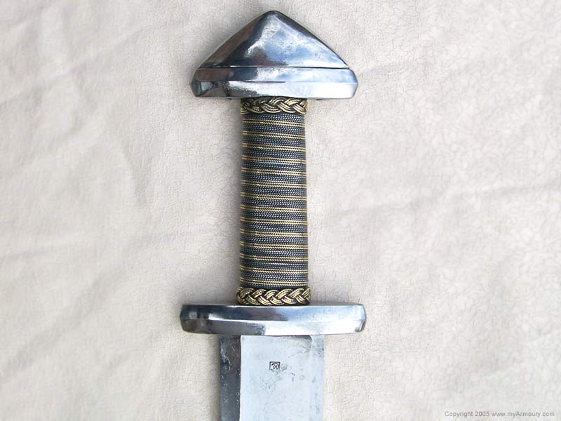

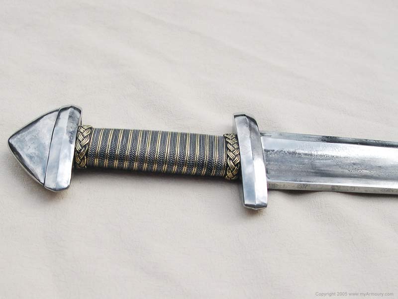

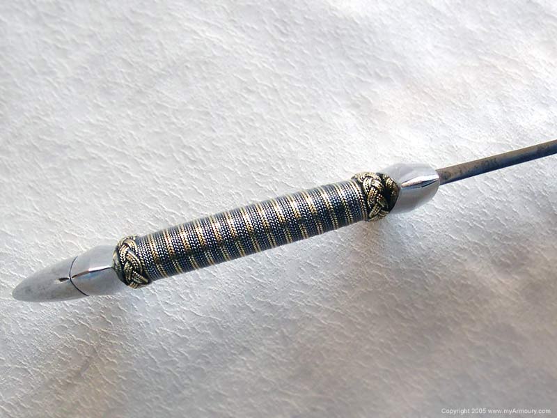

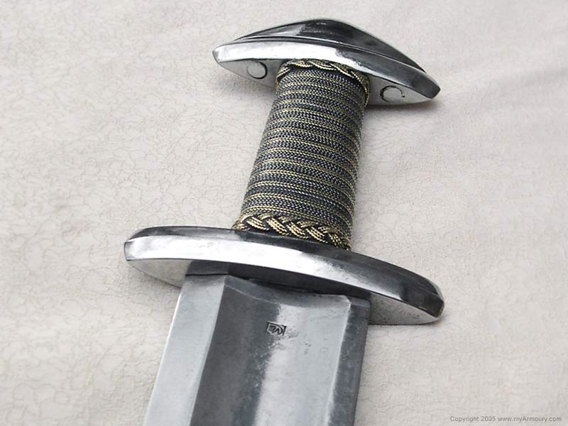

This single-edged Viking sword has a grip that bulges slightly at its center to fill the hollow of the palm. When tightening your grip it forces the hand to expand against the guards, locking the hand to the hilt. With a dry hand, the wire-bound grip feels very secure and is in no way uncomfortable. The tops of the wire have been sanded down to a smooth polish: it has enough undulation in the surface to provide good purchase but is not so rough that it abrades the palm.
This blade was obviously not designed for thrusting. Even the curvature of the tip allows for slicing tip cuts rather than deep thrusts. The extra weight in the back edge makes for a more rigid blade than a typical double-edged sword of the same thickness. Also there seems to be much less vibration with impact away from the sweet spot (Center of Percussion). The heavy single-edged blade certainly has more cutting power on heavier targets than many double-edged blades. The blade tracks well, yet I found it a little harder than usual to achieve correct blade alignment during a side cut. Overhead downward cleaving cuts were less of a problem.

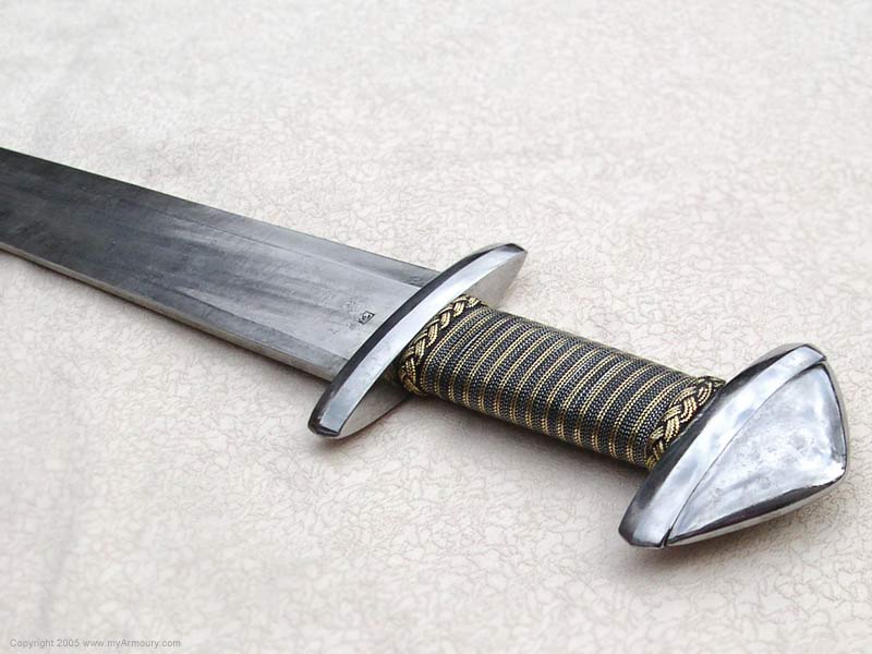

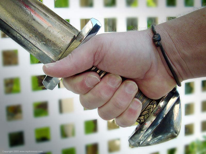

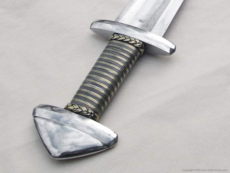

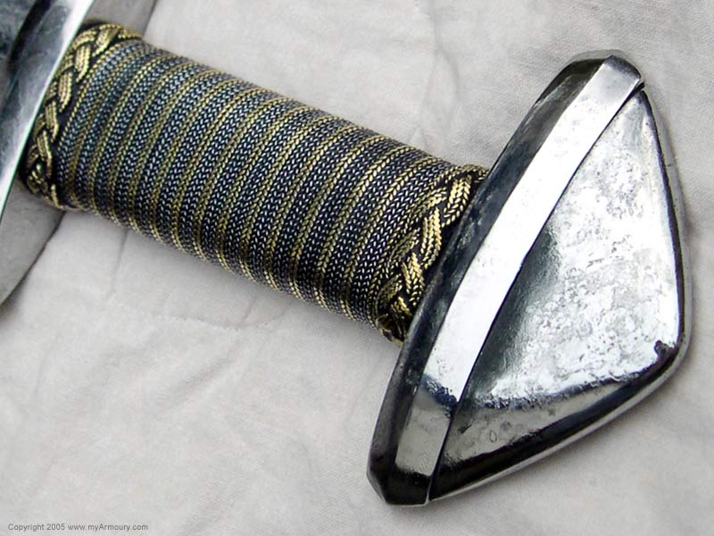

While this sword was not designed for the thrust, it could be used in that fashion. The triangular cross-section and stiffer blade would function better than most double-edged Viking swords in breaking through a weak link in a mail shirt. However, when holding this sword, it is not thrusting that comes to mind; rather there is an overwhelming urge to smash something. Its wide single-edged blade just seems to pull the hand forward. The only important weakness I could find in the handling this sword is that the pommel was just a fraction too wide and sharp. During a cut it would often dig into the wrist. However this was a problem only when bending the wrist during the cut. It caused little discomfort if the sword was held in a hammer grip when cutting with a straight arm. Not surprisingly, the sword cut much better using this more comfortable method. Blade alignment was also easier. I found that the "handshake" grip, while more comfortable, was much less secure.
I sought out fellow collector Tom Carr's perspective on this sword. He echoed my feelings on the pommel, saying "That long sharply tapered pommel is a bear when it digs into your wrist! Ouch! I found that holding closer to the pommel in a handshake grip and laying your index finger over the cross is the best way to use this sword. The pommel slides naturally over your palm when held this way and the index finger provides much-needed edge orientation. The feel of the sword is solid and very alive with a brutally effective cutting action! Tip cuts are effortless. The pronounced curve of the tip is reminiscent of much later sabers. This sword is really sharp! Vladimir outdid himself."

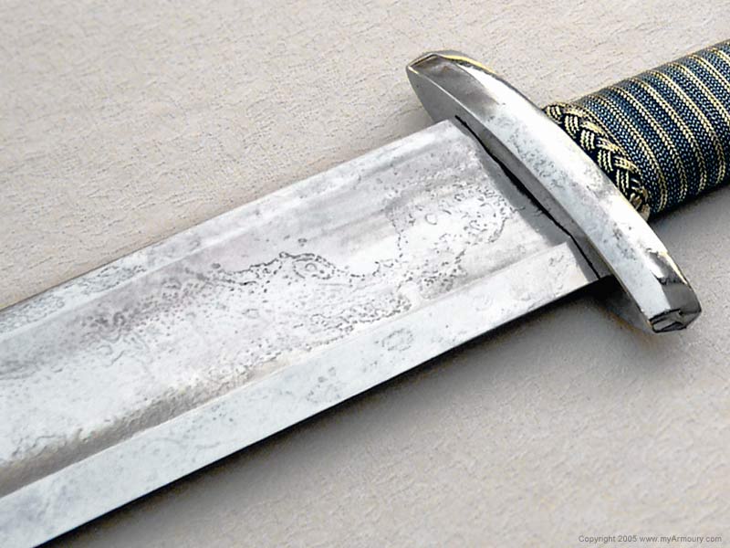

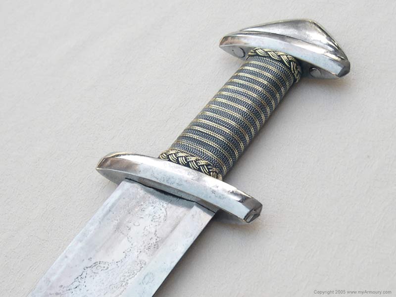

The blade is polished to a high sheen even with the antiqued patina and both it and its fullers are well-shaped. They do, however, have slight undulations on the surface from the forging process, but these can only barely be seen when looking down the blade against a light source. Also, very faint grinding marks are visible when the blade is viewed at certain angles. The edge has absolutely no secondary bevel. The hilt components are all tight with little to no gaps. In the case of the joint between the blade shoulders and the lower guard surface, Vladimir has set the blade flush against the guard with no groove in the lower surface of the guard to receive the base of the blade. I am not sure if original Viking swords are seated in this way; however, it is different than most modern replicas. This sword has a true two-piece pommel. The pommel and upper guard are well-matched, but are not perfectly aligned. There is a very slight overlap in one spot that is hardly noticeable. As a matter of fact, I had not noticed it for several days, and when I did, it was felt before it was seen.
Vladimir has perfected the art of adding centuries of patina using a carefully developed acid and water wash treatment. This technique produces a fine weathered and polished gleam that I really like. This, along with the age-worn edges, adds to the character of the sword and gives it a sense of being unique. Once the brass and steel wire binding on the grip darkens, the overall aged affect should be very convincing. While few Viking sword replicas have grips bound with wire, there are many originals with remnants of wire that once bound a long decayed grip. The Turk's head knots used as ferrules are certainly not correct for the period. Vladimir told me this when I asked him to do it, but he was gracious enough to add them for me. He even ground them down so they look more like the braided patterns sometimes seen on Viking jewelry and carvings.
