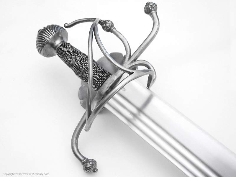

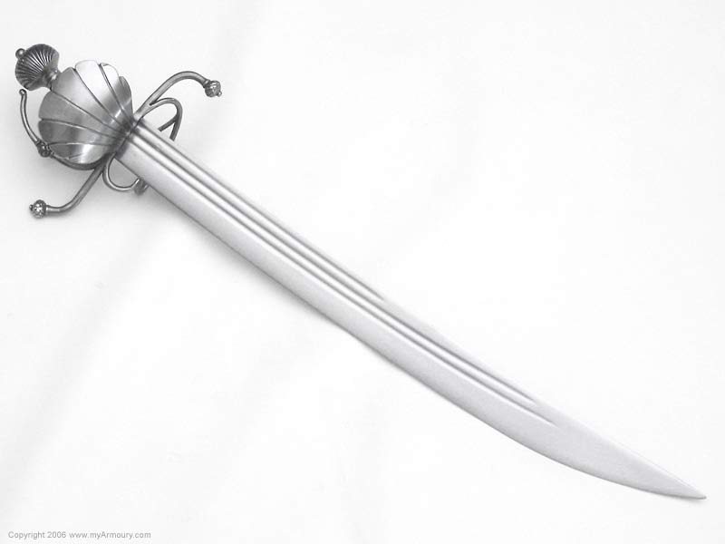

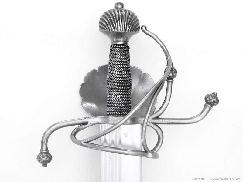

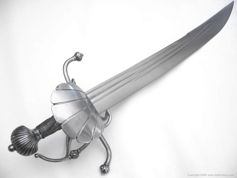

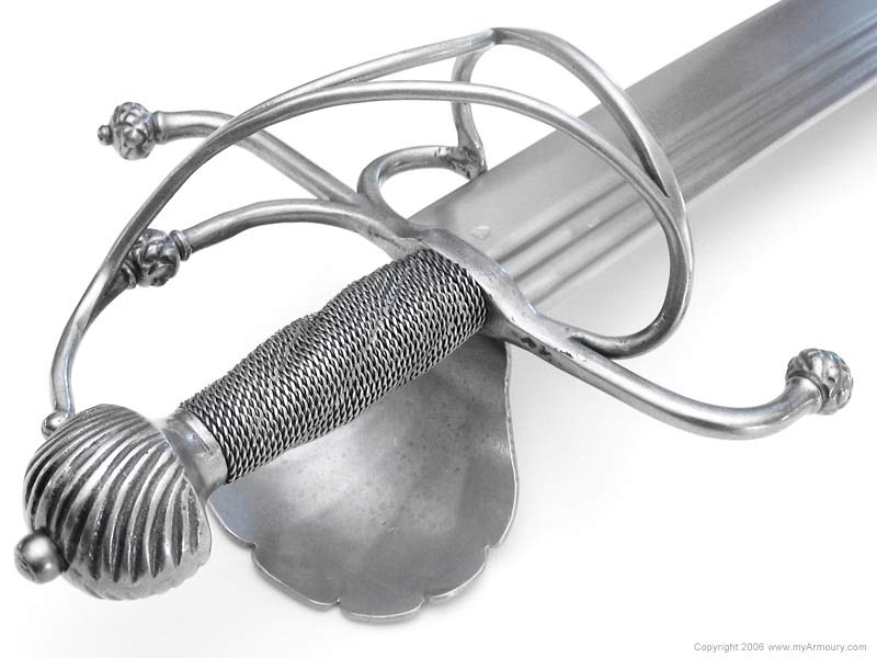

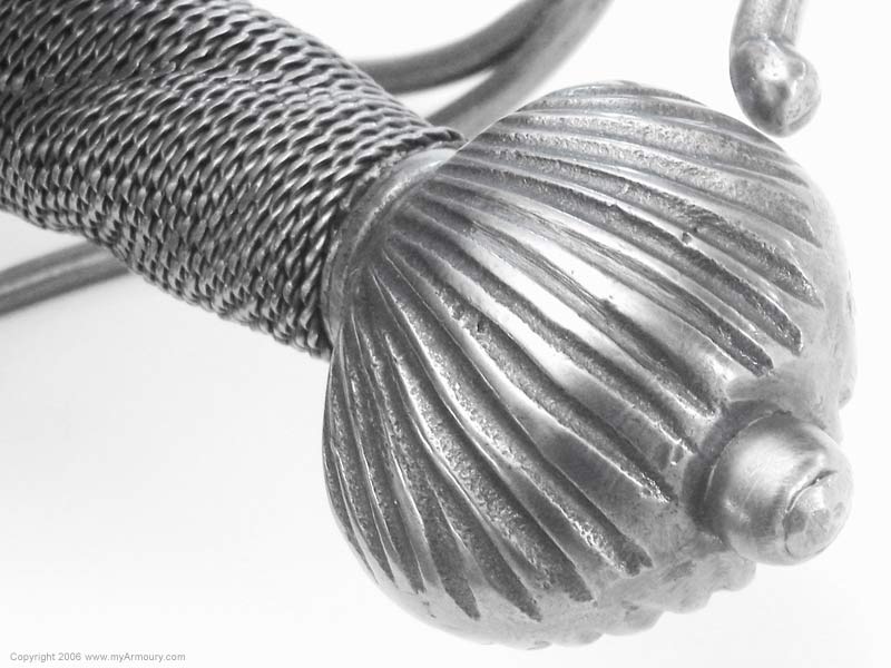

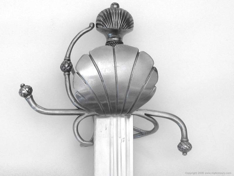

The Italian firm of Del Tin Armi Antiche has chosen to recreate a German Dussack of the early 17th century. The form of its hilt may be related to the Sinclair I hilt type, which Ewart Oakeshott informs us was common during the same period and frequently was mounted on falchion blades. But then, many such weapons in this period tend to resemble each other irrespective of cultural origin. They typically feature an iron plate guard (often of scallop shell form) and a short, broad, single-edged blade. But although the Del Tin weapon fits into this larger category, certain elements of its hilt are distinctively German. The vine-like form and gentle curves of the quillions, ending in blackberry-like finials, recall many German hilts of the period. The roughly hemispherical pommel echoes the shell form of the guard and the wire-bound grip of spiral form complements the other organic lines of the hilt.

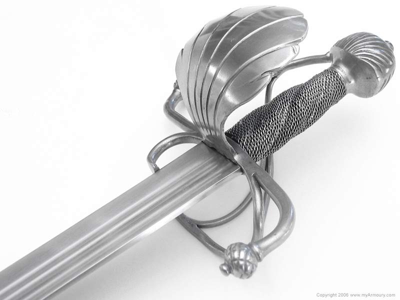

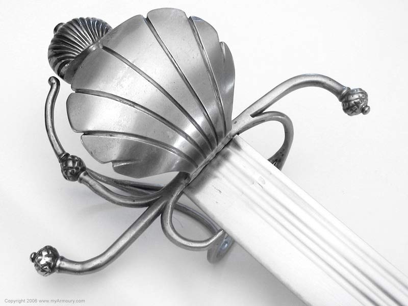

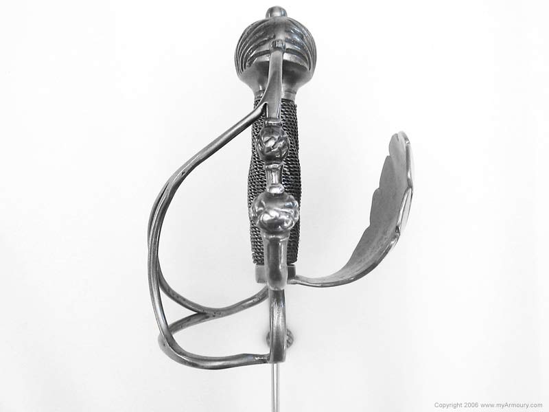

The weapon's primary guards include the S-curved quillions, knuckle-bow and an outside plate guard of scallop-shell form. Secondary inside defenses include an inverted Y-shaped guard which splits from the top half of the knuckle-bow and extends down past the quillions to join another bar. That bar extends downward from the rear quillion on an angle for just over an inch, then bends abruptly toward the edge of the blade, almost contacting it. This bar then bends upward to join the base of the forward quillion, creating a faux finger ring (the plate guard prevents its use).

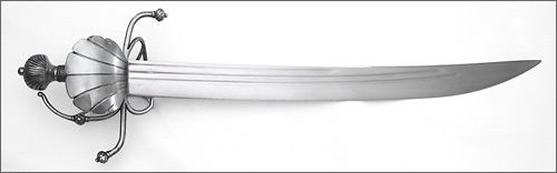

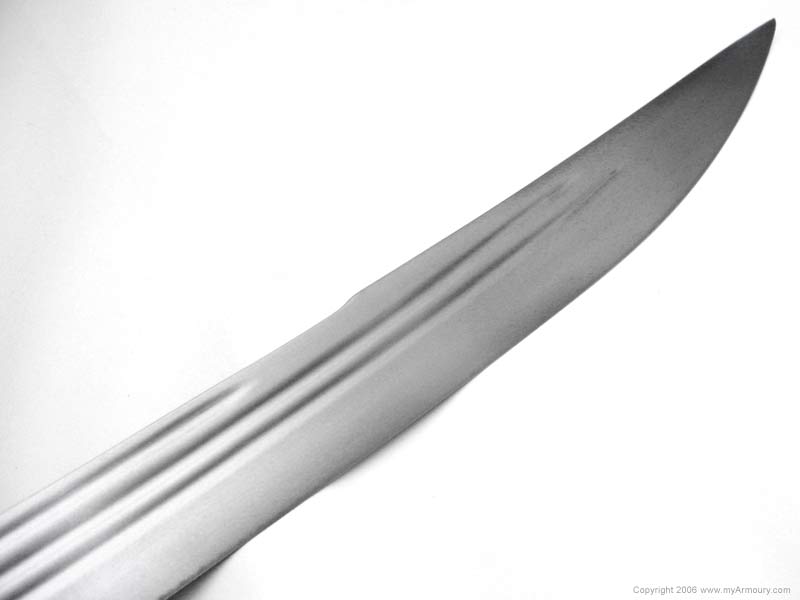

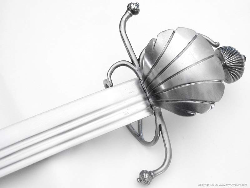

The blade is short and broad, maintaining its 2" width for most of its length, constricting slightly before swelling 14" below the guard. Below that is a very blunt false edge. Three shallow fullers run along each flat of the blade. The fuller closest to the back of the blade ends 12" below the guard, while the other two run to 19" and 20", with the longest fuller closest to the edge. The manufacturer's arms are stamped on both flats of the blade just below guard. The smaller DELTIN name is stamped only on the inside flat of the blade, inside the middle fuller.

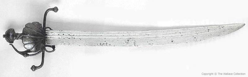

Antique sword, The Wallace Collection, London. Probably German, circa 1610, blade Italian (?)
Nathan Robinson, myArmoury.com's founder, viewed the antique weapon at The Wallace Collection on which Del Tin appears to have based its reproduction. He says that Del Tin has largely been faithful to the original. He noted that the Del Tin piece lacks the original's thumb-ring, however. As the photo above indicates, the hilt of the original also was blackened, while the reproduction's hilt is bare steel.

Weight:3 pounds, 8.5 ounces
Overall length:32 1/4 inches
Blade length:26 1/4 inches
Blade width:2 inches at base, tapering to 1 inch
Grip length:3 1/4 inches
Guard width:8 1/2 inches
Point of Balance:3 1/2 inches from guard
Center of Percussion:~16 inches from guard
Replica created by Del Tin Armi Antiche of Italy.

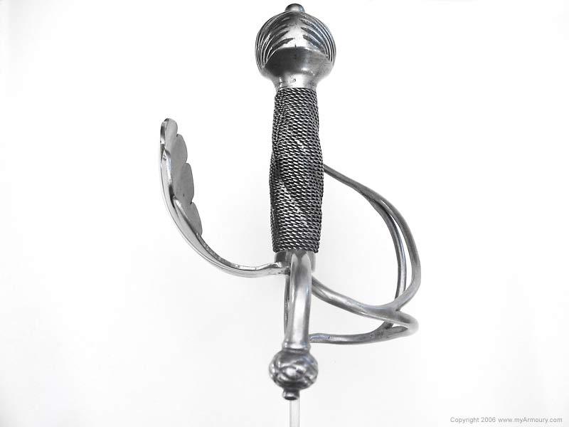

Hilt Detail
Click to enlarge
Pommel Detail

Blade Detail
Although the Del Tin Dussack is 13 ounces heavier than the original it otherwise mimics so well, please note that, as with all Del Tin swords, the Dussack features a blunt edge (flat, in fact) due either to legal restrictions or European reenactor preferences. This accounts for some of this weapon's excess weight, so sharpening could both lighten it and improve handling. Still, much of the Dussack's weight must be in the hilt. The quillions are just over .25" thick. The pommel is almost 2" square. The finials of the quillions and knuckle-bow are .75" each. The attractive twisted-wire grip wrap, while appropriate for the period and the weapon, must add significantly to the weight as well.
Western martial arts instructor and myArmoury.com Team Member Bill Grandy also examined this weapon and offered notes about its handling in period-appropriate exercises. "Holding it in a static position does not give the user a strong sense of confidence in the weapon," he acknowledged. However, he added, "when the sword is in motion it is actually a lot more dynamic than expected." He observed that transitions between cuts and guards were easily made and, ultimately, he came away with a favorable impression of the piece. "The more I used the sword the more I liked it," he said.
Grandy also noted that Del Tin's inclusion of a false edge on the blade allows for a typical German maneuver in which one intercepts an incoming blow with the knuckles facing upward and simultaneously cuts downward toward the opponent with the false edge of the blade. According to Grandy, "a counterattack such as this, known as a schielhau (squinting strike), feels very natural with this sword, particularly with the extra hand protection it provides." I will second Grandy's observation of the security this weapon offers the hand.
The bars of the hilt are robust and well-positioned for defense, and neither too roomy nor too constricting. I would request only the addition of a thumb ring, as per the original. That could dramatically improve handling of the weapon in even its blunt form.

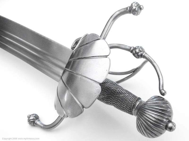

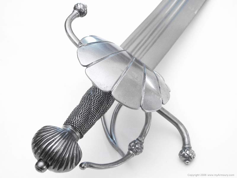

Fit and Finish
In overall dimensions and form, this weapon is true to the original on which it appears to be based. However, close inspection reveals an indifference to detail. This wouldn't necessarily be out of place on an infantry weapon of the period but some collectors might find it unacceptable.

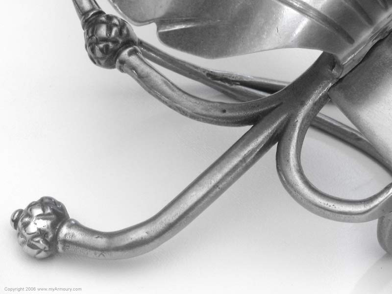

Poor definition in the cast quillion finials and pommel is my primary grievance about this weapon's finish, but some also might object to the finish of the welds at various points on the bars of the hilt. On the other hand, Bill Grandy observed that the welds were better-finished than on many other Del Tin swords. "This weapon gives a slightly rugged look without appearing unfinished," he said. "Overall this is a good looking sword for what it represents." That pretty well sums up my feeling, too, and I'll add that blackening of the hilt to match the original would conceal the flaws described above.
