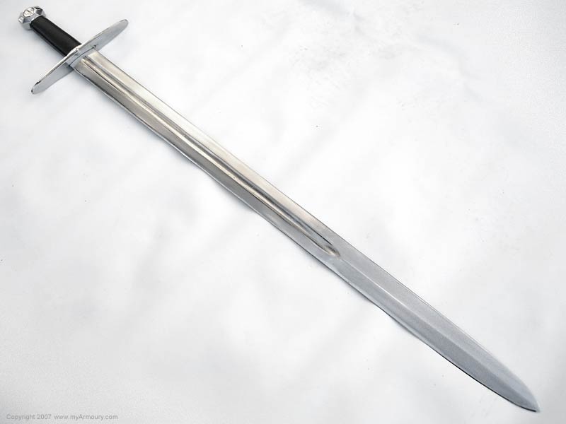

This Twelfth Century Medieval Sword belongs to the Last Legend Competition Blades Generation 2 Historical Recreations line. The sales literature boasts that this line is comprised of "Historically Accurate Swords designed for the Steel-to-Steel™ Challenge!". This Steel-to-Steel™ challenge, according to the sales literature, involves striking 2" x 4" wood slats and steel (though it is not specified if "steel" refers to another sword or a random piece of metal). This review sword was not put to that rigorous of a test, though it was used in test cutting.
Click to enlarge
Weight:3 pounds, 6 ounces
Overall length:43 inches
Blade length:34 1/2 inches
Blade width:2 inches at base, tapering to 1/4 inch
Grip length:5 3/4 inches
Guard width:8 1/4 inches
Point of Balance:5 3/4 inches from guard
Center of Percussion:~17 inches from guard
Oakeshott typology:Type XII blade, Type I1 pommel, Style 1 guard
Replica created by Last Legend Competition Blades of El Dorado Hills, California.

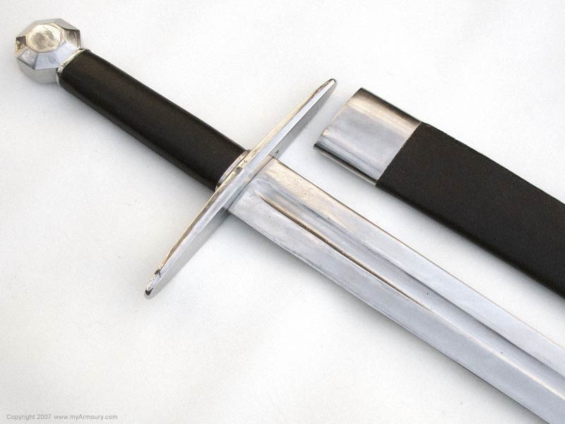

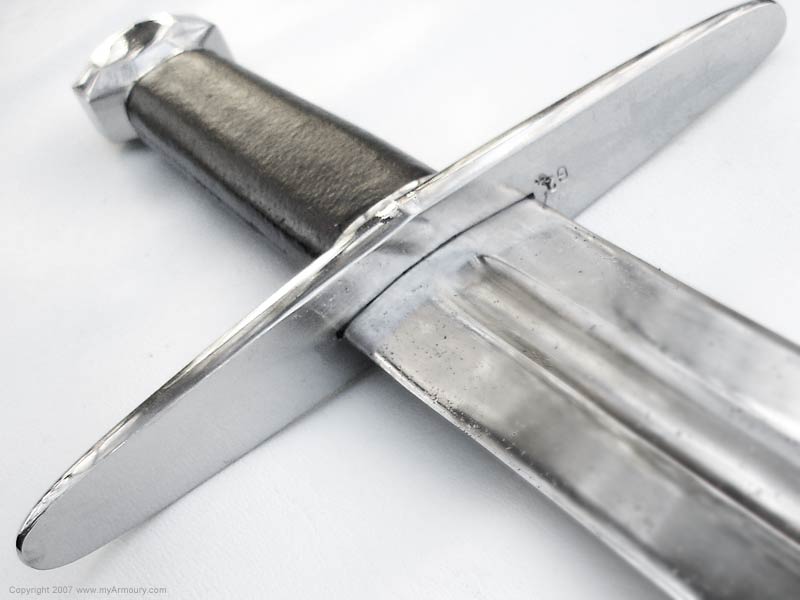

For a sword that is supposed to be a historical replica, this one only very loosely fits the bill. The blade is a good shape, for the most part matching historical blades, though I would have liked to have the fuller extend all the way to the guard if not into the tang. In fact, I would say the blade is the most attractive part of this sword, being of a bright finish with mostly clean lines.
Click to enlarge
Underside of guard
Click to enlarge
Grip detail

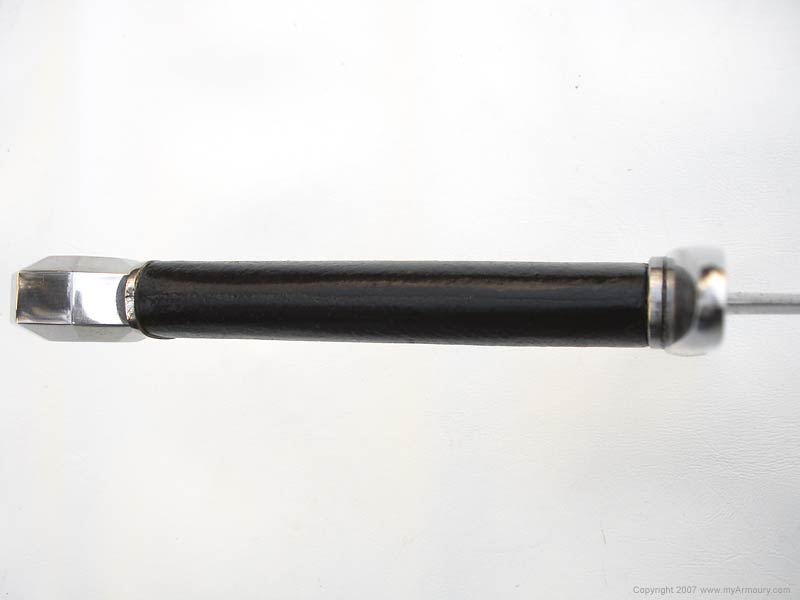

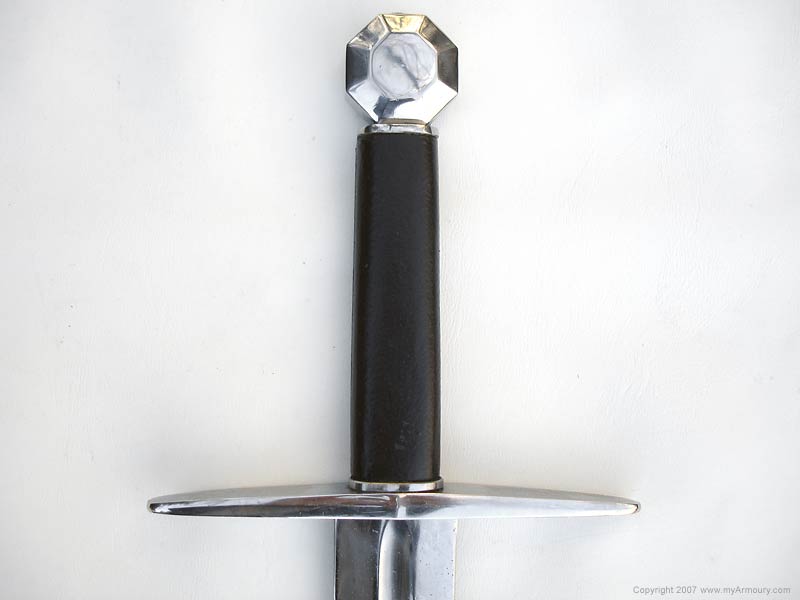

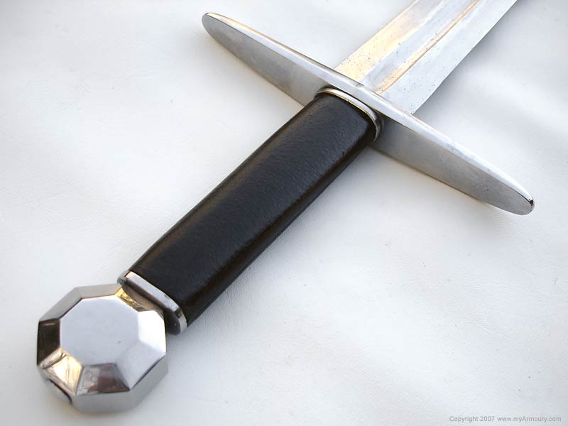

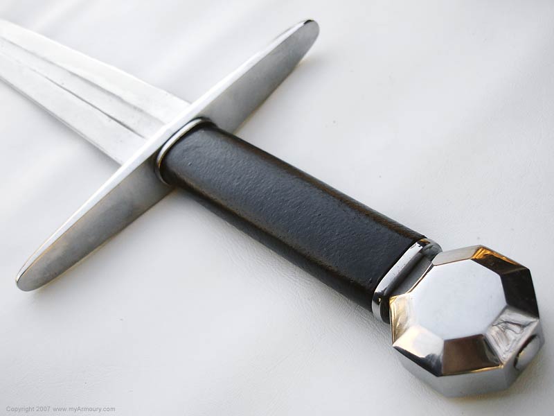

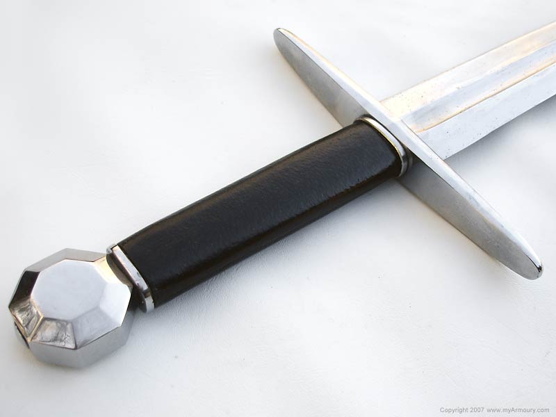

The hilt is not very attractive. The first thing that jumps out is the thick, chunky guard. There was a definite attempt to make the guard into a hexagonal cross-section, but it only barely shows this, and if one looks from the top-down at the guard it is very wide. If it had tapered further towards the tips it would have had a more elegant look, but as it is it looks clunky. The pommel is much better in appearance, having an octagonal shape that is fairly well formed. Unfortunately it does not transition into the overly thick grip well, which strongly detracts from its appearance. In fact, the thick grip makes it look like it doesn't belong on this sword.

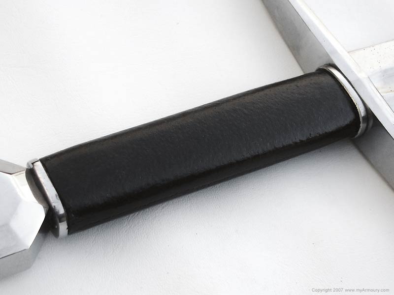

The grip itself is too thick. I personally have big hands so it doesn't bother me, but I am certain those with smaller hands will complain. It also has two steel washers on the ends that look very modern, and further detract from the look.
Despite the aesthetics, the hilt does feel very solid and showed no signs of loosening during handling or test cutting. There appears to be some epoxy showing at the ends of the grip which seems to be used to reinforce the assembly.
The sword comes with a decent wooden scabbard that is wrapped in rough pigskin leather. The scabbard fits snugly without being too tight and is a rather nice addition considering the price. The leather is the same type used for the grip and is not very high quality, but does appear to be very durable nonetheless.
