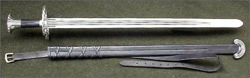

The sword was ordered sharp, and will need just a light honing to become really sharp. The blade sports three narrow, blackened fullers, plus an additional two short fullers at the base of the blade. The point is almost square, which appears to have been common among Katzbalgers, and makes me think of executioners' swords. I've filed it to a more spatulate shape.
The heavy, sculpted pommel and figure-8 guard are made of steel, apparently cast and finished by hand. The grip is black-dyed hardwood (perhaps oak), perfectly scored to match the scores in the pommel, and providing a comfortable grip.
The sword comes with a black heavy leather scabbard, well made and with a rather elaborate steel chape (end piece). The simple suspension is rather authentic, as far as I can tell, and made for horizontal carry, just as in many contemporary illustrations. The belt on my scabbard was let down by a modern buckle, which I replaced.
