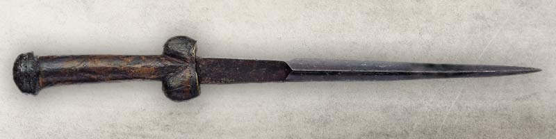

A ballock dagger dated circa 1500 located in the Royal Armouries at Leeds, UK
Overview
This replica is based on a ballock dagger residing in, but not on display at, the The Royal Armouries, Leeds. There is very little information available about the original. Weighing in at 6.4 ounces and dated circa 1500, the place of origin of the dagger is unknown. Manning Imperial has listed a German origin on their Web site while DK Publishing, in the book Weapon: a Visual History of Arms & Armor, claims the dagger's origin to be English. While contacted to help clear things up, the Royal Armouries has unfortunately been silent about the issue. For my part, I believe an English origin is more likely as the unusual blade shape seems to herald the dudgeon daggers of the 17th century. However, this assessment is pure speculation.

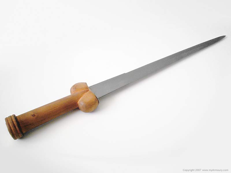

This dagger feels very stout in the hand. Definitely intended for heavy duty thrusting, the asymmetrically diamond-shaped hollow-ground blade is approximately 1/2" thick after the false ricasso. I find that most daggers that I have handled have a Point of Balance (PoB) very close to the hilt. Combined with the light weight of those daggers, I have found that they are much harder to control in the thrust. This is not the case with this Manning Imperial dagger. Its PoB is just in front of the false ricasso which gives the dagger enough heft and forward momentum to allow me to place the point of the dagger exactly where I want it. It also allows for very powerful thrusts. This is a weapon that I wouldn't hesitate to take to war with me.

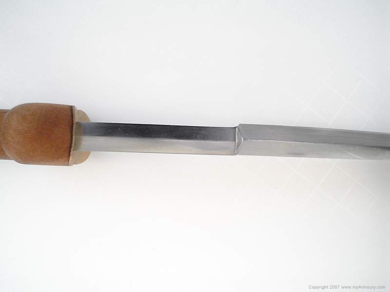

Ricasso

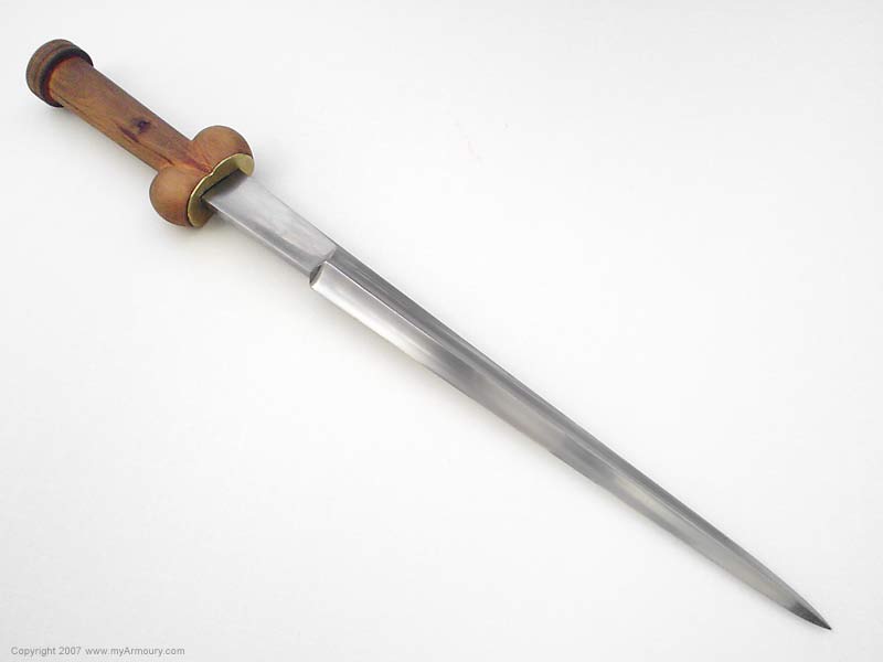

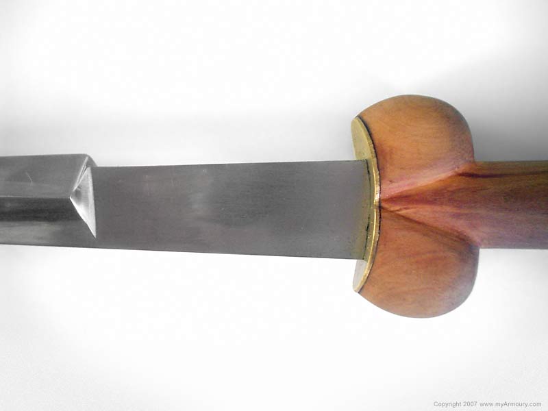

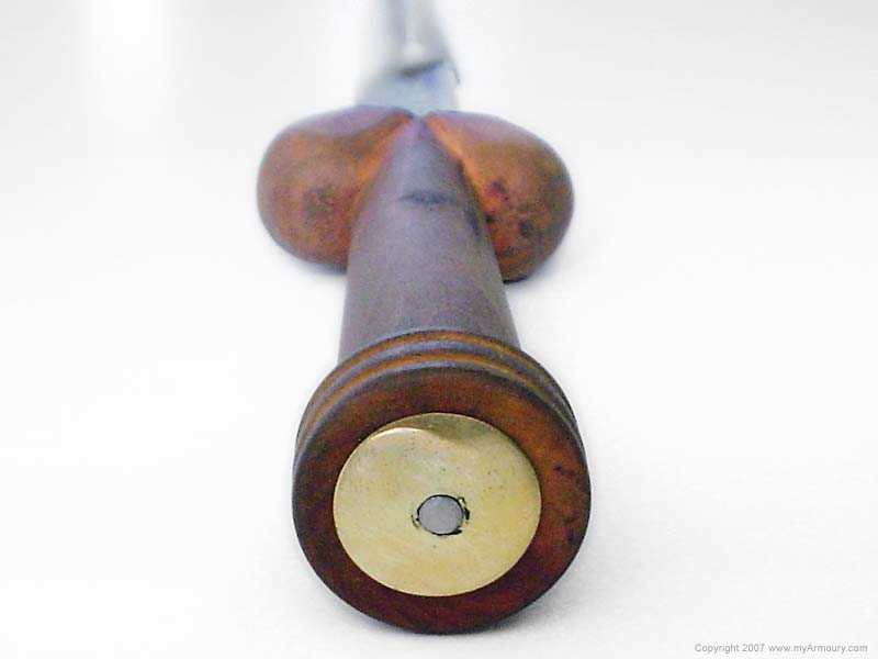

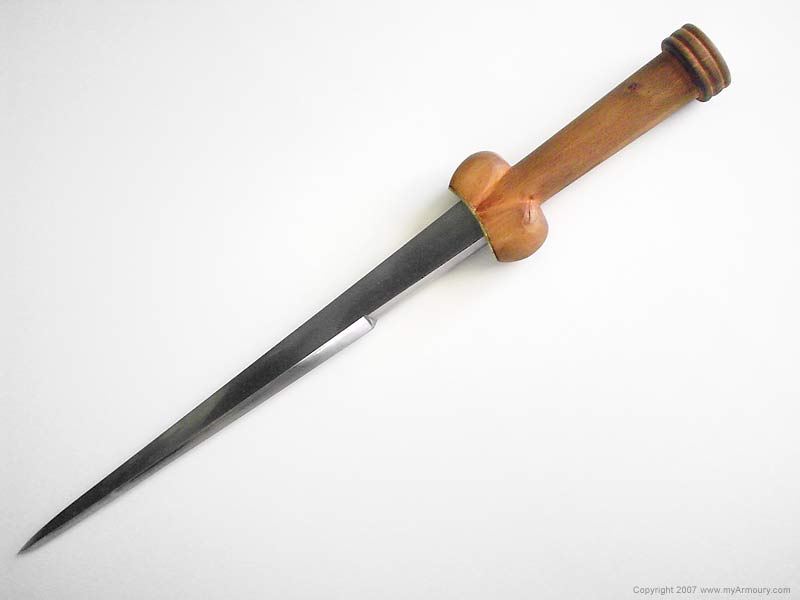

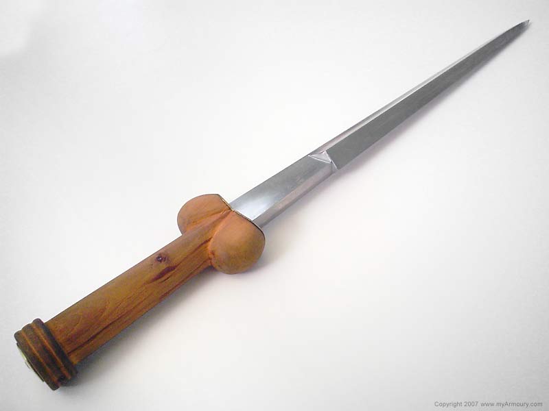

The blade is marvelously designed and perfectly hand-finished to 1200 grit. There are no marks on the blade whatsoever. Unusually complex, I can honestly say that I never seen another blade like it. Unique in its character, Craig from Manning Imperial was able to take exact measurements of the blade during a visit to the Royal Armouries at Leeds.
Every angle on the blade is hollow-ground. It begins with what could be considered a false ricasso with a flattened triangular spine at the base of the hilt. At the end of the ricasso one side of the blade sprouts a central rib while the other side of the blade continues with a slight hollow-grind all the way to the tip. The central rib on the face of the blade after the ricasso gives most of the blade (approximately 8 3/4") an asymmetrical diamond cross-section shape. It also leaves a false edge protruding above the ricasso.
This is one of those blades that must be seen to be believed. Why someone would design such a blade remains a mystery. While the reinforced diamond section makes the blade extremely sturdy and aids in thrusting, there would seem to be easier ways to gain the same benefit without the use of such a unique design. Regardless, I have never been so impressed with the precision and execution of such a complex blade in a reproduction.

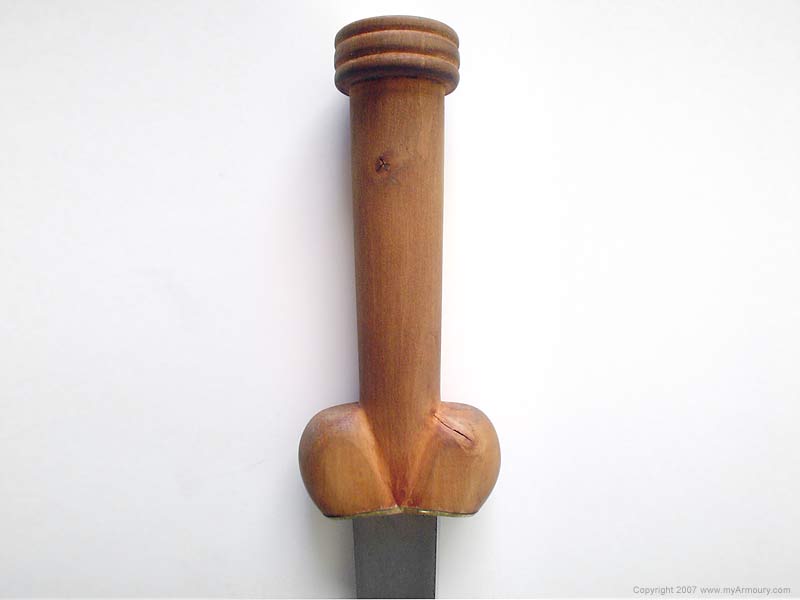

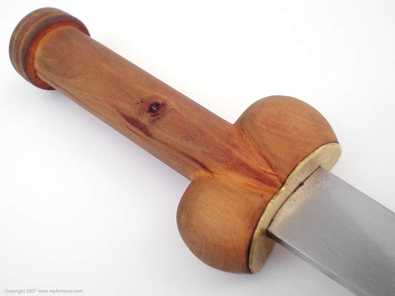

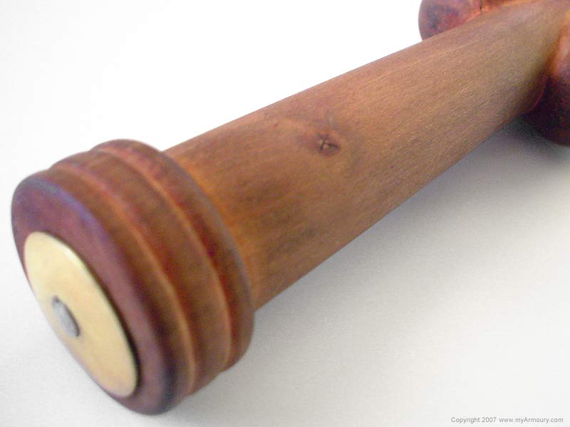

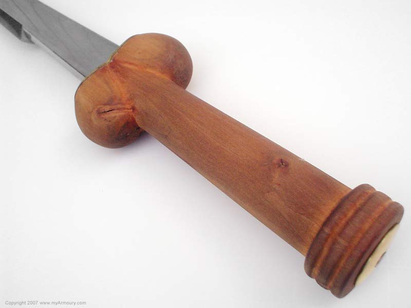

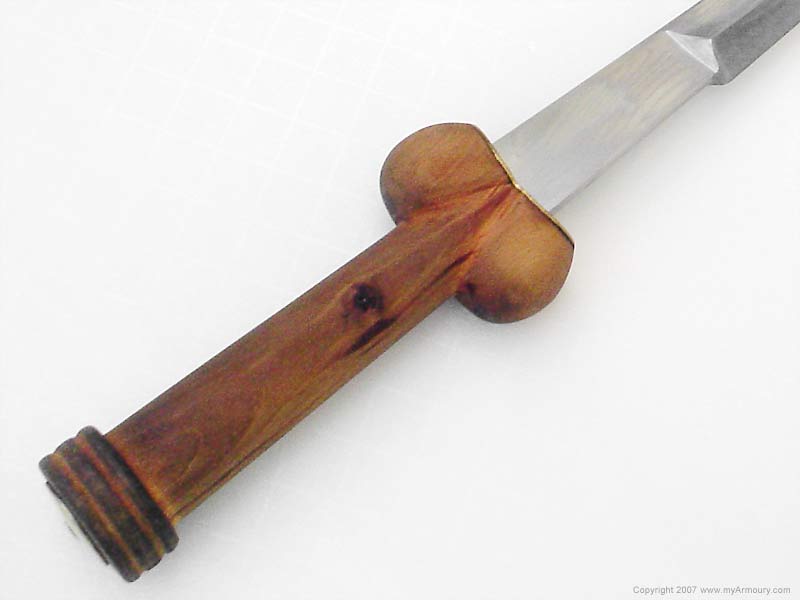

In stark contrast to the exceptionally complex blade, the hilt is very simple in design and execution. It is carved out of hawthorn wood and capped in brass at both the pommel and basal lobes. The brass pommel cap simply lies on top of the rondel-like pommel and is noticeably off-center while the brass washer between the blade and basal lobes is roughly cut and could use some additional filing on its edges.
The hawthorn wood itself feels slightly rough to the touch and could use an extra bit of sanding but isn't rough enough to be distracting during handling. Additionally, the handle is covered with a few knots which add to the rustic appearance and feel of the hilt. However, the wood does exhibit some pleasing contrasting grain patterns.
The rondel-shaped pommel is also not completely representative of the original dagger. While both daggers exhibit similar incised line patterns, the reproduction has a flat top as opposed to the original's rounded, more phallic, knob-shaped pommel.
