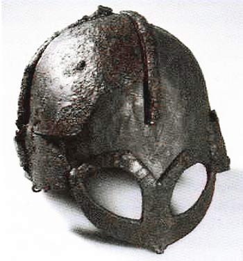

To date there has been only one helm that can be definitively described as "Viking." This helm was discovered in 1943 at a farm called Gjermundbu in Norway. The helm was part of a large grave-find that included many other items such as a sword, two axes, two spearheads, eight arrowheads, and the fragments of a mail coat (the earliest example found in the Nordic countries) as well as sundry personal goods. An elaborate scabbard chape was also found along with the sword, and due to the quality of these grave goods it is believed that the deceased was a Viking warrior of high standing. The helm itself is in the usual fragmented condition and only partially survives. Due to its condition a complete reconstruction of the helm is not possible. Still, from the surviving fragments the helm's general construction can be determined.
The Gjermundbu helm is made with the Spangen method, a segmented form of construction that became so common during the early Middle Ages. This typically consists of four to six plates that are held together by riveting them to reinforcing bands. As can best be determined by its condition, the helm's skull was formed from four plates that were connected to each other by four reinforcing bars that ran along the exterior of the helm. Evidence shows that four additional bars may have been attached to the helm's interior as well. The skull assembly was then attached to a horizontal brow band. The helm's most distinctive feature is its face guard. This consists of a spectacle or ocular-shaped plate that would have protected the brow and nose of the wearer's face. A short spike was also attached to the helm's crown. The significance and intended use of this last feature is unknown.
The grave-find itself has been dated to circa 970 AD, and while all other items found in the grave would have been considered "modern" at their time of interment, the helm is believed to be considerably older. This is primarily because of its similarity to older helms of the Vendel period, such as those found at Valsgarde, Sweden and the famous Sutton Hoo Helm found in Suffolk, England. Many of these helms feature face-plates and ocular face-guards similar to that of the Gjermundbu helm. While these were common features found during the pre-Viking periods they seem to have fallen out of fashion by the 10th century. Therefore the assumption that this helm may predate the accompanying grave-goods is a logical one. Fragments of mail were also found along the helm's rim. While it seems certain that some form of mail neck drape was connected to the helm its exact form is unknown.

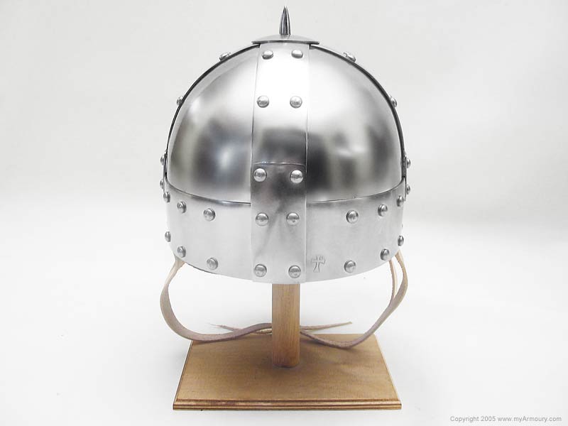

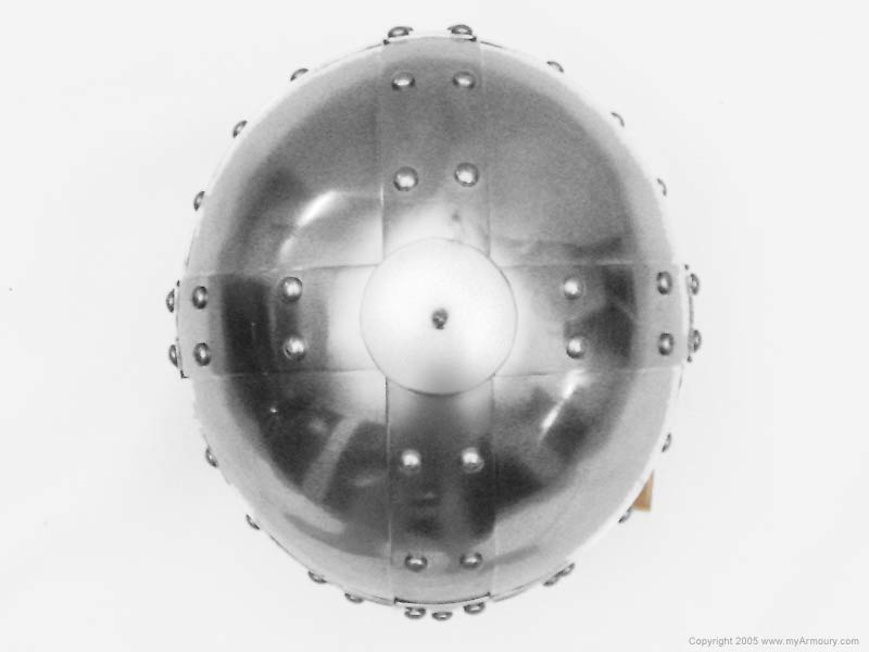

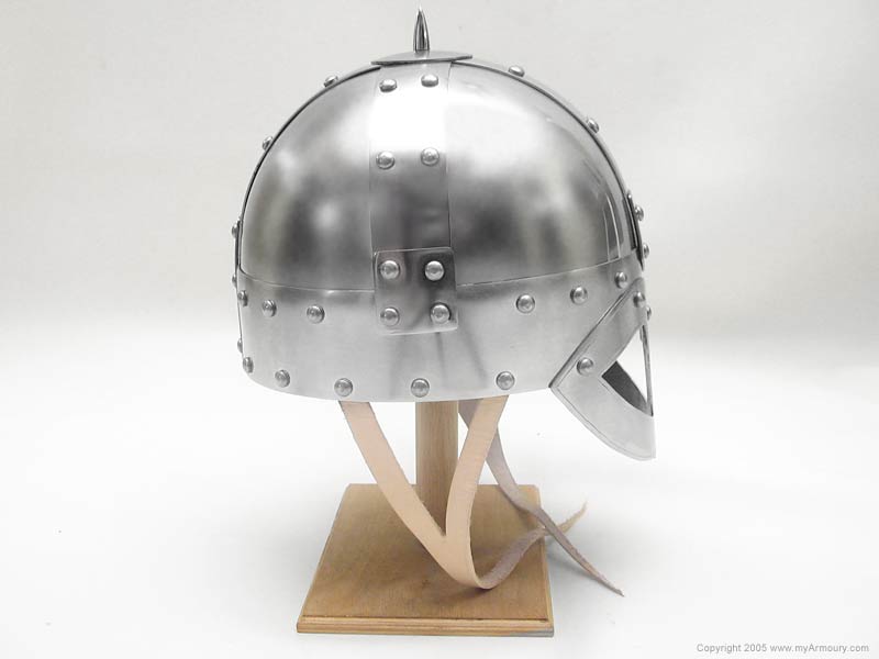

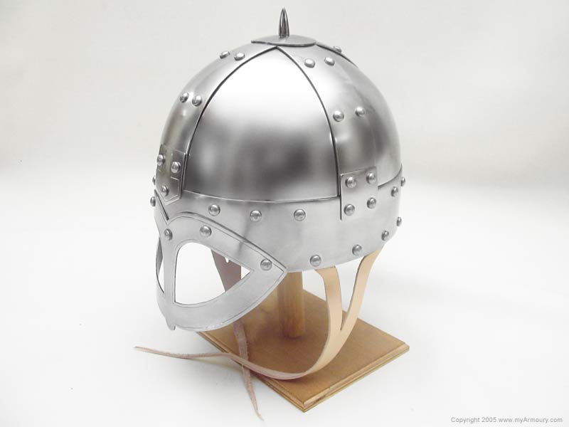

This helm is not a direct copy of the Gjermundbu find but is rather inspired by that artifact. While the Medieval Reproductions example features the same Spangenhelm style of construction its method of attachment differs from the original. Instead of using four reinforcing bars with two rivets each to connect the skull-plates, this helm utilizes four connecting bands that feature double rows of rivets. A theory concerning the original helm states that it was possibly made for ceremonial purposes due to the apparent fragility of its construction. This is possible; however, modern sensibilities typically assume that the arms of antiquity were far more overbuilt than they actually were. When this is taken into account this supposition remains only an interesting theory. Regardless of the design intent of the original the method of construction chosen by Mr. Fuller does result in a much stronger design.

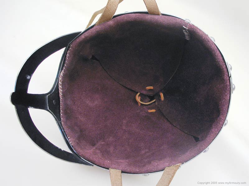

The skull assembly is connected by another substantial row of rivets to a horizontal band that forms the helmets rim. At the juncture of the connecting bands and the rim-band these pieces are connected by four plates. Mr. Fuller chose this method rather than running the connecting bands below the rim. The latter method would have resulted in gaps forming between the plates, while the chosen method gives the helm a much cleaner appearance. The characteristic ocular plate is fitted to the front of the helm by five large rivets, while a small spike is secured to the helm's top by a circular plate. The helm is also lined with a period-correct leather suspension system (theoretically correct since no original examples survive) and mounted with a leather chinstrap. Both of these items are riveted to the helm's lower rim. A mail neck drape can be attached to the helm as an option; however, since modern and inaccurate butted mail is used I elected to decline this feature.

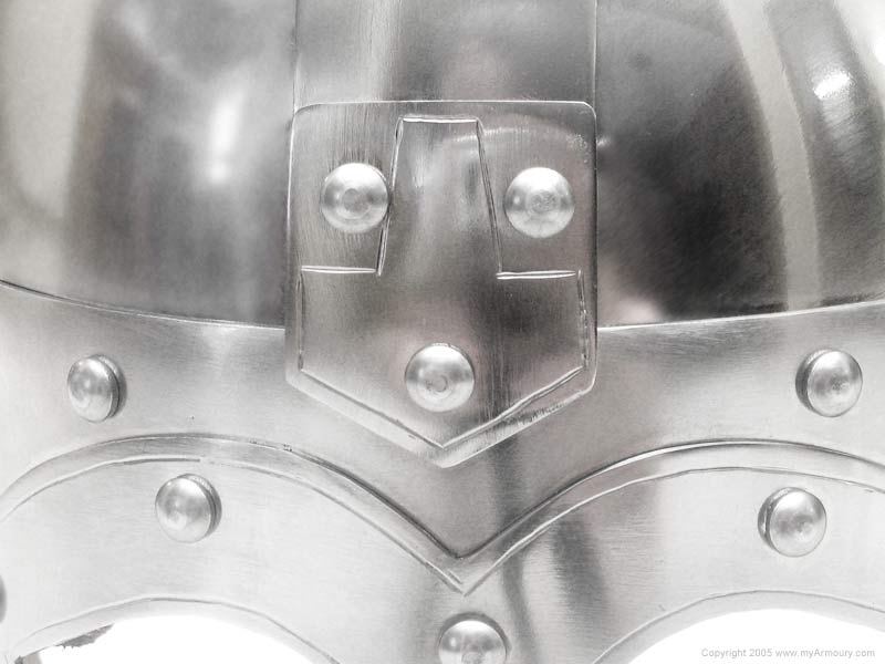

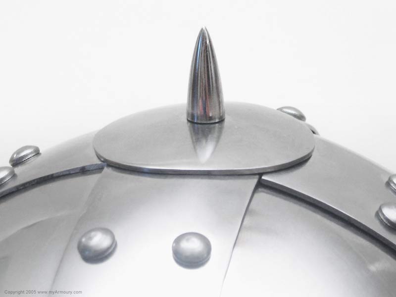

The helm features a high level of craftsmanship throughout its construction. All components are finely finished and well-connected in their assembly. The helm's only blemish is that the front connecting band and the ocular plate are not perfectly aligned with one another, as can be seen in the accompanying close-up photos. One of these components is slightly off-center; however, this really doesn't detract from the helm's fine appearance.
The front connecting plate is inscribed with the simple outline of a Thor's hammer, and the edges of the ocular plate are also inscribed with a single line approximately an eighth of an inch from both the interior and exterior edges. These small elements give the helm a nicely detailed appearance. All rivets are evenly spaced and set throughout the helm's construction. The entire piece has been burnished to a high sheen. This is not the overly glossy finish that is normally found on cheaper production armour, but is instead a deep rich polish that imparts a look of quality to the helm. (Note: this may not be evident in the accompanying photos due to our photographic setup.)
The only measurement I supplied Mr. Fuller was my cranial circumference, yet the result was a helm that fits my head perfectly. It is supposed that the mail coif and other similar head coverings such as an arming cap were not used during the Viking Age since no examples have ever been found nor are they illustrated in period artwork. Therefore a helm design of this period should fit the head fairly closely and this one does. When this is combined with the chinstrap and leather suspension system the result is a helm that fits the head snugly and securely.
