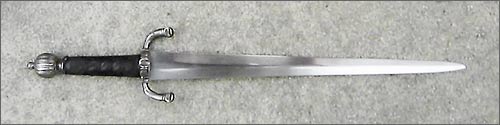

Handling Characteristics
Personally, I find the sword's compromise between cut and thrust tolerable. Balance slightly favors the hilt, as the pommel is large compared to the weight of the blade. True to its design this piece is not as good a cutter as my broad-bladed battle swords, or as suited to fence as my rapier. Additionally the characteristics exhibited by this piece are very light and fast considering the fact that it was manufactured almost a decade ago.
The dagger handles lightning quick and the extra few inches of blade allows the wielder to gain what might be a critical advantage of reach for parries or attacks of opportunity.
Fit and Finish
The sword blade is double-edged with no fullers and has a 1 3/4" ricasso. The hilt has sharply recurved quillions and has two side-rings. The spherical pommel is slightly ovoid and cast with vertical fluted ridges and a tang button. This pommel is similar to A.V.B. Norman's type 19. Grips are leather over a carved hardwood core. The hilt and side rings are cast and decorative fluting elements are integral to the quillions and rings. The "chiseled" fluting lends a simple dignity to the sword, and ties the piece in well to the companion dagger. The fittings are cast and show minor mold lines. This sword is not based on any cited historical example, but is a composite of a number of similar swords. Museum Replicas oftentimes placed aesthetics over documented research; overall, I'm satisfied with their results, regardless of the lack of documentation. This was one of the two founding pieces in my collection of replica historic arms and remains one of my personal favorites.
Construction of the dagger's grip is rather shoddy, with the handle's core being a brittle yellowish plastic, with grip contours filed out and leather wrapped. The plastic soon broke and was repaired by me a number of years ago with epoxy and super glue. A future project will replace the current handle core with hardwood and new leather. Aesthetically, though the ahistorical materials are undetectable and this is a very pleasing piece.
