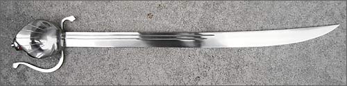

Although Windlass calls this a "Dutch" cutlass, they provide no real provenance for the piece replicated. This is par for the course for Windlass, unless they are recreating a very specific historical piece. However, if any weapon could be considered a good candidate for creating a "generic" replica, the simple shell-hilted cutlass is a great choice. Numerous historical examples abound of similar weapons from all over Europe. Wherever swords were used, a good bet is that some would be robust little hangers like this. Swords like these hacked through South American jungles and sailed through the icy North Sea. North African Pirates fought with weapons like these against men armed similarly. Close matches to this piece are known from Germany dating around 1600-1650. However, this weapon would not look out of place a century earlier or two centuries later.
Click to enlarge
Weight:2 pounds 2 ounces
Overall length:33 inches
Blade length:28 inches
Blade width:1.5 inches
Fullers:14.75" and 14" long
Shell:Clamshell approximately 5" long x 4" wide
Guard:Recurved quillions 5.5" wide x 5.5" long
Grip and pommel length:5.5 inches
Point of Balance:6.25 inches from guard
Center of Percussion:~20 inches from guard
Replica created by Windlass Steelcrafts of India.
Handling Characteristics
Weighing in at 2lb 2oz—much lighter than the quoted 2 and 10 from the catalog—the weapon is front-heavy but this is acceptable to me in a piece that is primarily a chopper. This blade is a real skull-splitter. While the point is nicely shaped for thrusting, the balance is much more suited for the cleaving and hacking press of a crowded deck or the rugby-scrum confusion at push of pike.
Fit and Finish
Overall the piece is finished to a high polish and has a lacquered wooden handle. The knuckle bow is simple and attractive with flattened acorn finials. The clamshell guard covers most of my hand adequately. From a design standpoint the clamshell is nicely made with graceful lines. Overall fit is tight with no loose components. The fullers are even and well defined. The threaded tang is solid, and the tang weld looks good. The shell is made of fairly heavy gauge steel. Some minor glitches were present, as I expect for swords in this price range. None were serious flaws in workmanship or materials. First, the cutlass' clamshell guard was too tight. I had to bend it out slightly to fit my hand. Next, the clamshell was lined with some really poorly mounted cheap suede. That's gone and will be replaced by some velvet or better quality leather. Third, the scabbard is cheap, as usual, but not noticeably so, until in your hands. There seems to be some "pleather" in use. Finally, the lacquered wooden handle is a bit slick, though attractive. It would need a wrap or sanding before I would want to do any serious sword swinging with sweaty palms.
Conclusion
Overall the Windlass Steelcrafts Dutch Cutlass is a decent sword, it feels tough enough to stand up to serious use. This piece had minor cosmetic and functional flaws that were easily rectified at home without any specialized knowledge, tools, or skills. This is another example of a bargain from Windlass that turned out to be a decent, simple, entry-level piece. Additionally, it represents a widely used family of weapons that seems to be fairly underrepresented in the replica market.
