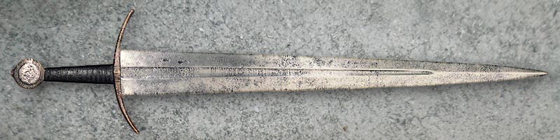

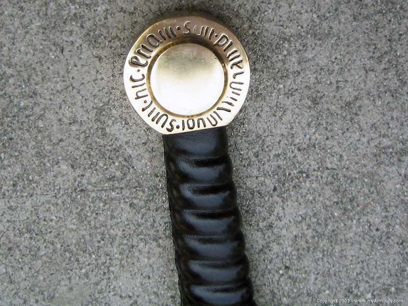

Of the last few Museum Replicas pieces that I have purchased lately, most seem to be generic designs or do not have any specific sword from which they are copied. This sword is an exception, and the piece that it is copied from is an interesting and noteworthy one. It is based on an Oakeshott Type XIV produced between 1350-1400. A photo of this sword is shown on page 46 of Swords and Hilt Weapons and is part of the Morosini Collection in the New York Metropolitan Museum of Art. The original is noteworthy for a number of reasons. Its guard is an unusual copper crosspiece wrapped with silver wire, leading museum curators to suspect that it was a bearing or presentation sword, rather than a war sword. The original's pommel has silver embellishments with a Latin inscription from Virgil's Æneid reading SVNT.HIC.ETIAM.SVA.PRÆMIA.LAVDI (here too, virtue has its due reward). An inscription on the blade, an early example of acid etching, is now unreadable.
Replica created by Windlass Steelcrafts of India.
Weight:2 pounds 6 ounces
Overall length:34 inches
Blade length:27.5 inches
Blade width:2.5
Guard width:8.75 inches
Grip and pommel length:6.25 inches
Point of Balance:4.25 inches from guard
Center of Percussion:~17.5 inches from guard
The original is cited as being western European, produced circa 1400.

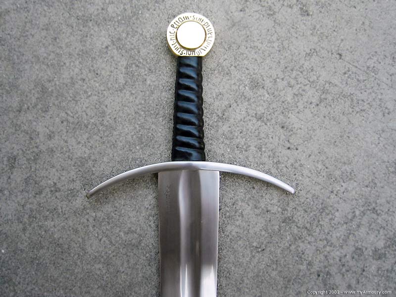

The Medieval Short Sword's point of balance sits relatively close to the guard and seems reasonably well balanced. This is probably related to the fairly large 2" dia. x 1" thick brass pommel acting as a counterweight. The sword itself handles swiftly, tracks and points well, in my opinion, with the wide blade and heavy pommel contributing to an overall solid feel. Profile taper on the blade produces an acute point suitable for thrusting as well as quickly allowing the blade to develop into a wide, effective cutter. The sword is also rather stiff and would allow strong, confident thrusts. The only real handling problem I can see is that the leather of the grip is very slippery and would need to be broken-in, replaced or roughened before I'd be fully confident of my grip. The name "short sword" is also somewhat of a misnomer, if anything this sword is well within the normal ranges of blade and handle length. Performing simple maneuvers with this sword shows me yet again, that heavy chopping blades like this one seem to reject light wrist cuts and prefer powerful arm and elbow cuts. The more power behind the stroke the better for this blade.
Fit and Finish

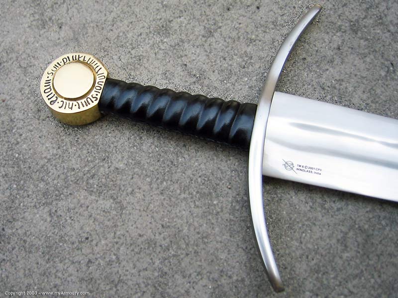

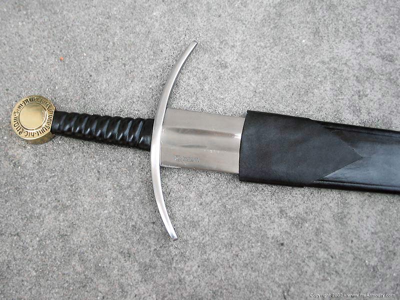

Considering this piece's bargain-basement price the fit and finish is more than adequate—very good actually. The fuller is slightly shallow and shows a bit of unevenness at the very end of its run near the hilt. The leather wrap is tight and I assume is cord over hardwood. The tang is peened and finished smoothly but not polished too well, the fact that it's a steel tang through a brass pommel may be a recipe for loosening if the sword was to be put to real use. All fittings are tight and polished smooth. Heat treat seems good with my non-scientific Bend-Spection™ showing the blade took no set. The only flaws in my opinion are the deeply etched, obviously modern makers mark and the too-slick leather grip (noted in handling characteristics, above). Additionally the guard seems to be ever so slightly lopsided, bent a tiny bit in favor of one of the quillions. The difference is so very slight as to render my mentioning of it more effort than it is worth, as I am sure all but the most modern pieces made by precision machining would evidence similar discrepancies. This bend seems to make no difference in performance or handling.
As a historical replica of a unique museum piece there are a few items that make this sword less than accurate. First, the pommel inscription is poorly done and nearly illegible. Next is the choice of a steel guard instead of the copper and silver wire of the original. Finally, the grip on the Morosini piece is a smooth, tight spiral wrap. The Museum Replicas sword is cord and a single piece of fitted and stitched leather. The original piece's fuller seems to be much sharper and is almost a flat-sided channel as it nears the hilt. Additionally, the original sword is a few inches longer than its Windlass counterfeit. All of these compromises are understandable on a inexpensively mass-produced item and do not detract from the utility or aesthetics of the sword. As a point of fact, the steel guard gives it more utility as a functional sword. However it is important to note that it is not an exact copy of the Morosini piece.
