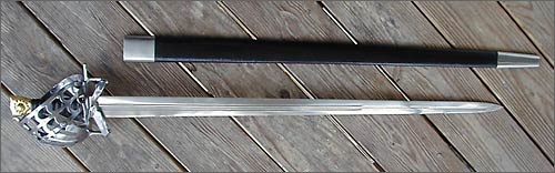

Introduction
Discussed here is a Renaissance styled sword known as a schiavona—a popular Italian basket-hilted broadsword. This sword was created for Museum Replicas Limited of Atlanta, Georgia by Windlass Steelcrafts, a manufacturing company located in India. There are many styles of schiavona with many different blade types, but characteristic to the style is the brass "cat's head" shaped pommel and the basket-hilt comprised of angular steel bars. This example has a wide blade suitable for shearing and chopping. The schiavona is most famous as being used by the Slavic mercenaries hired by the Doge of Venice, though the style was seen in use all throughout Europe.

Considering the work that goes into making a basket-hilt, this sword is very inexpensive. Museum Replicas has created a sword that certainly gives the impression of a schiavona, yet when seen in person, somehow misses the mark of a good reproduction. It is a very photogenic sword, as the pictures really do look nice, but in hand this is not quite the case. It should be noted that the size of this particular schiavona matches the size given by MRL, yet is over a quarter pound heavier than the listed weight of 2 lbs 12 oz.
Click to enlarge
Weight:3 pounds, 1 ounces
Overall length:30 1/4 inches
Blade length:33 1/2 inches
Blade width:1 3/4 inches tapering to 1 inch
Grip and pommel length:5 3/4 inches
Guard width:~7" inches
Point of Balance:5 3/4 inches from guard
Center of Percussion:~20 3/4 inches from guard
Replica created by Windlass Steelcrafts of India.
Purchase price: $235.00 US

The blade by itself is surprisingly well executed for a sword at this price range. The lines are clean, and the three narrow fullers are well finished, defined, and even. The blade has a high polish, coming close to a mirror polish. I was quite impressed with the blade by itself. Of course, like all Windlass swords, it has the infamous "Windlass, India" mark on it, though at least they put it on the ricasso where it is hard to see amidst the basket.
The sword is also very tightly assembled. The brass pommel isn't too bad looking, with only some minor bumps and dents near the end. The tang is peened through that. The peening is a bit uneven, and this is even more obvious on the contrasting brass pommel.
The rest of the sword is quite sub-par. Upon taking it out of the packaging, the guard screamed out at me as being far too large. I can easily fit both hands inside, and I have fairly large hands. It is not so large as to inhibit movement very much, as many oversized guards on cheap basket-hilts do, though in certain maneuvers my wrist will lightly touch it. The basket has many sharp corners that sometime brush against the hand (despite its oversized proportions), and this is irritating, though nothing a leather gauntlet didn't fix. The basket also looks plain cheap. This is to be expected with any basket-hilt of its price point, but this still came to me as a surprise considering that it actually somehow looked good in the catalog photo. It is easy to see that the basket is not of welded construction, but of sheet metal that had cutouts removed (though I'm willing to accept that particular corner-cut for the price).
The grip is a glossy black leather that has some sort of material underneath it to create the spiral cording effect. It doesn't feel like cord underneath, though. It actually feels like Styrofoam, though I do not know this for a fact. The grip is sewn with some very large noticeable stitches on the inside of the cage, though the stitching at least is very straight.
The scabbard is leather, and stitched up well, but the nickel (or perhaps stainless steel?) chape looks very cheap. The leather is also very glossy, which makes the whole scabbard look cheap as well.
