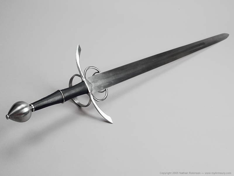

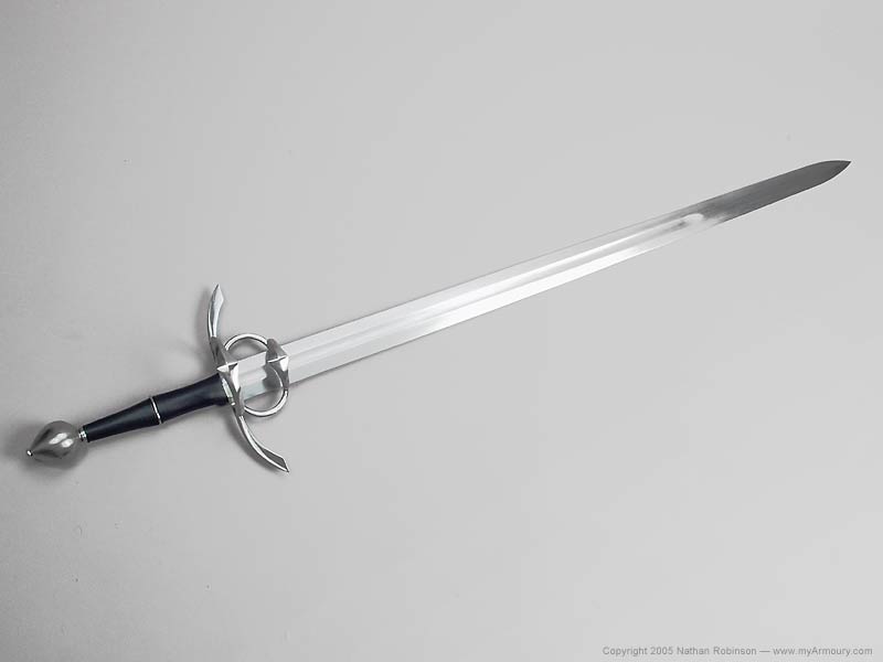

Erik Stevenson of Phoenix Metal Creations is a cutler who takes pre-made blades and creates historically inspired hilts for them. This particular bastard sword is built onto a blade by Angus "Gus" Trim based on an interpretation of an Oakeshott Type XIIIa. This type of blade, according to Ewart Oakeshott, generally has edges that run near parallel along most of its length which are broad, designed primarily for the cut. Oakeshott also mentions that this family of blade type is primarily German in origin, which may explain Erik's inspiration for marrying it to a Gothic hilt.
Click to enlarge
Weight:3 pounds, 9 ounces
Overall length:44 1/4 inches
Blade length:35 1/4 inches
Blade width:1 3/4 inches at base, tapering to 1 1/4 inch
Fuller length:25 inches
Grip length:6 1/2 inches
Guard width:9 inches
Point of Balance:4 inches from guard
Center of Percussion:~21 1/2 inches from guard
Oakeshott typology:Type XIIIa (variant) blade
Maker: Erik Stevenson, Phoenix Metal Creations of Colorado, using a blade by Angus Trim Swords

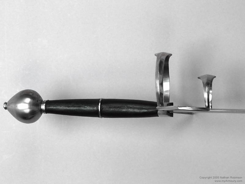

By definition, a bastard sword is supposed to handle well in either one or two hands, and this sword fulfills that role nicely. As a single-hander it is easily wielded despite its weight, which is barely noticed. It is even surprising just how maneuverable such a large sword can be in one hand thanks to proper balance. The long grip does slightly get in the way of some techniques, forcing the user to avoid the pommel hitting the forearm during some strikes. The sword's versatility, however, far outweighs this problem. Two-handed the sword is incredibly fast, and the grip is long enough to give good leverage in cuts.

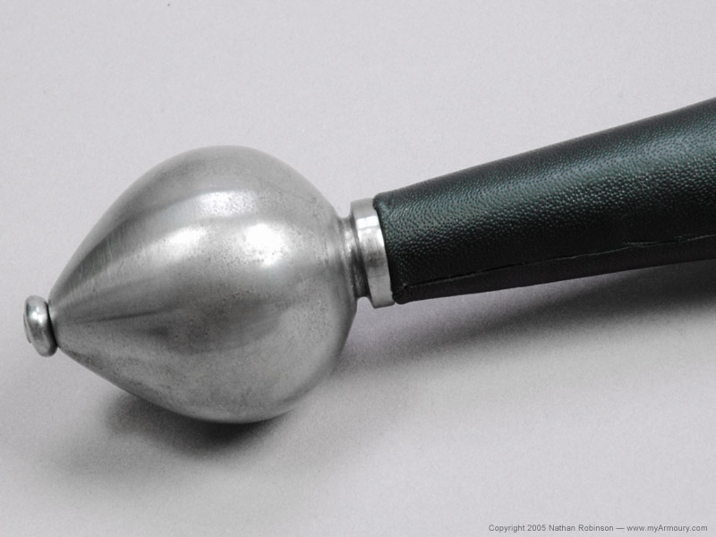

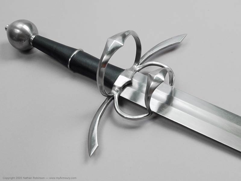

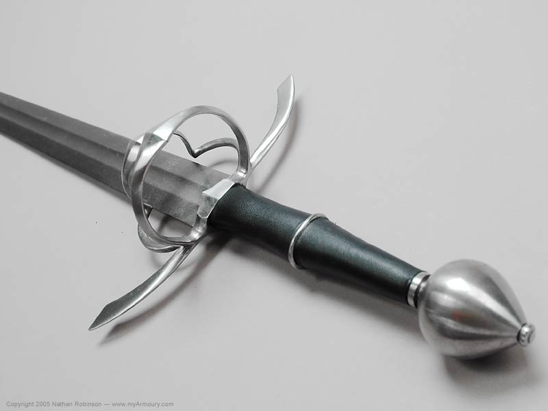

The Pommel

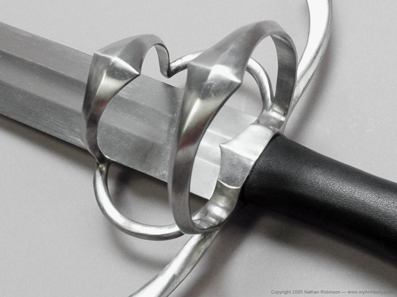

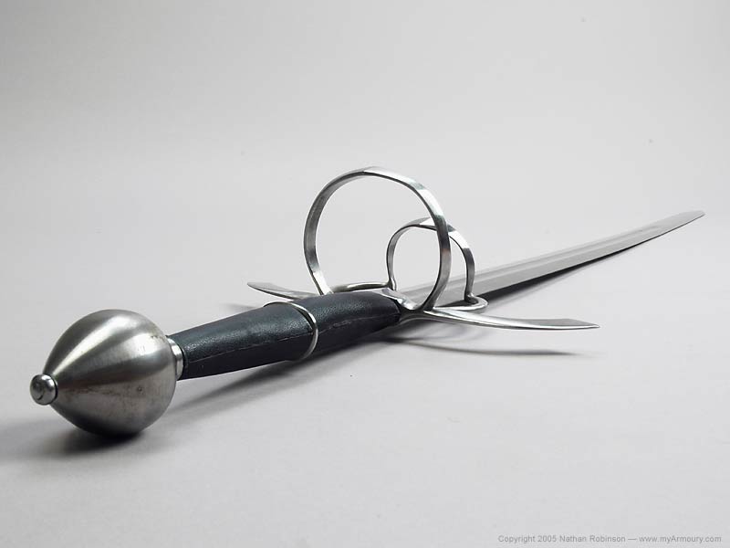

The rings of the hilt provide excellent hand protection from a sword blade glancing downwards. There are arms at the ricasso, which usually are used to protect the index finger should the user choose to wrap it around the blade over the cross guard, but in this case they appear to be more decorative than functional. There is not enough room between the arms and the blade to make this comfortable, and many swords that have this option generally have a ricasso that is narrower at that junction, or have a slight cut out for the finger; neither of which is present on this sword.
The blade is broad, giving very powerful blows, but has a fairly thin cross-section that allows for precise slices. Test cutting on various media from tatami to fruit proved this sword to be excellent against soft targets.

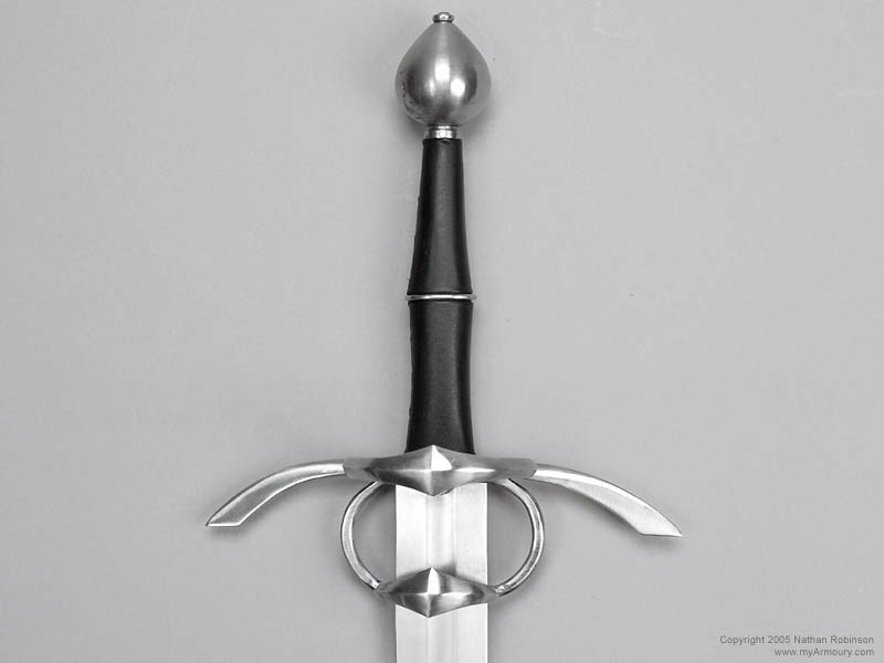

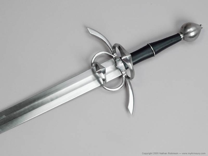

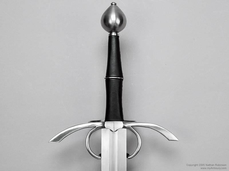

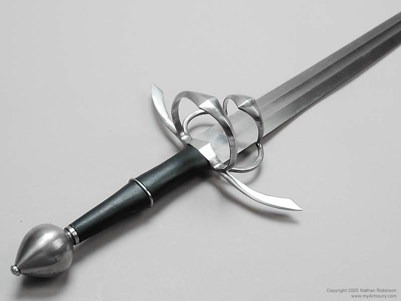

The Guard
Erik Stevenson is known for his incredible hilt work, and this piece is no let down. The precision with which he has sculpted the fine lines of the guard is immediately apparent, even before examining this up-close. The grip is separated into two sections by a steel spacer, and the leather wrap is evenly done. The blade was polished and reshaped by Erik, having a nicely polished finish with even lines and a well-executed single fuller.
The rings of the guard are the big seller for this hilt. While on first glance the sword looks plain, the rings are made with a triangular cross-section so that from the outside of the guard they appear diamond shaped. This is a very attractive way of turning a basic functional design into a very attractive one while not becoming ostentatious. It is a very handsome sword.
