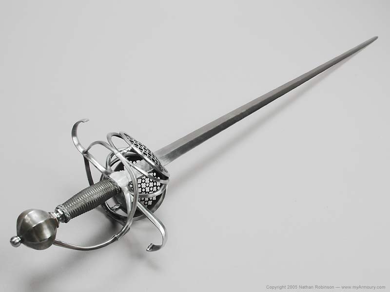

It the book The Rapier and Small-Sword: 1460-1820, author A.V.B. Norman developed a classification that traces the evolution of the rapier hilt. The sword being reviewed here falls into the category of hilt classified as 67, which is most notable for having the largest ring filled with a pierced convex plate to protect the hand. It is often referred to as a "Pappenheimer" by modern collectors because the type is thought to have been used by the cavalry of Gottfried Heinrich, Graf Pappenheim, the Imperial general of the Thirty Years War.
Erik Stevenson of Phoenix Metal Creations patterned this hilt after an original believed to be from Germany. It is built on a blade made by Angus "Gus" Trim.
Click to enlarge
Weight:2 pounds, 11 ounces
Overall length:46 1/4 inches
Blade length:37 3/4 inches
Ricasso length:2 inches
Blade width:1 inch at base
Grip length:3 inches
Guard width:7 inches
Point of Balance:3 1/4 inches from guard
Center of Percussion:~26 inches from guard

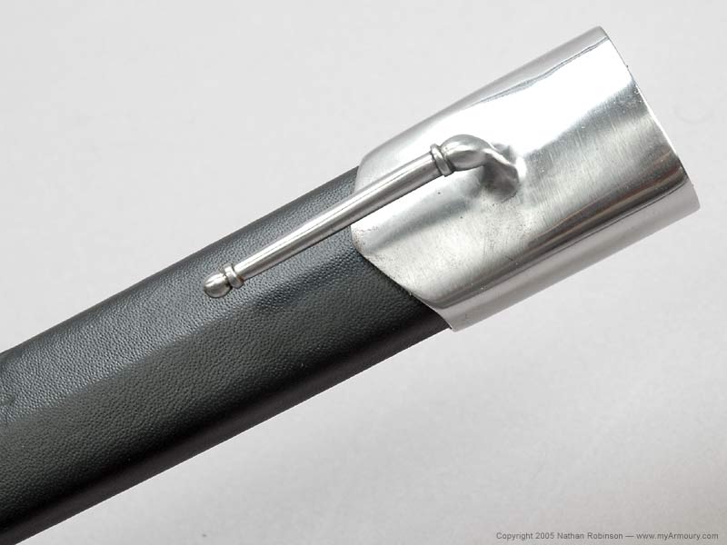

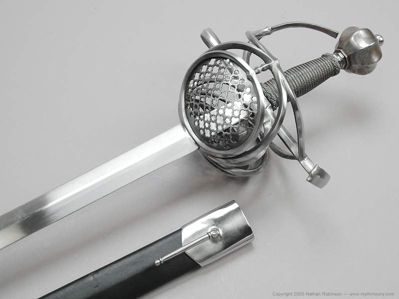

Scabbard Detail
Click to enlarge

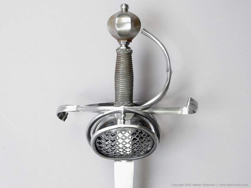

Grip Close-up
Click to enlarge

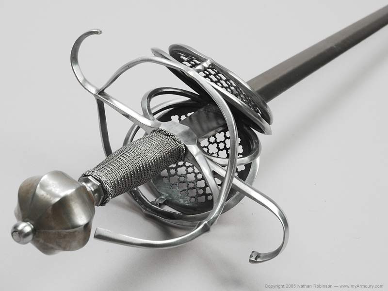

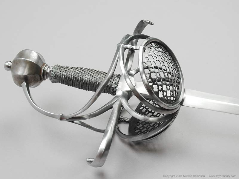

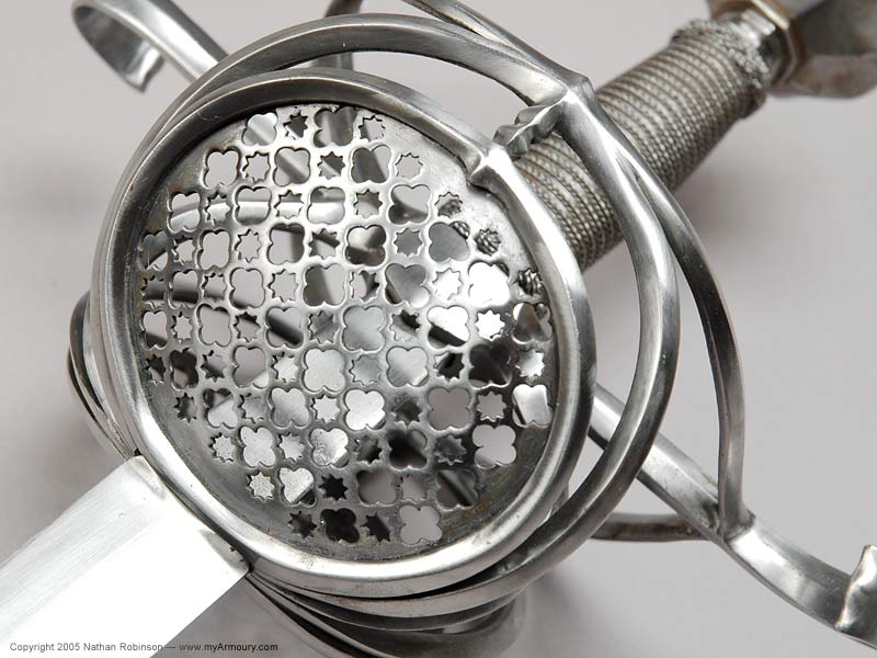

Pierced Plate

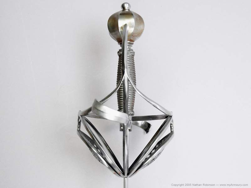

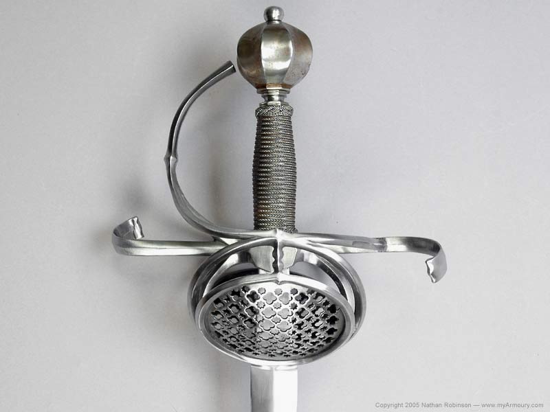

Fit and Finish

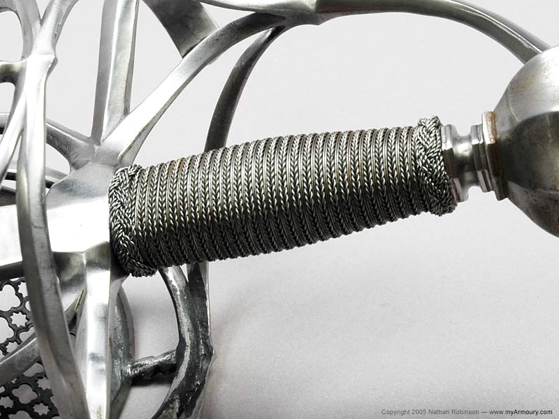

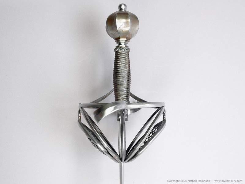

If I had to choose one word to describe the execution of this hilt, it would quite simply be, "Astounding!" The detailing done on this hilt is amazing, showing an incredible sense of aesthetics and function blending together. The cross sweeps beautifully into an s-shape, with a diamond cross-section, and the piercing of the plates is very clean. Many Pappenheimer-styled hilts are a bit heavy because of the extra metal on the guard, but this is not so in this case, as the plate is reasonably thin (though not so much as to weaken the guard). The perforations also aid in keeping the weight down.
The wire wrap alternates between twisted and straight wire, and is very tight and simply gorgeous. The pommel as well is elegantly formed. Erik's work is even more impressive in hand than his photos show, and that is certainly saying a lot.
