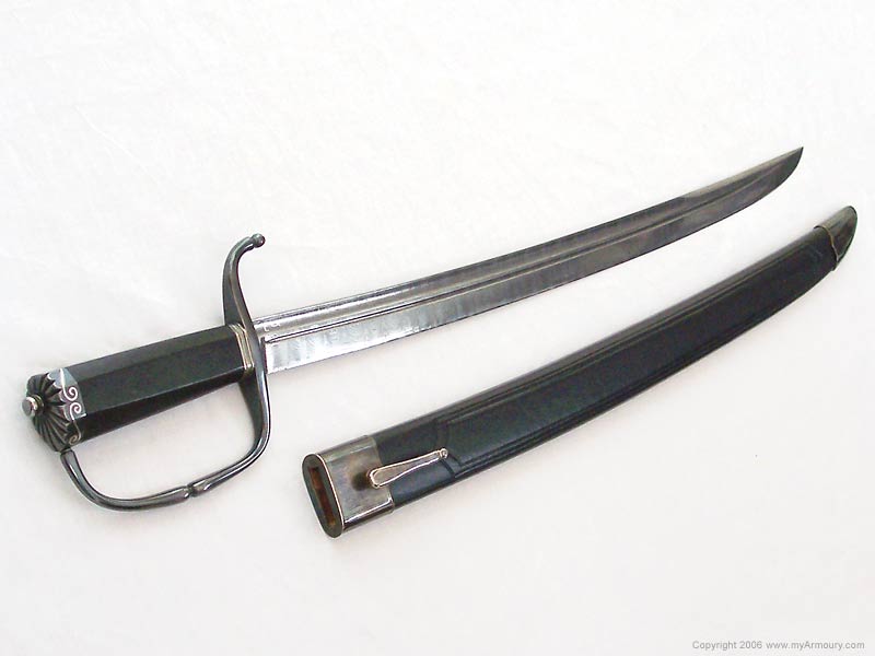

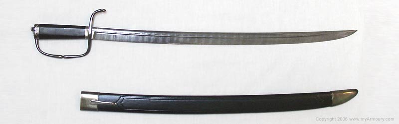

Click to enlarge

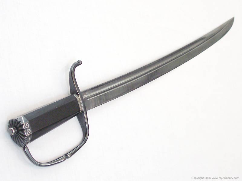

Weight:15 ounces
Overall length:26 7/8 inches
Blade length:21 7/16 inches
Blade width:1 inch at base, tapering to 3/4 inch
Grip length:3 7/8 inches
Guard width:4 inches
Point of Balance:4 inches from guard
Replica created by Vince Evans of Hawaii

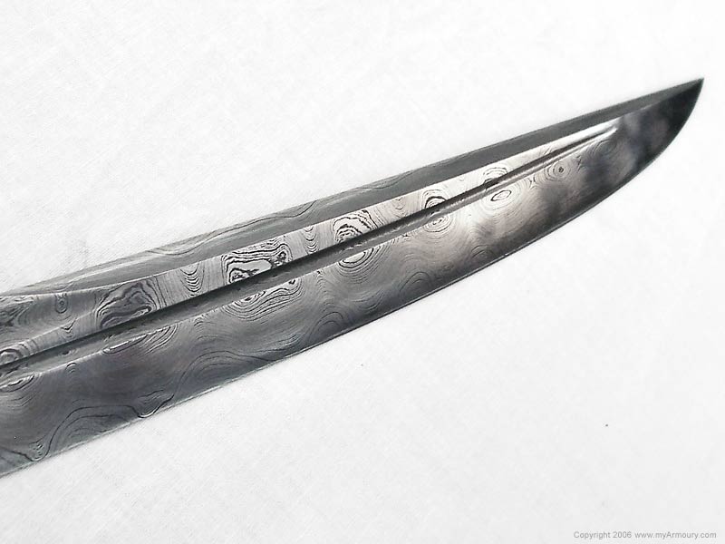

Blade Tip

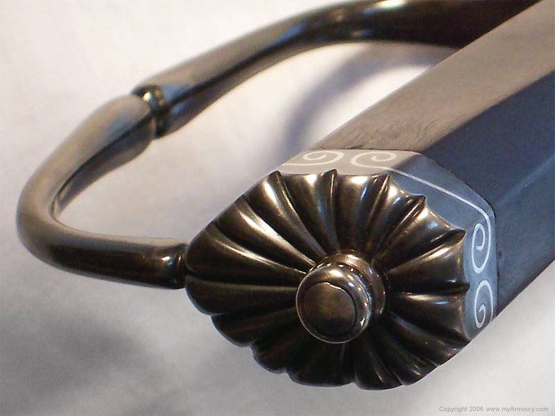

Pommel Cap

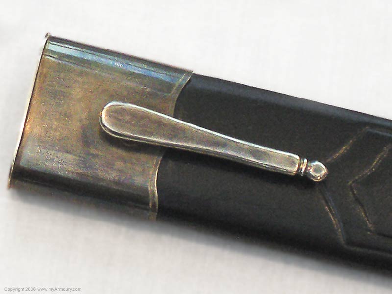

Scabbard Detail

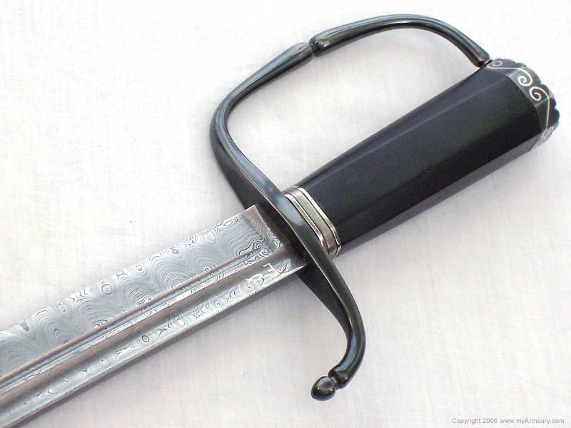

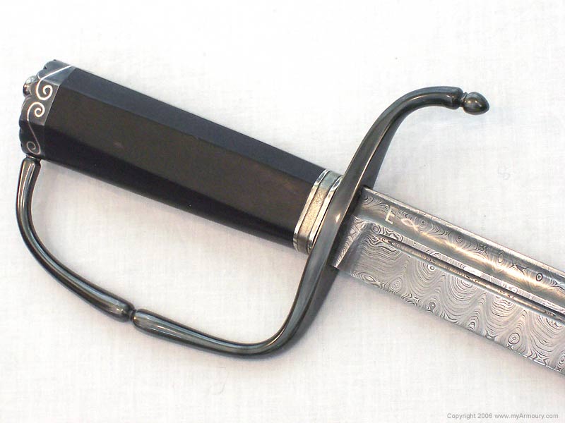

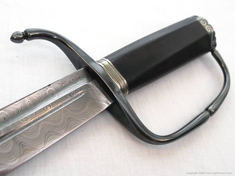

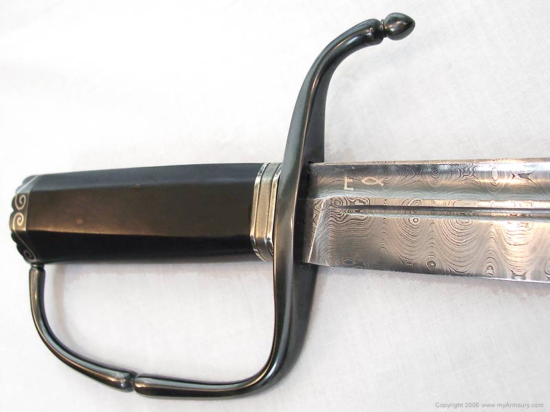

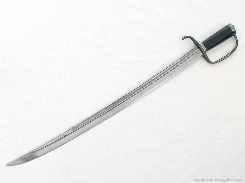

This sword is a fine example of a mid-18th century gentleman's hunting hanger (or, perhaps, cuttoe). The single-edged, slightly curved blade is pattern-welded with 512 layers of 1095 and A203 steels in a ladder pattern. The pattern welding is beautifully executed, showing no sign of any "cold shuts." Each side of the blade has two fullers. One fuller, closest to the back of the blade, is 5/16 inch wide and gradually tapers to 1/4 inch near the end of its 15 inch length. The second fuller is much narrower at 3/32 inch wide, but longer, running to within about 1-1/2 inches from the tip. The blade is also equipped with a sharpened false edge that runs back about 8 inches from the point. These details, common on period pieces, are very cleanly made: well-defined, parallel to the blade back and symmetrical from one side of the blade to the other.

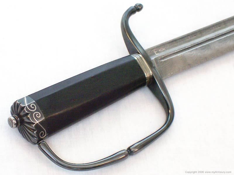

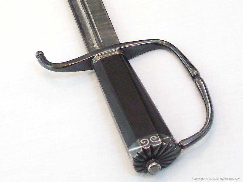

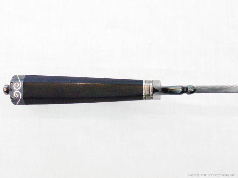

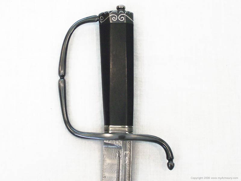

The quillon turns downward to terminate in a relatively large finial. The knuckle-bow has the form of a lobed "D-guard." Both forms are typical of mid-18th century style. The thickness of the grip tapers slightly from the pommel to the cross. This sort of taper in the grip profile seems to be typical of gentlemen's hangers from the 1st half of the 18th century. The grip has a seven-sided cross-section, rather than circular, and terminates at the guard with an antiqued nickel silver ferrule.
Vince had considered using ivory for the grip, since ivory was very commonly used in period hangers and cuttoes. However, the use of ivory would have carried a risk of confiscation by customs officials, since the sword would have to cross international frontiers at least twice. Instead, Vince made the grip from desert ironwood. Desert ironwood is native to the Sonora Desert, so it is not strictly historical for a piece like this. However, this wood seems an excellent substitute for ebony, which was used historically. The advantage of desert ironwood is that it is extremely stable with changes in humidity, and its grain makes it more resistant to cracking than ebony. Vince says that this was a key reason for his choice of the material, since the sword would be seeing some significant environmental shifts during its travels.
The end of the hilt is finished with a cap-type pommel, a form often seen on hunting style swords. In this case, the cap is blued steel, with a silver inlay. The top of the pommel has fluting that radiates out from the pommel nut, in a manner similar to that on the hilt of George Washington's hunting sword (#108.S in Neumann's Swords and Blades of the American Revolution). The fluting is very cleanly done and symmetrical, lining up perfectly with the corners of the grip. Finally, Vince assembled the hilt with a threaded and peened capstan nut. Vince says that he also secured the entire assembly with epoxy.
Vince provided the sword with a scabbard crafted from basswood and covered with a fine, black bookbinder's leather. He incised lines in the leather that follow the gentle curve of the scabbard and blade. Finally, the scabbard is finished with antiqued nickel silver fittings with typical period forms.
