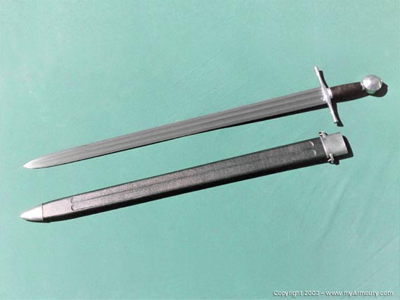

Weight:2 pounds, 15 ounces
Overall length:36 inches
Blade length:31 inches
Grip length:3 3/8 inches
Profile taper:2 inches tapering to 1 3/8 inches
Point of Balance:5 1/2 inches from guard
Center of Percussion:20 inches from guard
Oakeshott typology:Type X blade, Type I pommel, Style 2 guard
Replica created by Vince Evans of Hawaii

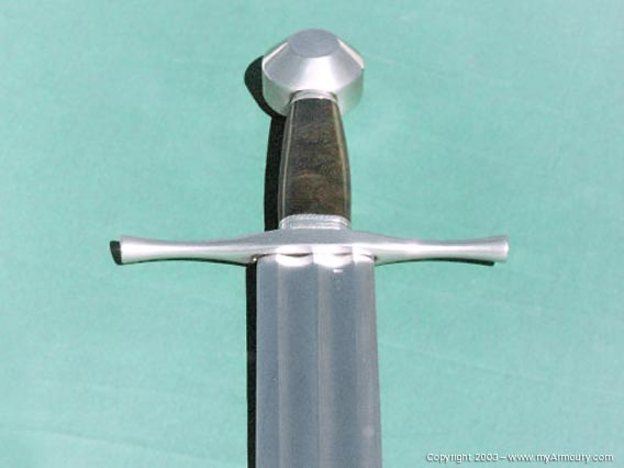

With a weight of just under three pounds Milestone can't be classified as a lightweight; however, this weight is close to that of the original and is in keeping with its intended purpose. This is not a sword designed for casual wear, or what is commonly termed as a "riding" sword. This sword is meant for military use, for shield splitting and hauberk cleaving. Milestone handles with a feeling of real authority and with just the right amount of what I like to call blade "presence". The sword tracks easily through both cutting and thrusting maneuvers. Taken as a whole I have never handled a sword that had such a solid feel of power and capability.
Fit and Finish

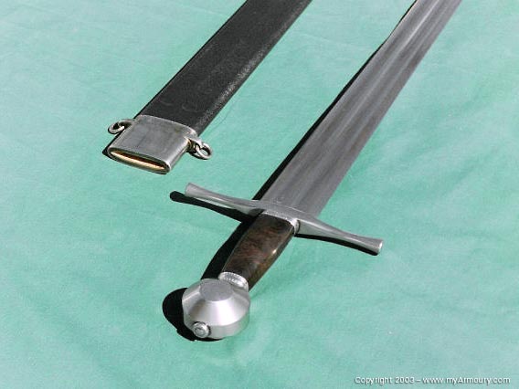

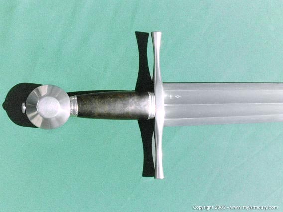

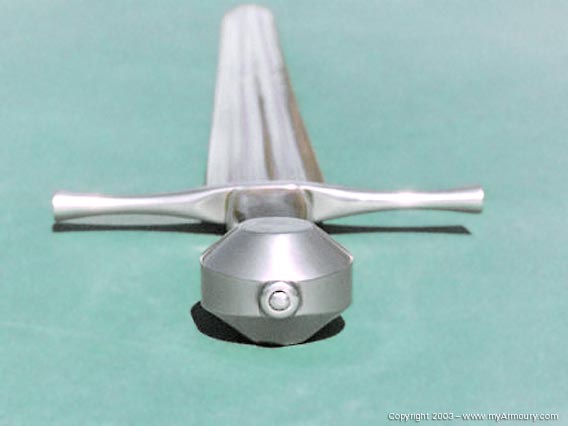

Well, what can I say except that the fit and finish of this piece are excellent, exactly what one would expect from a smith of this caliber. Both the blade and the steel furniture are finished not with a high gloss, or satin, finish but instead are finished to a very attractive burnished sheen. All edges are crisp and well defined and all flats are, well, flat. The grip is fashioned from burl walnut and mounted with nickel silver ferrules.
A quick word on the grip is in order here. When I originally placed the order I specified a leather-covered grip. While Vince was in the actual working process I suggested that the silver ferrules might be a nice feature. Vince stated that he doesn't do ferrules with leather grips and, in turn, suggested a grip made from wood. I've never cared for wood grips on my swords. They remind me of those cheap swords that are made in the Philippines. I voiced this concern to Vince and, believe me, he made the most of it. One shouldn't make this kind of statement to a smith of Vince's caliber and not expect to get a good dose of ribbing in return! In the end my fears were groundless. The grip turned out beautifully as did the rest of the sword.

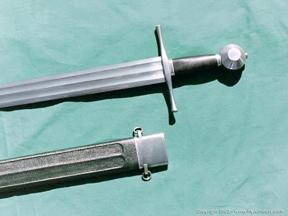

As the photos show this is not an elaborately ornate sword, however, it is a perfect example of the old adage "less is more". One only has to look at the proportion and facets of this piece to realize that it is the work of a master craftsman. There are many subtle details present in this recreation, as in the original, which photos cannot convey. The mechanical details of profile and distal taper, as well as fuller width and taper, all have to work in balance in order to achieve a sound and functional design. Considering this blade's double-fullered design this is not work for an amateur. Vince captured these aspects to perfection.
Conclusion
Not only is Vince a talented bladesmith he is also a pretty country fair scabbard maker as well. The sword's scabbard is fashioned from wood covered with Moroccan leather and finished with a nickel silver chape and locket. The front face of the scabbard is also routed out to match the blade's double-fullered appearance: a nice aesthetic touch.
Milestone and its scabbard make a fine ensemble that any medieval knight would have been proud to own. I know I am.
