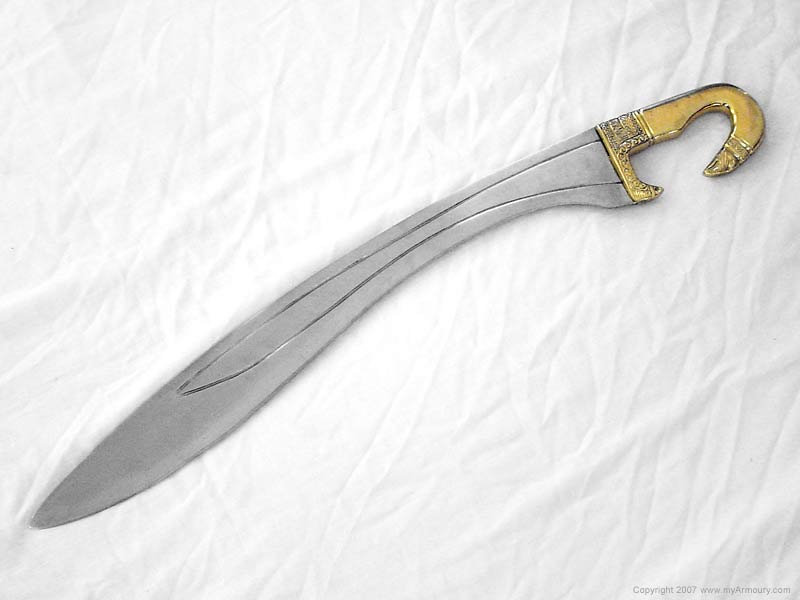

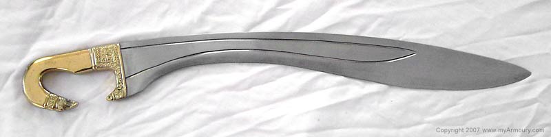

Weight:2 pounds, 14 ounces
Overall length:24 3/4 inches
Blade length:20 inches
Blade width:2 5/8 inches at base, tapering to 1 1/2 inches
Grip length:3 1/2 inches
Point of Balance:4 1/4 inches from guard
Replica created by Windlass Steelcrafts of India.

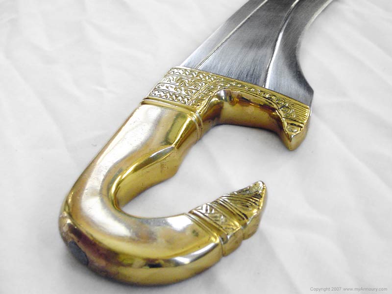

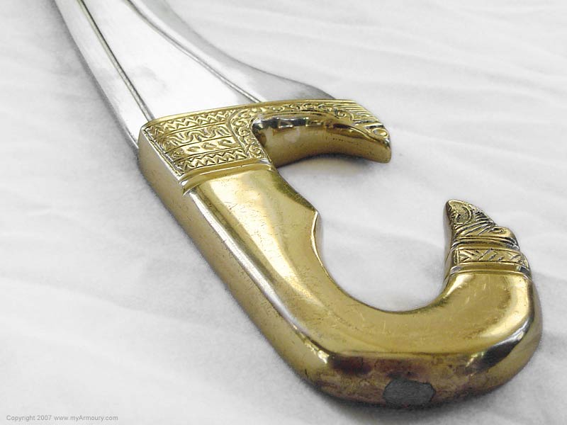

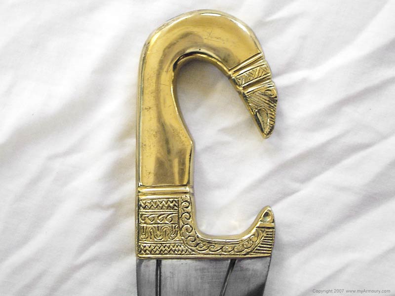

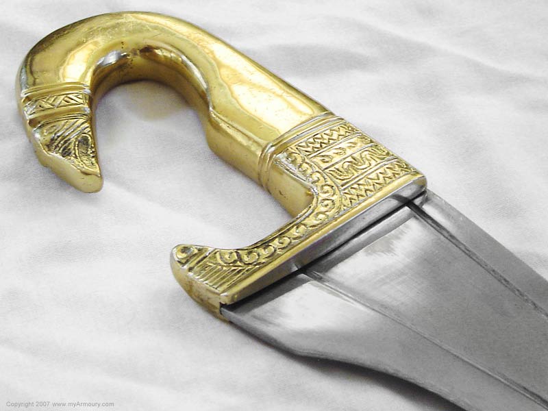

Click to enlarge
Hilt close-up
Click to enlarge

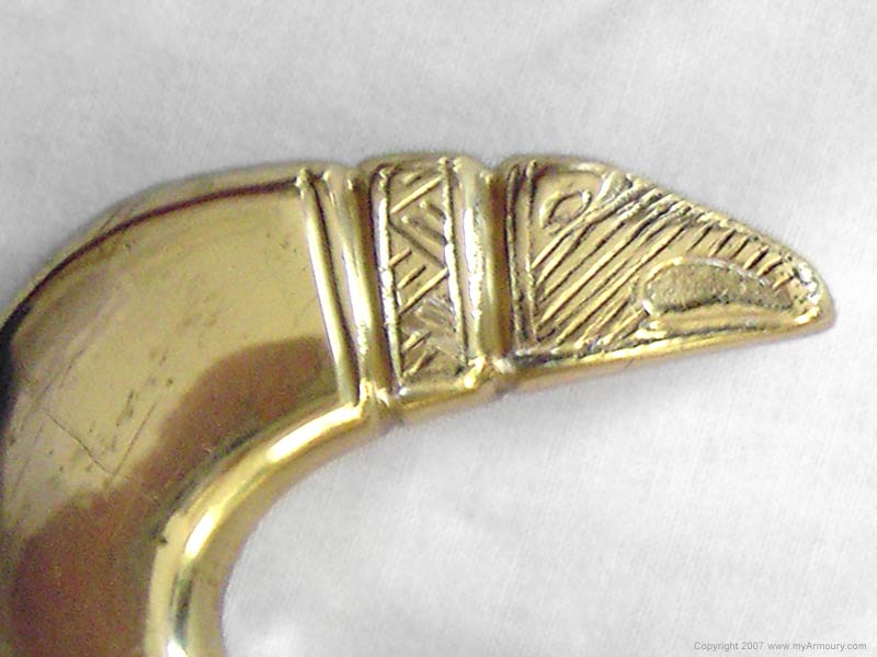

Bird's head

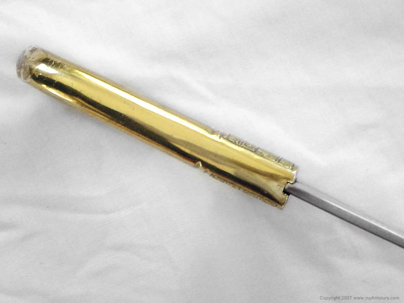

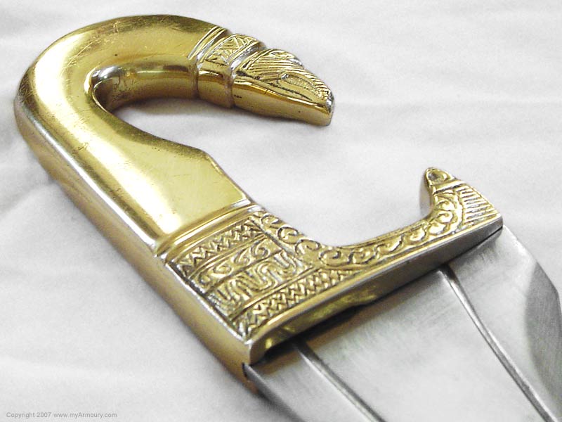

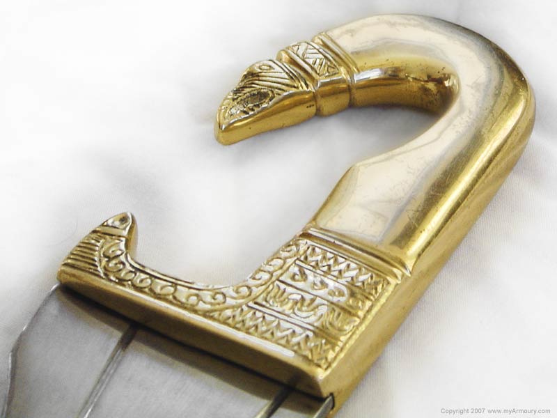

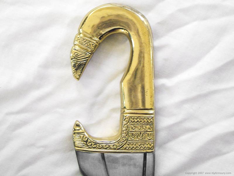

The construction of this piece is well done. The tang is peened securely at the end of the hilt where it begins to curve. Because the steel tang is peened to a brass hilt, there is an obvious difference in color, but that is just the nature of the materials used and is not something that can be helped. There is also an inlet in the guard where the base of the blade fits into the handle. Unlike most European swords, which feature inlets roughly the same shape as the blade profile, the falcata's inlet runs all the way across the handle from spine to edge. The inletting of the hilt shows a bit of excess space perhaps but is not bad overall.
The one thing that does concern me is a small metallic click, as though the tang were shifting inside the hilt as the sword is swung. There is, however, no visual evidence of any movement and everything has remained solid. It may not be an issue at all, but is worth noting.

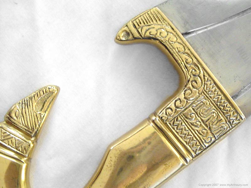

This could be a very decorative piece, but most of the designs on the hilt are poorly defined. The scroll work is of an uneven depth and many of the lines are rough and unrefined. Additionally, the design at the end of the grip looks, at least to me, less like a bird's head and more like a snake's head. These things are most likely a direct result of the fact that higher detail would require more hand finishing, which would in turn drive up the price of the piece. I would also have liked for the handle to have been made of bronze rather than the more modern brass.
While the blade of this piece arrived with only a coating of oil, the handle had received Windlass's infamous lacquer covering. This is done to protect the piece from oxidation, in the form of rust or tarnish, during shipment, but it can be difficult to clean off when the sword arrives. If the lacquer chips off, as it did on mine, it can result in a mottled appearance due to uneven tarnishing. This was fixed simply by cleaning off the lacquer and polishing the hilt, but it was a nuisance.
