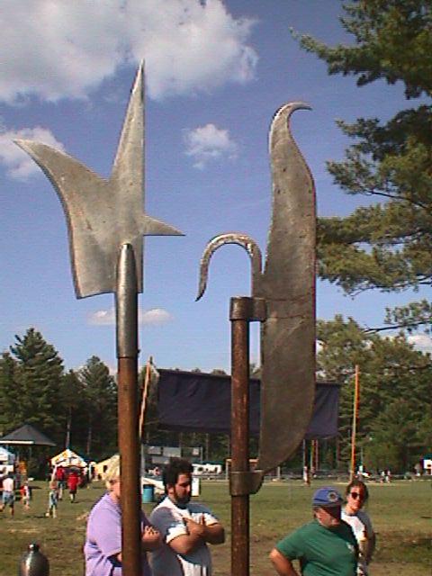

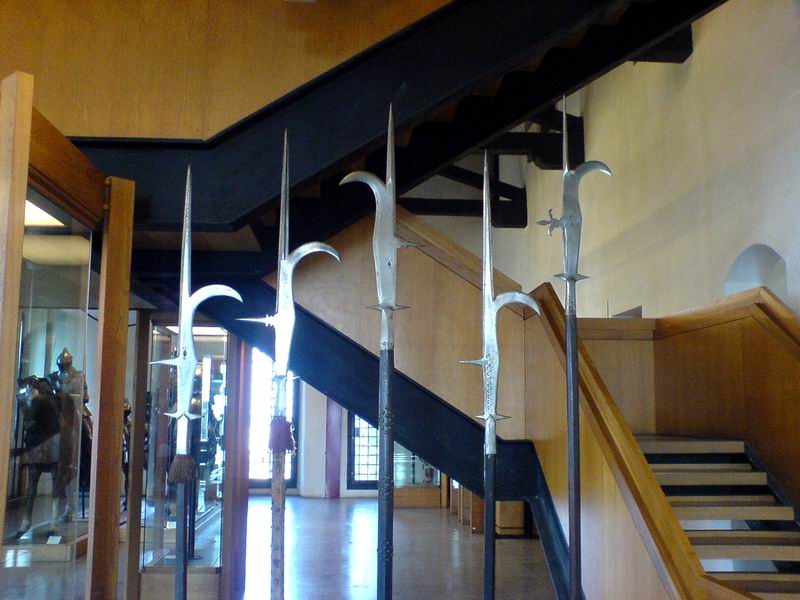

I'm not sure how well I can answer your questions, but I'll give it a go.
If I were to compare an English bill to an Italian one, I'd say the English is more halberd-like, with a more pronounced axe blade and sometimes less exaggerated bill. The Italian bill tends to be more spear-like with all the bill features.
And I wouldn't say English bills were crude, but perhaps compared to Italian bills they were not decorative or embellished.
The brown bill or forest bill was described by later writers as a militia or town guard weapon, made from poorer quality materials and often of simpler form (like missing a spear point or the like.).
I have two images to better show what I mean. They're not my photo's as they were taken from threads in this forum so all credit goes where it's due. Hope this helps.
regards.
 Attachment: 67.96 KB
An English bill (left)
 Attachment: 72.44 KB
Italian bills

Yes period is very important and so too is knowing cultural tastes. When I posted those images above I should had dated them also.
The weapon in the first image would probably be better described as an English military bill. It's the most popular form of bill in art depicting the English at war from the 15th century to the end of Henry VIII's days. Henry spent a lot of effort later in his life trying to "modernize" his army by adopting more guns, pikes, and halberds, basically adopting continental styles of fighting. Before then the common man fought mainly with bows and bills (mixed with other pole arms too).
The second batch of bills are from the second half of the 16th century, and probably represent the style used across many cultures at that period for its more artistic style. At this point it would be a bit difficult to distinguish one from another but like I said period is important. The Italians used a similar form for a while before, but I'm not sure how popular it was as a weapon of war. To them it may well had been another spear-like pole arm in their already vast repertoire.

The bill is most of the time called "ronca" or "roncone" in Italian. And in their "fully developed form" they are like those on the second picture posted by Nicholas.

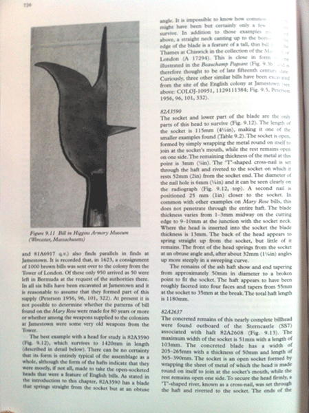

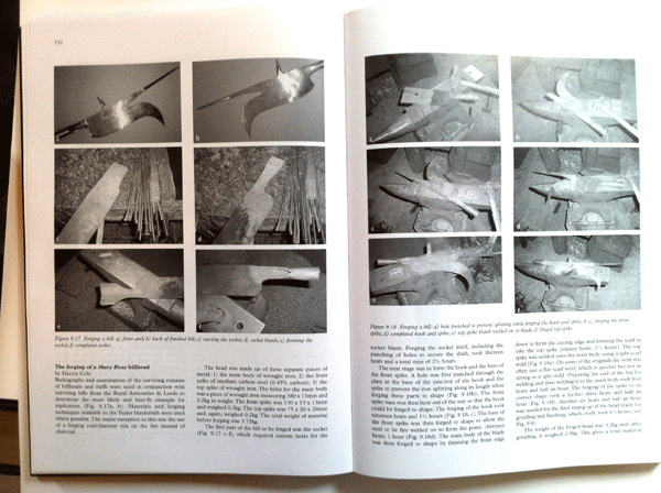

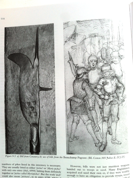

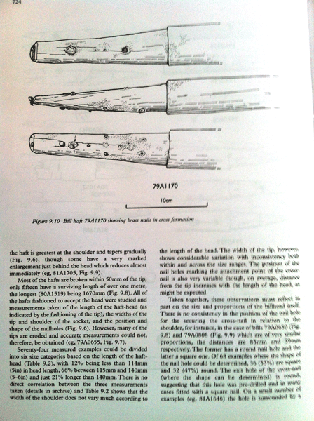

There's measurement info in some of these sample pages from Weapons of Warre. It's a vast collection of information.
 Attachment: 212.66 KB
 Attachment: 171.7 KB
 Attachment: 232.71 KB
 Attachment: 219.44 KB
