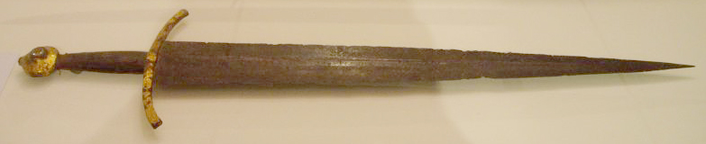

Hi there,
I have been interested in the XVIIIc variant for some time now and decided to have a blunt version for sparring made for me.
The example of this type I found most impressive was the one now displayed in the Metropolitan Museum in New York.
Now I gathered a sufficient amount of information about the general characteristics of the type and especially about the specimen from Leeds Castle.
In this thread Peter Johnsson kindly shares the specific measurements of the Leeds castle sword he took and later describes the Met-sword as being very similar but with a bit shorter blade.
Now when I look on the photos of both swords accessible here on this forum, I find the Met sword's blade looking a bit broader and more "massive". But I cannot validate this because I cannot find any measurements of the Met-sword.
If anyone here does have some measurements or other photos from the actual Met-sword to share, it would be much appreciated.
Ah, now that's the sword (the one in the middle) I am talking about. by the way:
Best regards and thanks in advance
J.D. Crawford

According to Clive Thomas's Park Lane article, A Distinctive Group of Swords from the Arsenal of Alexandria, the stats are as follows:
Overall Length: 111.125cm
Blade Length: 86.5 cm
Blade Width: 8.8cm
Blade Thickness. 5.5mm
Cross Width: 31.4 cm
Pommel type: 1 (Oakeshott's I)
Weight: 1665g (3lbs 11oz)
I hope this helps,
Dan

Dimensions for our Alexandria are:
Blade length: 880 mm
Blade width: 79 mm
Complete length: about 1110 mm
I cannot present data on final weight yet. These are rather hefty swords of large dimensions, but the balance is very sweet and agile.
The dimensions are pretty similar between PJ's concept and the Type XVIIIc you are looking at. Happy

I'm glad that you posted this one... I actually have a funny story about this. I found and downloaded this picture before, but couldn't remember where I had gotten it from. When I saw the Alexandria I thought that maybe the museum might (perhaps and maybe) be displaying one of Albion's beta swords... ha. I'm glad that you wrote this post before I gave in and asked.
Also, 8.8 cm at the base is quite broad. Wow. Even the two Albion XVIIIc's are not planned on being this broad.

PostPosted: Wed 07 Sep, 2011 2:34 pm    Post subject:         Reply with quote
Thanks a lot Chad! I'm looking forward to read it.
Eric, yes, it really is quite broad. That' one of the reasons why I like it so much.
The sword I ordered is finished now and I have recieved some fotos of it, here is one I like to share with you:
It's 1700g, my smith says. Quite light for a blunt version of this sword. Note that he changed the terminals of the crossguard after the picture was taken to the stile of the original (like the one on the draw of the Alexandria by Albion). It's on it's way now and when I have recieved it, I will share a foto or two of it's final form :-)

By the way, the sword has arrived now. I don't have much time to do good fotos just now, but here are some stats:
Blade width: 96mm (!)
Blade length: 86cm
Weight: 1790gr
PoB: 98 mm from crossguard
Center of Percussion 54 cm from crossguard
Grip length: 21,8 cm
