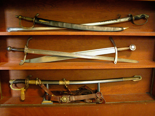

PostPosted: Thu 16 Dec, 2004 7:40 am    Post subject:         Reply with quote
I made the stand for the CSA sword and belt shown below in about an hour with two rectangular pine plaques from Hobby Lobby and a short piece of .25" x 3" poplar craft wood from Lowes. You just shape the top of a piece of the poplar and mount it vertically on the plaque (glue & nails or scews). Sand everything, of course. I used thin strips of chamois to line the part of the wood where the sword rests, but that could lead to rust (for those of you concerned about such matters Wink ). The poplar uprights are shaped like right triangles, with straight backs and a sloping front of approx 70 degrees. The sword rests are made separately so they can be precisely adjusted to suit the weapon. They look great painted and the little gutter around the edge of the plaque is perfect for contrasting color (in this case, the scheme is CSA gray with officer's gold accent). Very simple, very inexpensive and very effective.

PostPosted: Fri 17 Dec, 2004 7:25 am    Post subject:         Reply with quote
For what it's worth, here's the design for my poplar sword stand
