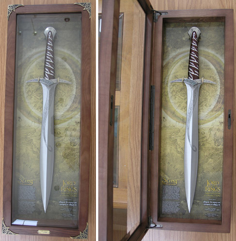

I would like to do something like Aaron's #3 suggestion, which I believe is something like the display cases United Cutlery has with their new LOTR Museum Collection swords. (pics of MC Sting below)
I would like to get a custom one like that made for my Jody Samson sword, and to have a separate such case for any new high-end swords I get in the future. Need lots of wall space, though...

Glen-
Thanks for posting the picture. Yes, that is exactly what I had in mind for the #3 option - right down to the side-mounted lock, and another touch I hadn't considered in the motion-limiting slides in the corners. This would work nicely for a single or perhaps a double case, but I am still concerned about making a case that is much wider than, say, 2 feet with a door that opens that way. My concern is that it would create too much of a lever when opened and tip, twist, or rip it off of the wall. At this point, I am thinking about making one like this in pine just to see how it will work. I have a few options for the joinery. I'm leaning toward the rabbet or the splined miter (as seen here: http://www.diyonline.com/servlet/GIB_BaseT/di...docid=1242) or a variation (?) of the splined miter where a couple of biscuits are placed in a slot cut across the sides of the mitre, glued, and shaped to match.
Now... to find those fittings... especially that lock! The Vinland needs a new home!

The United Cutlery case that Glen posted has a nice idea – including some type of text description of the sword. I like the hinges and appearance of the lock in that case, but I am unclear on how it works – can’t see a keyhole.
I think it's just a hole in the side of the case. The lock grabs the lid / door and pulls it in. Same type of lock used in jewelry boxes and roll-top desks. The middle hinge is easy to find, but I am having no luck finding the ones in the corners with the slide.

Lucite is used, as is seen in the Sword of Charlemagne pic below, and does provide a solid and accessible display that's off the wall and off the shelf. I've also seen wire or fishing line used, suspending pieces from the ceiling. Problem with these is it's a much less user-friendly route - pain in the butt to take out and put back on a whim.
problem with it for me is that I play with my collection too much to isolate it so much.
I agree that I want to have easy access to my collection
Me three. I'm really liking my options #1 & #3, and want to pursue them once I actually have the pieces in hand to do so. I may play with a prototype shadowbox in pine, as it's significantly cheaper. If it turns out to be presentable, then I will keep it. If not, then I will have worked out the bugs and can make a good one in hardwoods, stripping the fittings off of the pine one.
I built a custom rack for 7 swords and 6 spears at once
Looks great. I love it for the polearms (another facet of the collection I have yet to take the plunge on). How does it work, though, for the swords? My serious concern is that it would harm the points by having them repeatedly stuck down into the base. Perhaps not so much for the shorter, wider blades, but for some of the longswords with a narrower, more needle-like point, the thought gives me gas.
