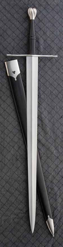

Here is a scan from the catalog...
I agree, very nice proportions!
Just wish that Windlass could use a little thicker stock. 3/16 seems a little thin in the forte... especially for a hollow grind.

Thanks for posting the pic, Kirk! I was waiting to grab the image from the MRL site but they still haven't put it up. Confused
There's no telling about the thickness, unfortunately. I just bought two Windlass knife blades, both described as being 1/8" thick. One is 1/4" with a nice distal taper down to 1/8" and the other is 1/8" its entire length and feels like a kitchen knife blade.
We just need for somebody to buy one of these and get some specs. Big Grin

Wow! I was truly surprised when I scrolled down to the picture, that is indeed a beautiful sword and I agree with Sean, that is perhaps the best Windlass that "I" have ever seen, in fact on second thought, this is the best Windlass sword that I have ever seen!

The Windlass version is not a bad likeness. Is it just me, or is the blade hollow-ground? I own an A&A Schloss, though Craig & company have slightly tweaked their model since my purchase ($465 new, July of 2000). It is still the most sublime reproduction sword I've ever handled - and I've handled newer high-end pieces from other makers that cost twice as much or more. Every time I handle a sword at a Renfaire or someone's house or whatever, I find myself comparing it to my Schloss Erbach. It truly sets a standard.
I'm eager to check out the Windlass version sometime. Has anybody bagged one yet? Thoughts?
PostPosted: Mon 03 Dec, 2007 5:01 pm    Post subject:         Reply with quote
It's not just you. The catalogue page scanned in above says "the blade is lightly hollow-ground." Happy

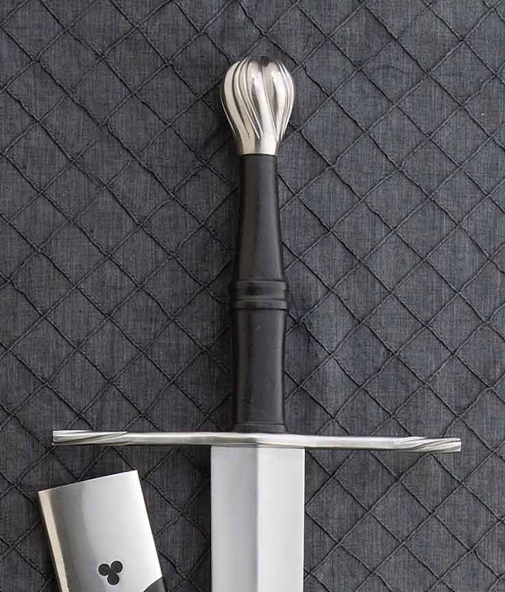

PostPosted: Tue 18 Dec, 2007 1:16 pm    Post subject:         Reply with quote
MRL has posted better photos (see attached). I might take .25" off the base of the pommel, narrow the base and extend the filing, among other things.
